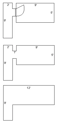

I understand and believe your point, placing absorption panels on the back wall spaced apart does the same thing, but if there is a door that opens/an opening into another room, then doesn't that effectively add both together to make it like one big room? For example, my drum booth and vocal booth corridor. With the door open, it's effectively like a 12'x9' room with a big 10'x4' chunk out of it, and 2 1'x1' pillars.

Yeah, that's why i said don't look at my drawing recommendation. :D
Can they all have a QRD diffusion affect because of the omnidirectionality of bass? Isn't Rick's point also valid in that the second room/cupboard becomes a resonance chamber? I'll use my drum booth example again to explain. Obviously this is hugely simplistic, and bass travels omnidirectionally, but i couldn't draw the omnidirectional waves very well, especially reflecting.

With Ethan's QRD thing, it just makes the depth much larger, and therefore the effectiveness to much deeper frequencies. I suspect it's the same with Rick's, and with mine it makes it effectively one even larger room, changing the room response, modes, etc. I suspect the affect it has is all three. It's cerutainly not just QRD, because you can hear a complete change in reverb and room response(i noticed a huge change when i installed doors in the studio). It sound like a much bigger room with the open door/without a door.
