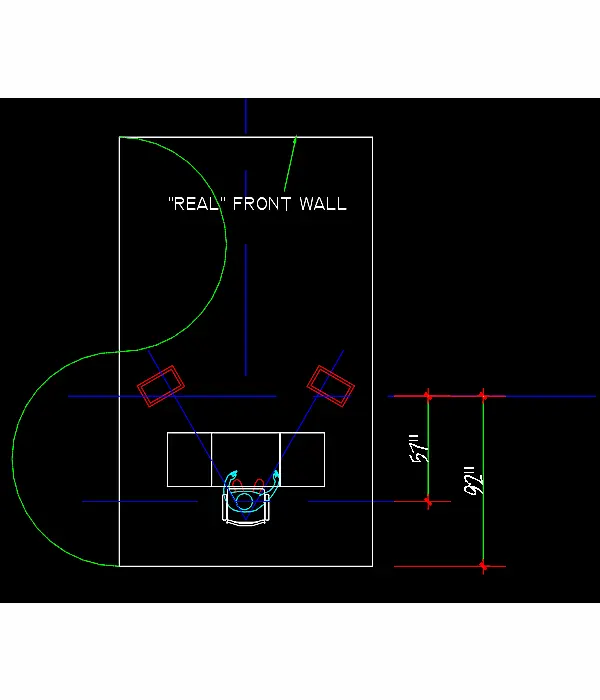

OOPS, I put the monitors 7'8" from the REAL front wall:o Sorry. No time to change it right now. I'll be back later. If intuition serves me, your monitors will be almost at the half wavelength point. Not good. In fact....terrible position.

Hmmm, I HAD to take the time to correct "my" interpretation of your description. Just to show what is taking place. I believe.

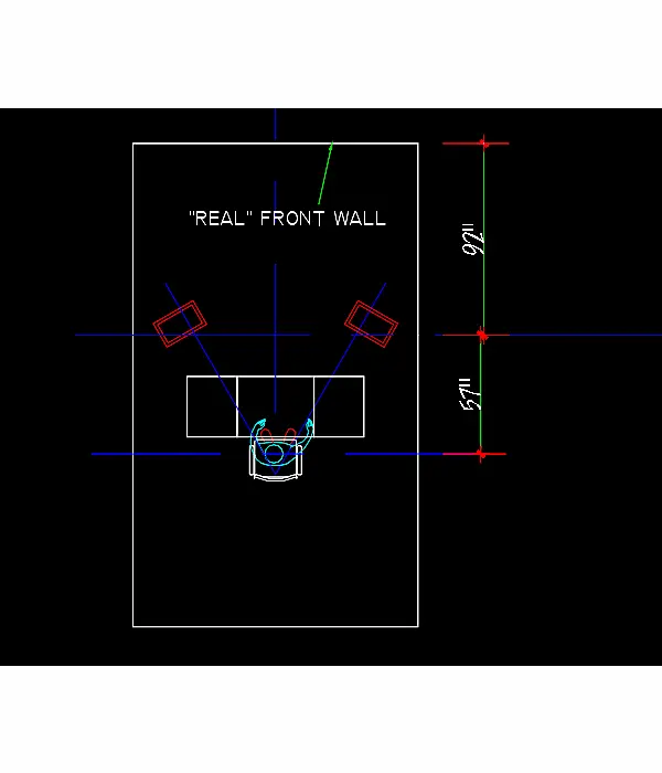

Sorry for taking so long to cobble this up...
it is very rough and not to scale. But it gives you an idea.
Why dont you turn around your console facing the window with the absorver above, and center it as well. Then move your keys and hammond to the to the other side of the room or off to the sides. This way youll be shooting down your soundwaves in the long direction of the room in a symetric manner. Then build some corner bass traps.

For one thing, I was told that placing monitors with rear-firing bass ports up against a wall was a bad idea. Then there is the console issue. Placing the back of it against the wall would make it almost impossible to change connections on the back of it. It is too deep to just reach across to the back from the front and it takes four people to move it. There is the possibility of going under it to reach the back connections but then I'll need to relocate the 3 large racks of gear that live down there. If I relocated those racks up against the front wall then I have the same problem of not being able to reach the back connections.
Then there is the door on the right side, which is the main entrance to the room. Putting the console and racks on the front wall would partially block that doorway. This is a big problem.

Not only are your monitors near that halfway node, but if you check their distance from the front wall (7'8"), it's almost the same as the height dimension of the space(7'10"--- I'm no accoustics expert, but when things line up like that, you definitely add to the peaks and nulls.
Getting your rear ports a little closer to the wall won't really change much-- once they're a few inches or a foot away, that's probably where issues will develop, right?
Deadening the room completely and adding ambiance digitally or through outboard gear would be one solution, if rearrangement is truly impossible. You seem to have no bass trapping-- just some first reflection stuff. A ton of 703 in the corners and a cloud would be my first steps.

This still leaves the problem of blocking the main door into the room. That console is 6'3" X 2' 10". It will need at a minimum 6" between it's rear panel and the wall for cable/snake clearance. That puts it roughly 3" into the doorway unless I move it further to the left side than it is already.

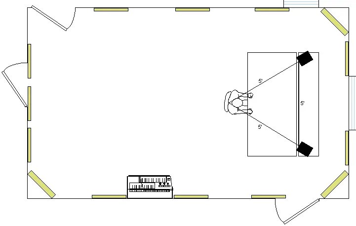

This is what I'd do(It's roughly to scale). Just place the rest of the stuff where you want. I'd install more bass traps, including wall-ceiling corners.

Holy Cow! That back door in the room leads to an 8' X 5' storage/laundry room. When I open that door I notice a remarkable improvement in the bass response at my listening position. And when I stand on my chair I don't hear that bass buildup near the ceiling anymore.
Maybe I have found the simplest solution yet!
