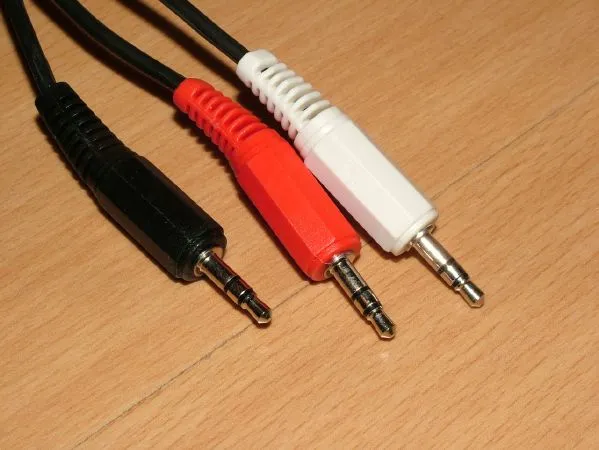

Aux
Hi There
This is the cable I am using from Aux send to Virtualizer Pro inputs. I am using a double ended Y Cable for the return feed.
Bye.
How are you using an 1/8 stereo splitter cable to go from a 1/4 output to the mixer to the 1/4 input of the effects unit?
Assuming the output is balanced, a 1/4 version of this will work. There might just be a setting the the effects unit that changes it from dual mono to single input.
