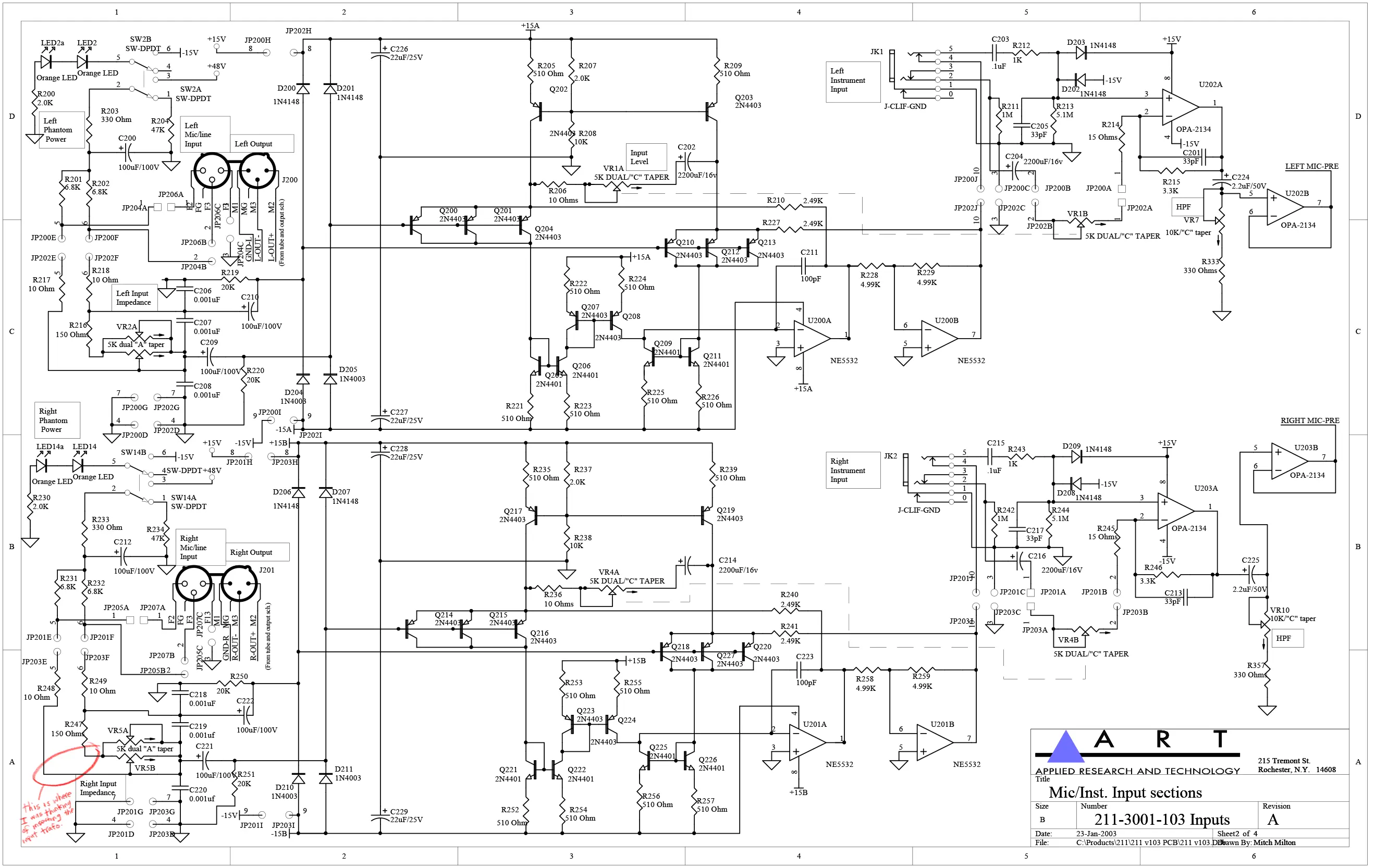

Hi Guys!
I have got ART PRO MPA 2 preamp and XLR input on channel 1 is not working, the DI (HiZ) of the same channel is working, chanel 2 is ok, I have attached a schematic from the similar thread... I am not sure where I shall look for the issue, I can't read the schematic, is there any chance you can point me out where I shall look for?
Thanks!
See if the place where you found the schematic has the other 3 pages as this is 2 of 4.
Then we'll see if we can point in a direction?

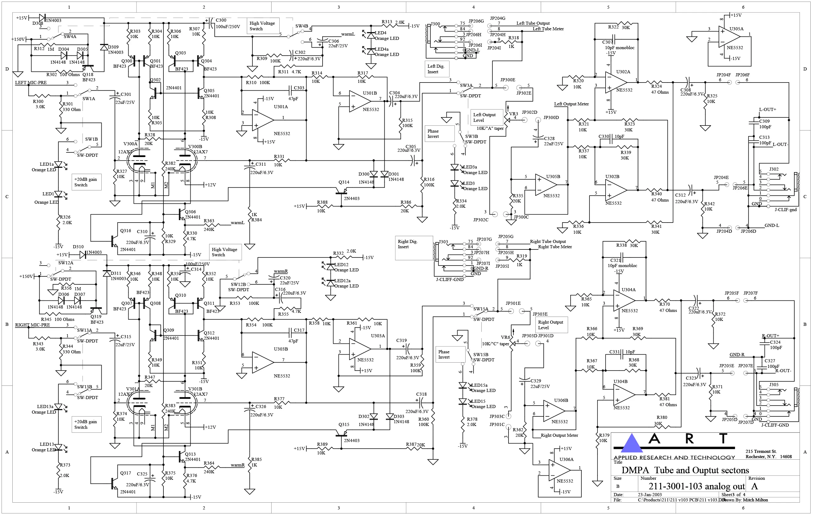

Here is another one I've managed to find:

Here's what I have on the ART MPA. It is listed as the Gold version, so I don't know how similar or different it is from the standard DMPA II.
One thing you should consider is whether any differences between the two versions are significant to your service questions.... it's kind of hard to do without having complete schematics for the model in question.
Starliner
If this is the correct diagram, you have two identical circuits, one for the right input, one for the left. The balanced input also has the phantom supply. Are you using the phantom power when trying the "dead" channel? The 48 volts for this will be the same supply for each half but it does have to go through Switch 14 (if it is the dead side). Does the channel work with a dynamic mic? (not requiring phantom power)
The reverse biased small signal diode pairs d206 and d207 and the other set d210 and d211 keep the input signal balance in between circuit's power supply +- 15 v . If you have a digital volt meter (you don't need a scope) you can verify the DC voltage drops across these (not breaking down) and since the other channel is working get can check against it.
WARNING ***** The tube section will have a high voltage power supply ****** If you don't know what you are doing, read no further and take it to a electronics bench technician or buy a replacement *******
If you are familiar enough with your digital multimeter, you can power down and check each the transistors (2n4401 and 2n4403) conductance. Base to emitter forward baised, base to emitter reverse bias (blocking), no shorts across any pair. Again since the other side is working you can compare to it even with the transistors "in the circuit."
Let us know your capabilities with a multimeter?
If it's nill, seek out a local bench technician that can perform these basic checks.
The individual parts are relatively cheap, the tech time will be much higher but an experienced tech will identify the issue quickly and swap out parts quickly.
I'm only guessing here by the traditional parts and design without seeing it that they aren't using SMT (surface mounting) so part replacement should be easy.
Cheers,
Tom
Thanks Tom, guys and girls for the help!
You have mentioned the following diods:
"d206 and d207 and the other set d210 and d211...." I found them on the channel 2, the schematics corresponds to the right input and output... so in my case I should be testing: D204 D205 and D200 D201 located on the broken Chanel 1?
I did not get you with the transistors spec., there are sevral instances of the 2n4401 and 2n4403 transistors which corresponds to the different Q200, Q201... etc.. (again, I am talking about Chanel 1 - the left I/O).
I do not have a condenser mic, I own a dynamic one - SM57, the XLR input 1 is not working with it. I do not know how to use a multimeter, but I have one with me. I am planning to buy diods which corresponds to the ones I have mentioned above. My plan is to replace them - one by one and see if it does the trick. Do you think it will work that way? I could do the same with transistors...

Ques 1 ;"You have mentioned the following diods:
"d206 and d207 and the other set d210 and d211...." I found them on the channel 2, the schematics corresponds to the right input and output... so in my case I should be testing: D204 D205 and D200 D201 located on the broken Chanel 1?'
Answ 1; If channel is what they call the left, then yes.
Ques 2; "I did not get you with the transistors spec., there are sevral instances of the 2n4401 and 2n4403 transistors which corresponds to the different Q200, Q201... etc.. (again, I am talking about Chanel 1 - the left I/O)."
Answ 2; Q200 to Q213 are all associated with that channel. Any one of those could be failed?
Ques 3; "I do not have a condenser mic, I own a dynamic one - SM57, the XLR input 1 is not working with it. I do not know how to use a multimeter, but I have one with me. I am planning to buy diods which corresponds to the ones I have mentioned above. My plan is to replace them - one by one and see if it does the trick. Do you think it will work that way? I could do the same with transistors..."
Answ 3; If you are planning on what I used to call "shotgunning it" by replacing all the active components in that channel then have a lot of diodes, transistor and an op amp (U200) to replace. You'll have to look at it and read it's part number.
Ques 4 ; "Do you think it will work that way?"
Answ 5; That is most likely totally dependant on you soldering skills.
You have to be able to de-solder the old ones without destroying the surround PCB foil, then solder in the new ones without cooking them.
It would be a lot more practical to find someone who can show you how to use your multimeter to isolate the problem component.
Cheers,
Tom eh
