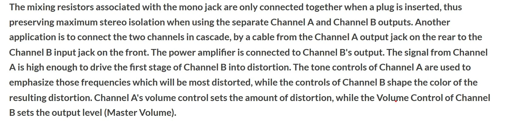

Last night I was looking at a way to make differences in the Preamp recordings.
I came across Cascading the input channels. I was going to try this too. Running through the preamp twice. Input channel 1 , output ch1, goes to input channel 2. That should make the preamp differences more noticeable.
These ideas might seem stupid to you, but you never really know till you try.
That sounds like they are talking about guitar preamps, that's a pretty common practice. However, this thread is about Mic preamps, a completely different animal.

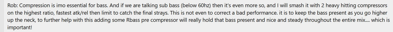

Could it be like EZjammer said in the tips thread, and hit it with 3 compressors cascaded in series?
If they are doing this kind of thing all bets are off..

Cascading multiple compressors is pretty common practice when something really needs to be smoothed out. Usually they aren't all set to infinity, but there is nothing that says they can't be.
Since the first compressor changes the envelope the second one will see, the second one will react differently than the first. When I've done this, I would have a limiter with only a couple db of reduction first, then something with a lower ratio and slower attack and release times to level the volume. The first one knocks back the peaks that the second one would choke on trying to level everything out.
I would do that if I needed relatively transparent deep compression. If I didn't mind a little pumping and distortion, I would use an LA2A or 1176 set to stun.
And the third?
Compressing a simple raw clip 3 times, each compressor taking out 5-10 db, does make it sound tighter. Closer to the radio sound, than recording from the PA speaker.
My suspicion is the same for preamps now. Cascade 3 of them and then hear/see what happens.

I've only used more than two compressors a couple times. It was always on something with way too much dynamic range for the situation. The first gets the highest transients, the second cuts a little deeper and the third smooths out the overall level. None of them except maybe the last one in the chain would have more than 3-4 db of reduction.
My go to vocal chain was a langevin preamp into an LA3A-type limiter that could get up to 10db into reduction on really loud notes into an Art Pro-vla for some extra leveling, with 2-3 10db of reduction. Now that I think about it, the sound you are chasing might just be the sound of an opto compressor like the la2a, la3a, 1176, etc... They do tend to thicken things and give you that "professional" vocal sound.
