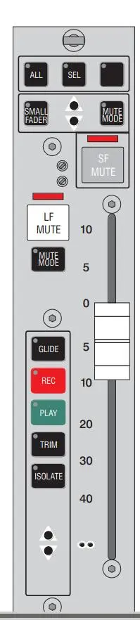

Which really makes no difference since Neve consoles as well as other like SSL have the same signal headroom. Ever noticed these boards have programmable clip light via a cal knob?

I bet its because they only show it to techs and not put it in the manual.
88R. notice the screwdriver adjustments next to "SF Mute"
