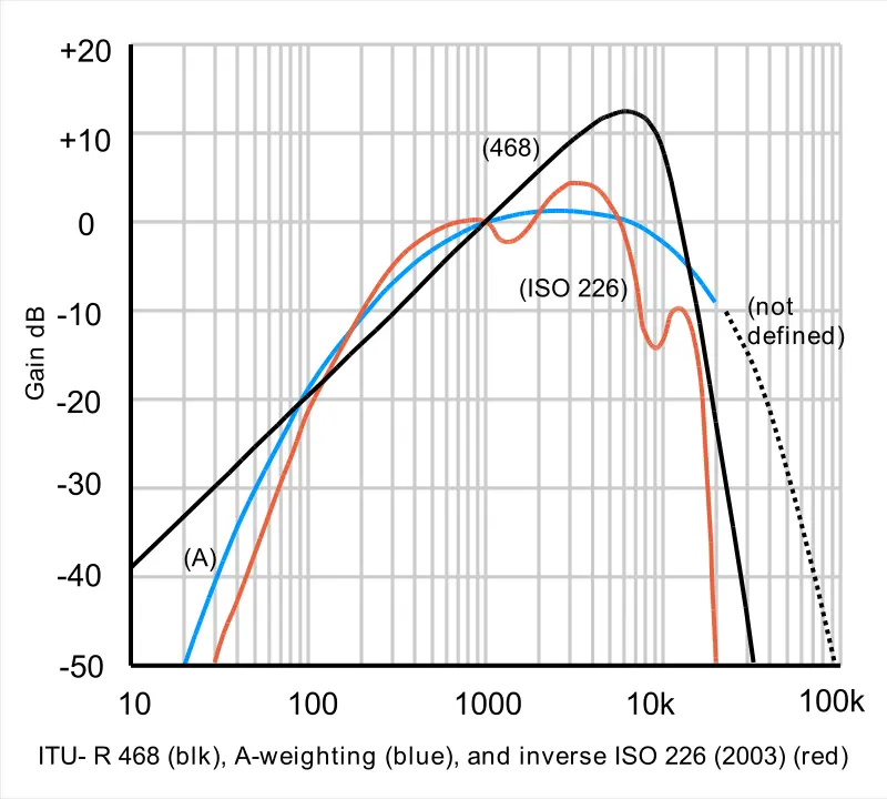

If that manual is the right one James then the mic pres are indeed very low noise. An EIN figure of -129dB is claimed which is bettered today by very few devices. Mind you! Be careful with words like "cheating" ref' weighting curves? That EIN is a DIN weighted number.
The Audio Industry has always massaged its figures so as to present them in their best light. Most here will remember the "Watts Wars"? Music power, Peak power, Total Peak Music power... We still have a legacy in the form of the totally daft "RMS" Power! Some manfctrs intend to mislead but I think most simply feel they have to jump on the weighting bandwagon to compete?

Not really trying there James! As we can see, DIN is a much 'peackier' curve than A.
