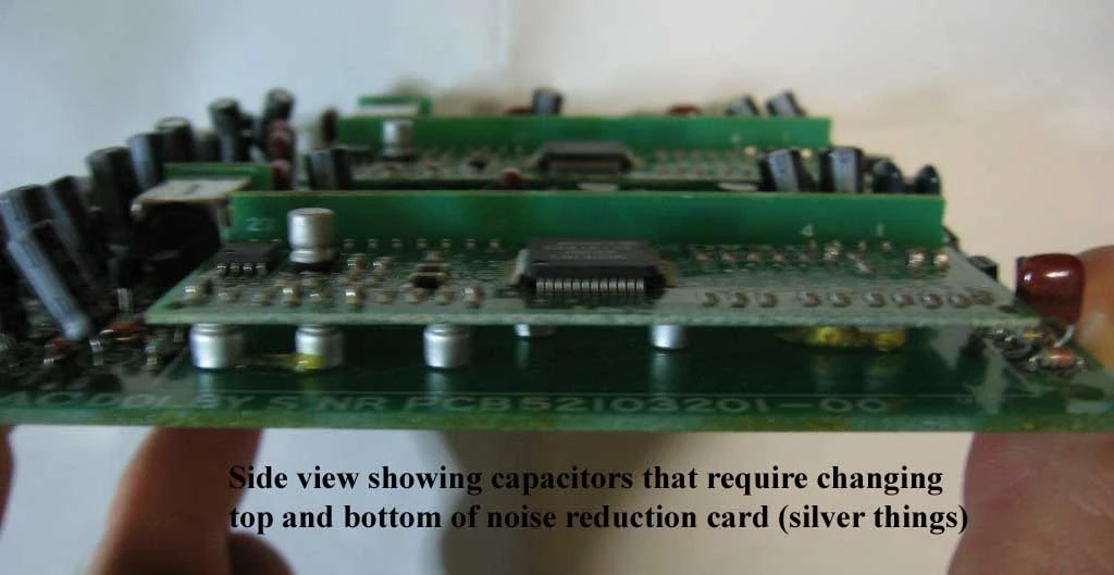

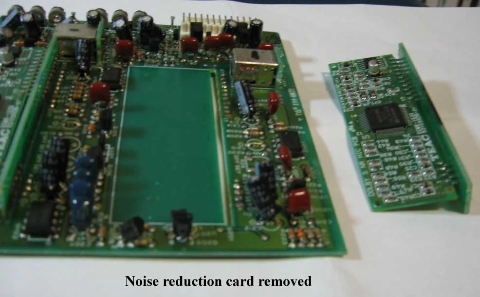

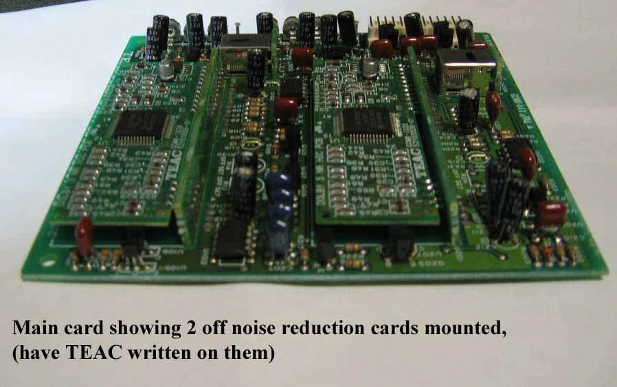

With circuit diagrams regarding the S noise reduction, the only circuit digram you get is the mother card (large card that covers 2 channels of the recorder) the actual S card (one for each channel) is mounted on this card, these are made under licence from Dolby and you won't get the circuit diagram from Tascam as they won't have it. I have attached some images to show what I mean from an article I wrote about changing the caps.
Also there were 2 versions of the Dolby S card, I am talking about the MSR16S but could be the same on the 24S, as they started using micro caps on the later cards where by the early cards had to old larger caps. The later cards were a pain when the caps went out of spec as they are almost impossible to replace unless you get a specialist micro solder person to do it, the early cards were easier and I have found that they seems to last longer, in fact I have never had to change a cap in an old card yet. I was having trouble with my MSR16S and was lucky enough to buy a parts machine which is where I found that the dolby cards were different, I swapped them all out to the old version and the machine has worked fine ever since.
