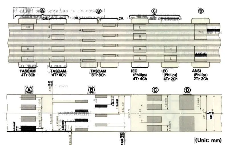

It sounds like you're sending the stereo mix to the TASCAM 688. That's not a good idea, since you'll either get a rather thin-sounding result if you send it to a stereo pair (low tape speed + razor-thin tracks) or strange phasing errors if you record Left on half the tracks and Right on the other half.
If you want to bounce the final mix to tape, a 1/4" half-track machine like the TASCAM 32 or a BR20 would be a much better plan.
Regarding expanding the digital IO, can you get another 828 and lock them together?
Well, I disagree...
F/I, if you recorded all 8 tracks on the 688 in (4) Left/Right stereo pairs simultaneously, there would be no phase anomaly in the playback. I understand what you're saying and why, but it may be a minor misunderstanding.
However, OT, if someone wanted to migrate a prerecorded 4-track Portastudio tape to continue laying tracks on a 688, 488 or 488mkII, based on how the 4-tracker's tracks 1-4 overlay the 688's tracks 1-8, there would indeed be an undesirable phase shift anomaly between the tracks (1/2) and (3/4).
On the other hand, my reasoning for NOT using the 688 as a pseudo mastering machine is:
1) like you said, a single pair of matched tracks would be razor thin and decidedly lofi, and...
2) even the entire set of 8-tracks recorded in 4-stereo pairs simultaneously would be a lofi assault on the higher fidelity provided by the DAW, and is nowhere near true "mastering" deck fidelity. I just don't think it's worth the trade off in fidelity,... to borrow a phrase posted on this board a little while ago.
:spank::eek:;)
