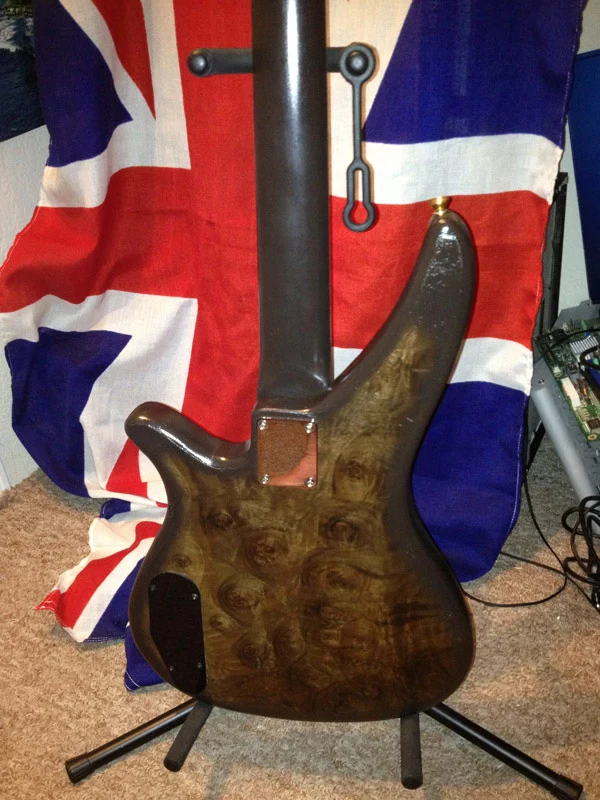

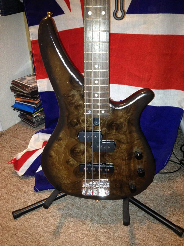

Thanks Creek. I already have a body and neck for my next project from GuitarFetish. This time was my first venture into doing a refinish. There's a lot to learn. And the big lesson is don't try to remove the undercoating from a metallic finish. What a pita that was. Like you said, get a new body and neck.
And while I didn't knock this refinish out of the park, it served its purpose as a learning tool. There are a lot of little noticeable mistakes and blemishes. But overall, it came out okay.

The Brit Union Jack is to acknowledge Mutt's help. Thanks man!! And thanks to everyone else who chimed in on this thread. Very cool.
Next project is a Jazz bass. I will be putting on the same veneer. (Because I still have 4 sheets of it to use.)

Shit I think it came out pretty decent. Well done.
looks good man ..... do a bit of relic'ing and none of those little things will catch your eye anymore.
Thanks ya'll If you saw it up close, you'd say something slightly different. I hope I learned enough that the next project would be sellable. Not that I want to put Mutt out of business, but as a measure of how good a job I can do.
And... relic'ing to me means to play an instrument for 20 years for the aging process. None of that faux relic stuff.....
oh I see it. You can clearly see the edge of the veneer sheet for one thing and the finish around the edges look extremely rough and pebbly.
But man, this is your first one ...... it's the one for making those mistakes on ..... it looks fine for being your first.

Great job!
Don't worry about the few blemishes, you didn't want it to look factory perfect, did you?
Actually, there are "Zero perfect, factory, finishes".
They all have bad spots.
If you look close enough, that is....:cool:.
The end result is good for a DIY/learning project.

Thank you very much. In fact, I like the open pore look. But I would rather have had the interface between the veneer and the body a little better. I also would have liked the sunburst paint to not peel when I applied the clearcoat. I repainted the neck, but didn't put a clearcoat on it. Seems to be the only way to keep the paint intact. :(
