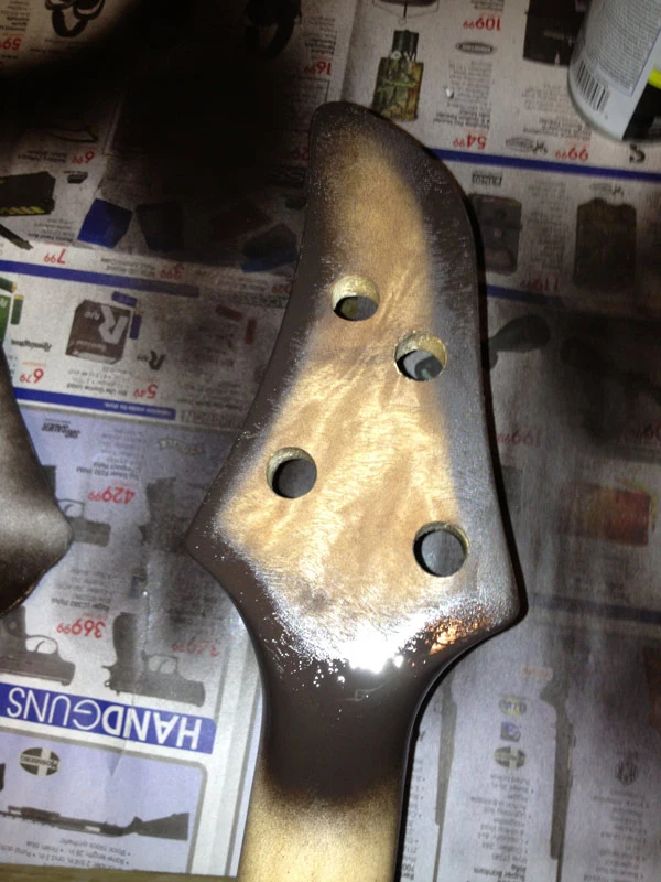

Just shot the back of the body and head. Here's a pic right afterwards.
So, after looking at Anfontan's thread, I'm curious if I should paint the whole neck here. As you can see, I stopped and inch or so down the neck with overspray. It looks okay, but maybe I should do the whole neck. this was a Satin finish Dark Walnut colored Lacquer spray paint.
What do you guys think??
I'm having a little problem with the clearcoat. I sprayed the sunburst on the head and completely painted the neck. When I went to put on a clearcoat, it lifted the paint; as in bubbled and peeled. I waited a day or so between paint and clearcoat. I suspect the weather is too hot for the lacquer finish. We've been pushing over 100F (37C) everyday.
I sanded it all back and will redo it. This time I am cooling the neck and lacquer can in my office before going to the garage to spray.

It's never too hot for lacquer. The hotter the better.
Not true.
There is an optimum temp for all lacquers. If the ambient temp and air movement isn't right then the solvents will gas off from the surface too quickly and harden forming a skin which traps the solvent deeper in the coat. This can result in crazing, rippling, peel and in extreme cases bleed into lower coats and poor adhesion.
Each lacquer comes with a data sheet on which the working temps are given. You can get more info from the tech dept of the manufacturer who will give you load rates fro different environments and applications.
If the ambient temp and air movement isn't right then the solvents will gas off from the surface too quickly and harden forming a skin which traps the solvent deeper in the coat. This can result in crazing, rippling, peel and....
On my hunt for an answer (the internet can truly be a good thing!!), I read something very similar. Looking at the can more closely it says nothing hotter than 90F (32C). That's almost impossible here except for the winter.
I sanded down the neck and removed most of the paint then placed the neck and the paint can in my office to cool off. Reshot the neck yesterday and now I'm letting it sit a few days before putting a clearcoat on. The neck and can of clearcoat are back in my office cooling off until I'm ready to spray it on. Hopefully, this will work.
When it gets really hot here which isn't very often, I will normally shoot the final coats late at night as thing cool down. Just lately we have had a bit of a heat wave here and even in my conditioned booth it has been getting quite hot. With a rattle can you can immerse them in cold water for a bit to take the edge off and lay up a little thinner than you normally would. On really hot days I will keep the lacquer pot in a fridge until I need it. The work piece should also be cool for that to work.
Moving the work piece out of the booth is not some thing I like to do as it increases the risk of getting contamination on the finish. Clear coats need to be just that to get a truly pristine finish. It maybe be you best bet but make sure that you hoover the area first and once it has settled keep all doors shut for as long as the lacquer needs to gas off to touch dry. Should be hours not days..

I was using scraps for experimenting, but ran out. I have more sheets of veneer, but those are for later projects. In a sense, this cheapo bass is my scratch pad. I was hoping it would not have any flaws, but for a learning tool, it's working very good.
Thanks for confirming my theory on the temp issue.
There was some fine print that said to spray clearcoat on top of the paint within 2 hours or wait 2 days. The 2 hours didn't work, so I'm letting it sit.
I'm assuming that your colour and clear are the same type and brand?
Both are lacquer, but not the same brand.
The reason for the 2 hours or two days is exactly because of what you have experienced. If you go on soft it will gas off easily, ie within two hours. If you lay up hard, ie after two days sufficient gassing off will have occurred to let the top coat sit without sinking into the hardened lacquer. It will just key into the top. Anything in between and the skin on the base layers will trap solvent and you will add to the problem by laying up fresh lacquer inhibiting the gassing off.
I asked about the same brand/type because you can have other issues if you try and spray acrylic over enamel or vice versa.. Best to stick with the same type and brand unless you are confident that it will work. Just a heads up.
You can test on scrap that isn't of the same type if you aren't worried about build or drop in. It will still give you an idea of how the lacquer handles while laying up.
Finishing can be a mine field if you haven't got a decent set up. It's one of those things you learn as you go and when you have a routine that works. Stick with it. I hate changing brands let alone lacquer types.
I'd guess that with the temp at the top end of the range you had the top part of the coat gassing off two quickly and forming a skin well within the two hour window. The solvent deeper in the coat would then get trapped and take a LOT longer than normal to gas off. When you work at the the top end of the temp range you have to work quickly or spray thinner. People tend to want to rush the finishing as they view the job as nearly done. Thats when most of the problems crop up. Take your time and go the slow route.
