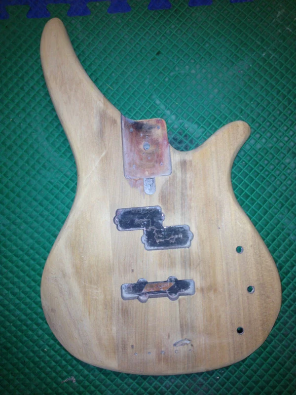

Sanding the undercoat was a PITA, but it's done. 60 grit on the front and back and I had to buy a flapper wheel drill bit for the sides. Tough stuff. I will never do that again. I even tried paint stripper and it had no affect whatsoever. WHATSOEVER!!
The flapper wheel "contoured" the wood in peculiar ways, but a little sanding has the body looking nice and smooth again.
Next up is to trace the cutouts onto a piece of paper to make a template. Then I will glue the veneer to the body. Once the glue is set, I'll use the template to cut out the holes for the pickups, neck, controls, etc.
Here's a pic with all the paint removed.

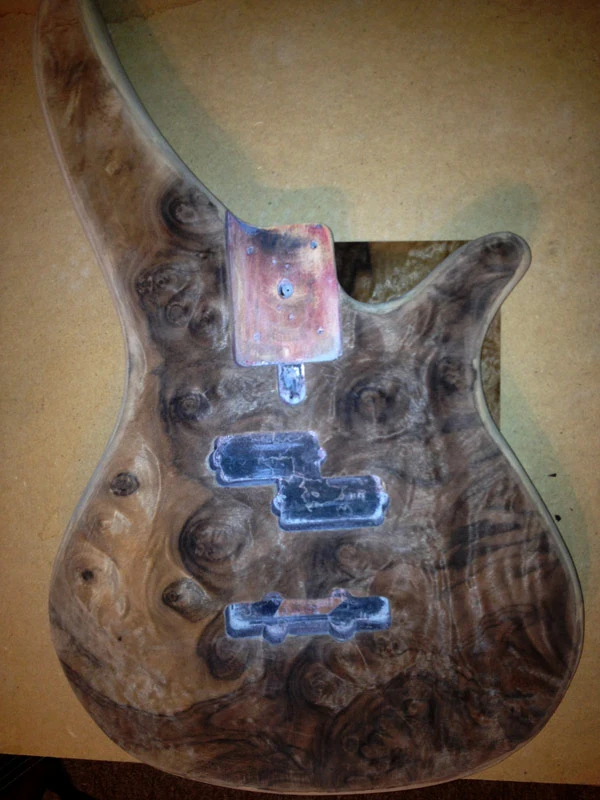

I got home last night from a week long trip to Germany, so no progress. (Almost got to visit our friend JoeyM, but he had a gig the one day I was available) Last weekend, I glued the veneer to the top and let it sit all week. It's very brittle and cracks easily, so I will have to be extremely careful when I trim it today.
Update!!
Trimmed the veneer and cut out the pickups and neck slot.
At first I thought I made a huge mistake. When trimming the edges, the veneer was brittle and cracking and breaking at the edge. It came out really horrible and I thought I had trashed the guitar. But with just a little bit of sanding, it cleaned right up. I still have a lot to do to get it to fair in nicely with the bevel of the guitar edge, but at least I know it will be pretty decent when I'm done. <whew>

Been away all week... again... :( Got back last night and got to work on it today.
More sanding on the edges. Good but not perfect, but leaving it as is. I could keep sanding until there's no guitar left. Then sanded the top with up to 400 grit. Smmoooth.
I then added a veneer to the back. Trimmed and cut out the access panel. Tomorrow I'll sand the edges. Now that I know what I'm doing, it should move along quickly.
