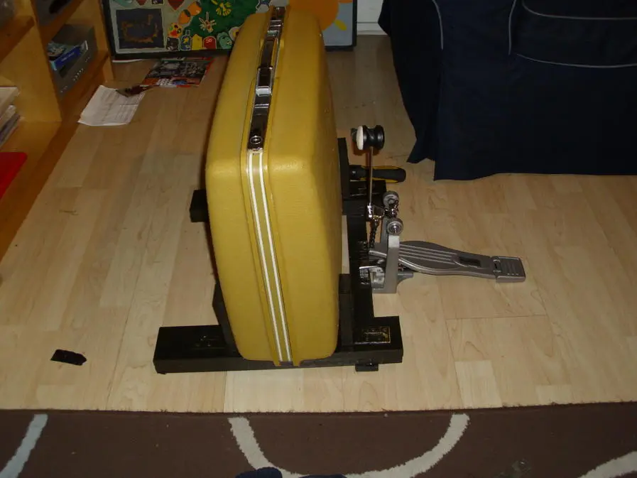

The first time I recorded with the suitcase, I really quite liked the sound but one thing I found was that the case moved about alot as my friend was playing. Fortunately, it didn’t spoil either of the two recordings we did that day but it did leave me determined to make some kind of holder for it. So here it is ! It’s based on a model that this woman who plays in a C&W duo came up with but I added my own little modifications {such as they are}.

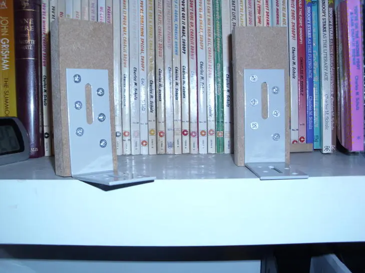

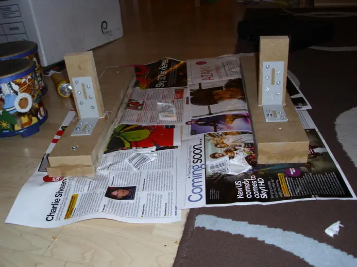

Usually, I’d lay all the materials out to give the viewer an idea of what was used and the sizes. But some of the pictures I initially had disappeared. {I'm still at a loss as to what happened to them !}. However, it’s mainly made of MDF. There are 4 long pieces DSCI0021.webpand 4 short pieces, 4 metal right angled brackets, DSCI0016.webpscrews and wood glue and a piece of plywood for the pedal to attach to. The plywood I got out of a skip, the MDF I had premeasured and got cut at a hardware store {B&Q} that does cutting. From what I remember {this was a year ago}, I got them from the off cuts bin so they were really cheap.

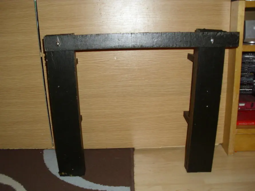

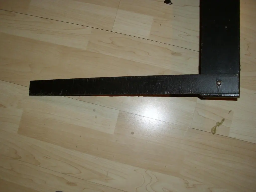

I used the four MDF pieces as the base, two stuck to two. DSCI0019.webpI did this because I wanted the base to be really strong. One of my drumming cohorts can be quite an aggressive player and I didn’t want the case to be moving about at all. Once the pieces were screwed and glued, then I attached the smaller pieces against which the suitcase would actually rest. Once one side had been attached, the suitcase had to be pressed up against it to get the measurements for the other side.DSCI0022.webp You could estimate but it was better to just put the case there.

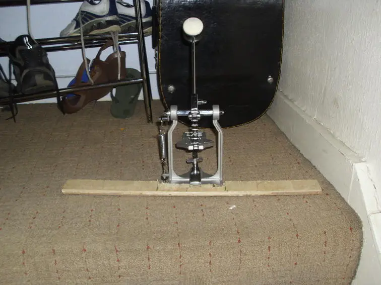

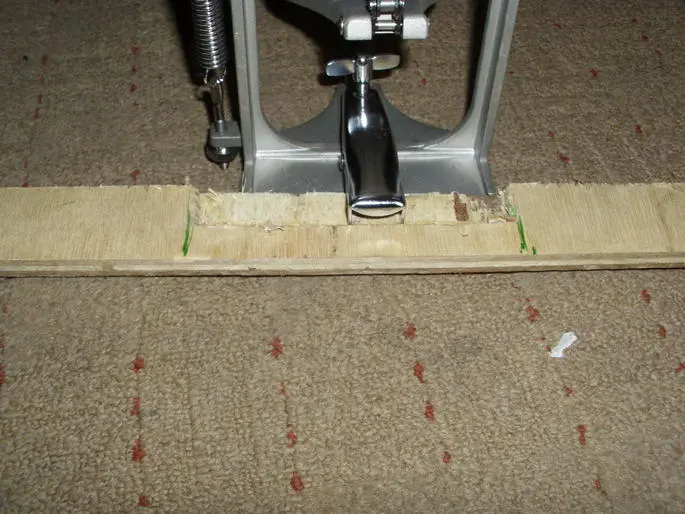

Once the two ends were complete, the next stage was to get the piece of plywood on which the kick pedal would be attached. I found it a bit fiddly DSCI0023.webpgetting the exact spot where the kick clamp would go. A couple of centimetres either side of centre wouldn’t hurt but centre was my aim. I didn’t quite make it !
I had to chisel out some of the ply DSCI0024.webpso that the clamp fitted and I wanted to get a really good tight grip for the kick.

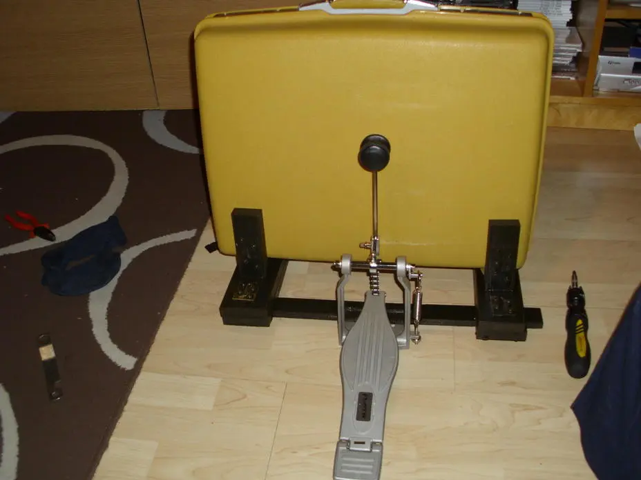

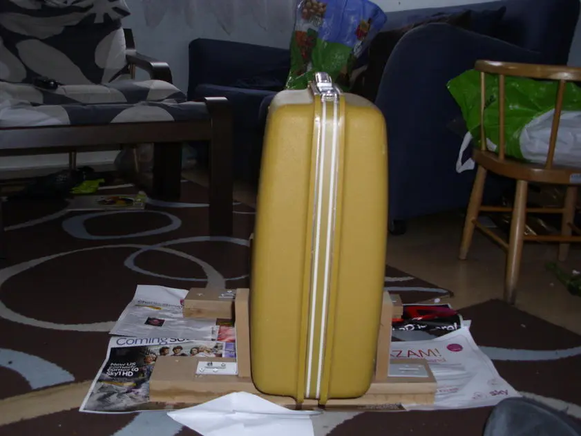

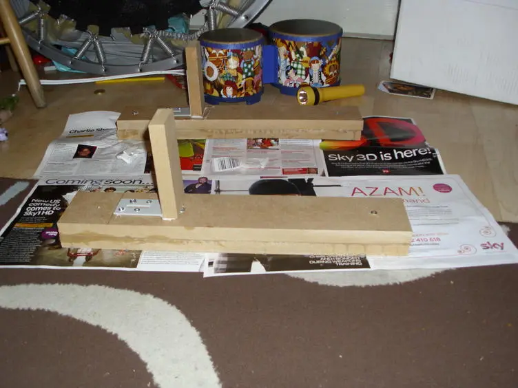

The ply for the kick is what actually braces the two sides of this device together. DSCI0334.webp DSCI0335.webpI didn’t want to have to keep unscrewing both sides every time I was going to use it {like the original} so I left one side screwed in and when not in use, it just folds to itself. DSCI0333.webpAnd then you just screw in one side when it’s to be used. DSCI0336.webpAnd remove the screw when finished.
Very straightforward. DSCI0339.webpPainted it black then varnished it with this dark brown stain varnish that I’d been trying to get rid of for ages and it turned it brown !

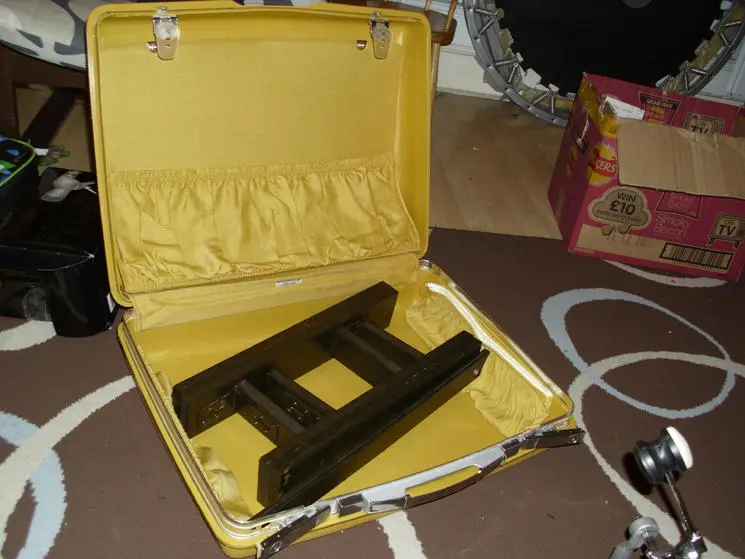

The good thing about it is that it’s very easy to store away. You just put it in the case ! DSCI0330.webp

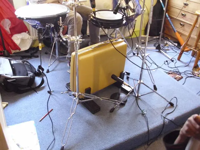

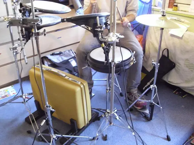

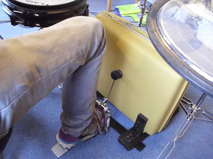

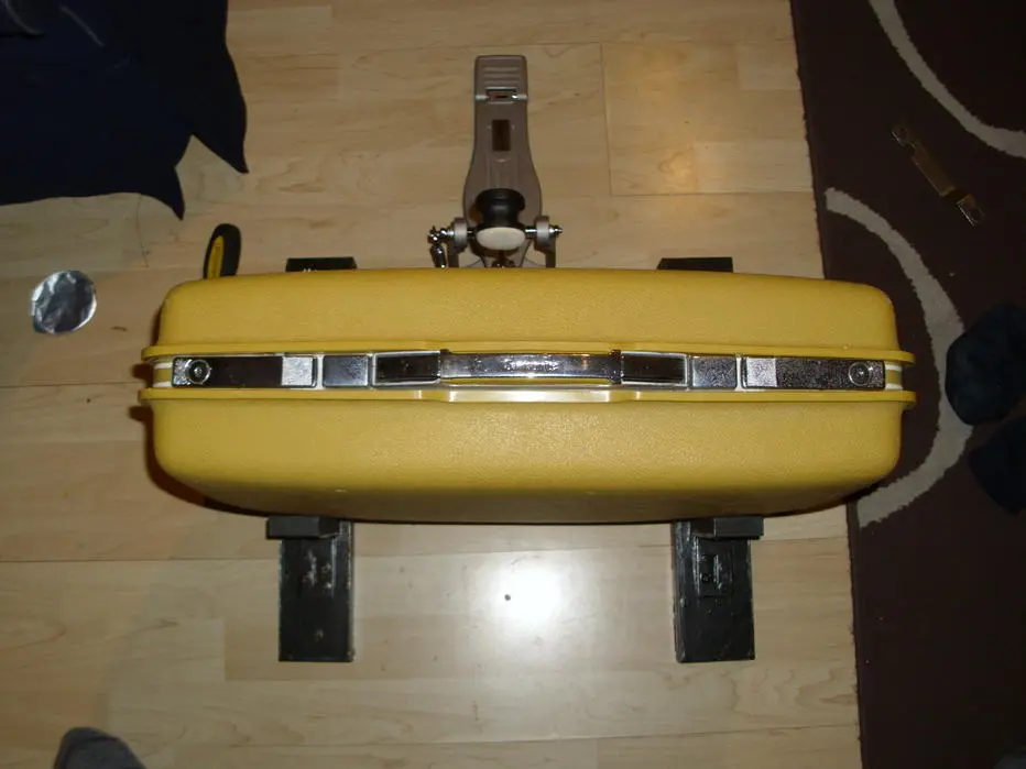

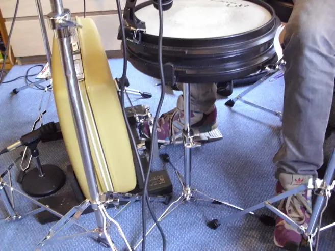

It’s very playable, the case doesn’t move at all. suit 2.webpYou can adjust the pedal to determine what kind of hit you get. suit 1.webpIt doesn’t sound that good live, but it does recorded, which is my raison d’etre. I’m always pleasantly surprised how clear it is recorded. suit 3.webpIt’s yet more scope for sounds. I use this, the original bass drum, an electronic kick { a Session pro through an OSP DD502 drum brain} or very rarely, bass drum hits from the kits in Sampletank. I like them all for different applications.
So if there’s anyone out there that might be contemplating a suitcase bass drum, hopefully this gives you a starting place in constructing the holder. suit 4.webpHave a look out there on the net too though because there are some useful {and maybe better} alternatives. Mine is really basic.

Yes. I stuffed the case full of clothes and stuff. I can't say it made the kind of difference it would in a regular bass drum. But I need to do a little more experimenting. I want to find a way to cut down bleed to the kick mic on the suitcase. I'm not an opponent of bleed, there'll generally be some and as someone in a thread I looked at today pointed out, bleed is a low level version of what is already there. Sometimes though, I've got a better and meatier overall drum sound in the kick mic than any of the overheads ! I've long found that there are so many bass drum tones, almost if not as many as snare tones.
But I say that in the context of the suitcase mic going straight to my DAW and not going say, through an amp or monitor.
