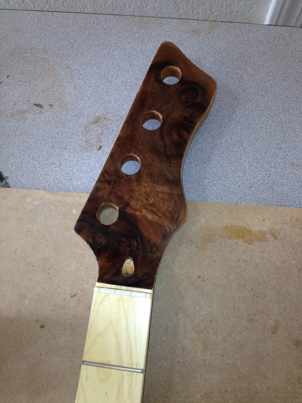

I trimmed down the heel of the body so the signature "jazz Body" shape wasn't so prevalent and I shaped the headstock then applied a veneer. Came out pretty nice.
Here's a pic. I'll get more posted later.

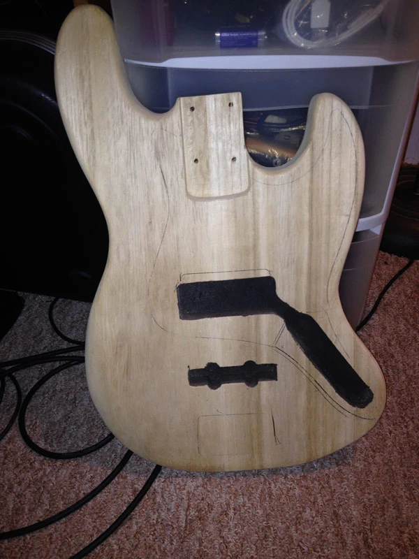

Here's a pic of the body. I routed out the control cavity wider to accommodate the Active EQ board I'll be using ( got it off of Amazon for a pretty good price) I reshaped the body to remove the heel and make it more round. (Compare it to the GuitarFetish pic to see the difference)

And I gotta say the neck looks good. The headstock is a blank so you can cut your own design and the fretboard is like anything I'd expect from a manufacturer. For less than $50!! The only thing I didn't like with the neck was the holes were pre-drilled for Fender sized tuners which have a large diameter. I wanted a different style tuner, but the diameter was much smaller and they were too small to fit properly in the pre-drilled holes. so, I had to buy the goofy looking elephant ear style tuners because they are the only ones that fit the pre-drilled holes.
Next time plug the holes and veneer both faces then re-drill. Job done... I'd normally do that any way. Drilling the tuner holes is one of the last jobs I do then ream them to suit..
