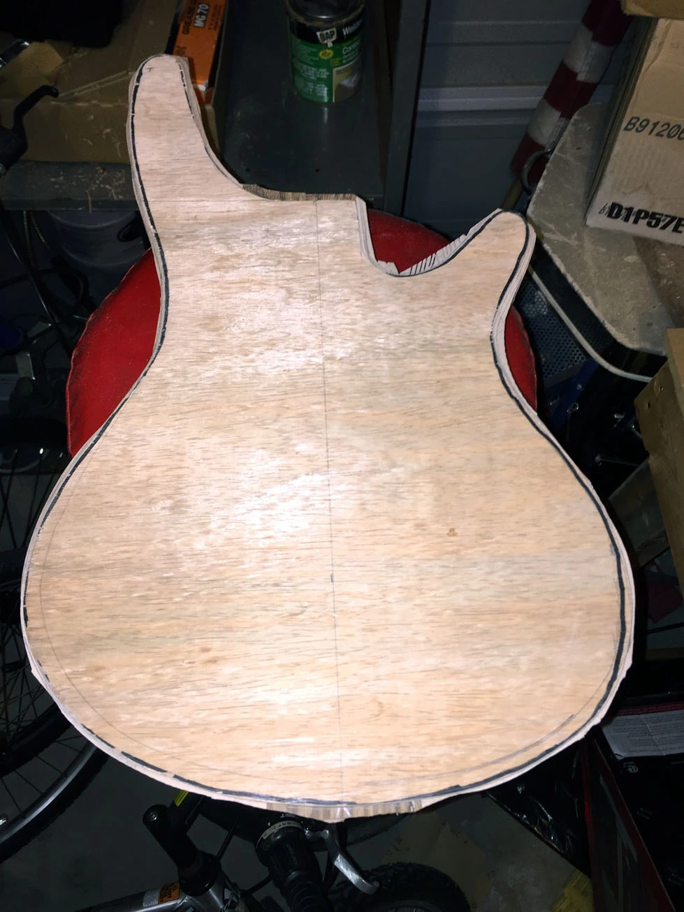

Hey, a hand stained burst isn't easy.
I'll usually do the base color first then do the darkest color next, then blend.
sometime to blend it's just a clean cloth with alcohol.
Yeah the horns aint bad. I'm thinking about painting one of my SGs with a serious kandy flake. Something that will explode under stage lights.
I did the Honey Amber for a base. Wipe, sand, wipe, sand. I wasn't really happy with it. So, I got the red tint and put it on around the edges, then more honey amber on top. Then just alcohol, like RFR said, to blend it.
For the black, I put the template on top and raised it up about half an inch. Sprayed the sides solid and then came at it with a lower angle so the mist would go under the template and fade. I think you remember what I did on the last bass. The same concept.
I noticed the pics didn't show up in one post. I'll go back and fix that.
I'm sure you've got some experience doing the flake stuff from your auto body work. It'll be cool to some 3D flaking on the SG.
Ha, no, body work is one thing I didn't do. I was mechanical, not the body man. I could do basic shit like knock out a dent and install hood scoops and shit, but fine detail and paint work...no way. I'm gonna practice on some wood.
I'm itchy to sand off all the black and start over. Flying out to LA tomorrow, so I'm not gonna touch it until Fri or Sat. That will give it a chance to cure and me time to re-evaluate the finish.
