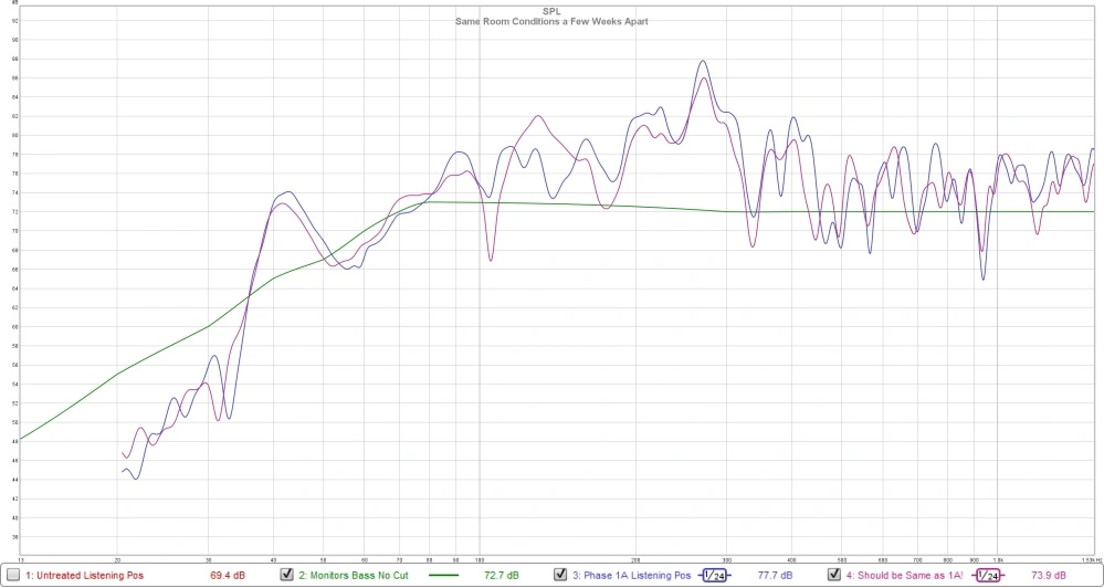

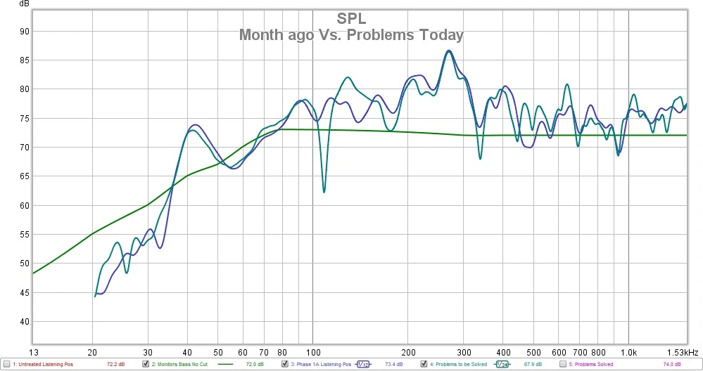

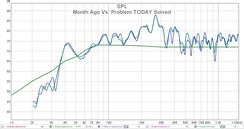

Unfortunately, I don't have a lot of experience doing this and a trained ear to work with... I'm pretty much a noob to this.

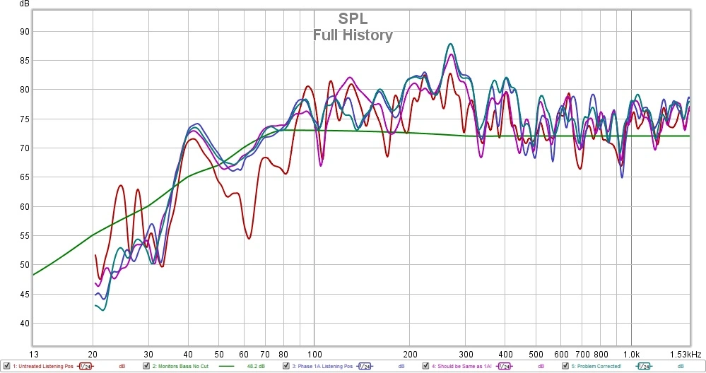

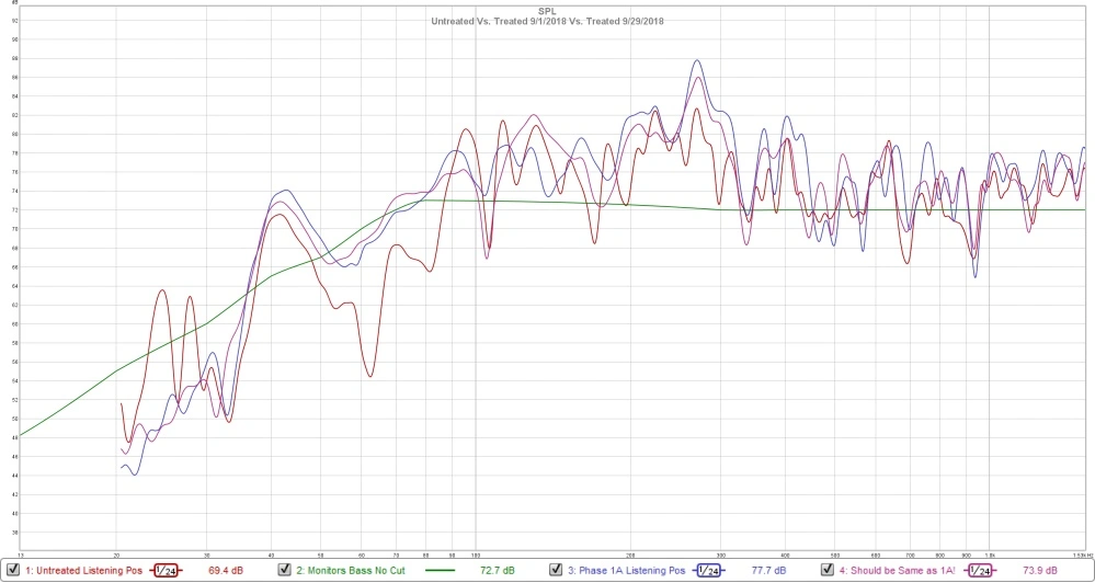

What I do have is an electrical engineering degree (only barely relevant--just means I have a concept of frequencies and some of the math around them), and a high tolerance for research, looking at graphs, taking measurements, and experimenting. I hate spending money without justification, so I wanted to be able to document "before and after" of all the time and money I was investing in treatment. My treatment approach has been pretty much "by-the-book" (but not so much "buy-the-catalog"), so the measurements are just to help me convince myself that the book was right, and it was worth the investment.
I had some bad experiences back in college with mixing decisions made in a tiny un-treated dorm room. After that I decided that if I was ever going to attempt again to actually record music I would put the effort into fixing a room as best as I could.
I know it will never be perfect, and I think I have about hit the point of diminishing returns, but my tests today with the Acoustimac panels in temporary position have me down to about ±8db across the spectrum. That's pretty good, right? I'll post those details once they are permanently mounted.
