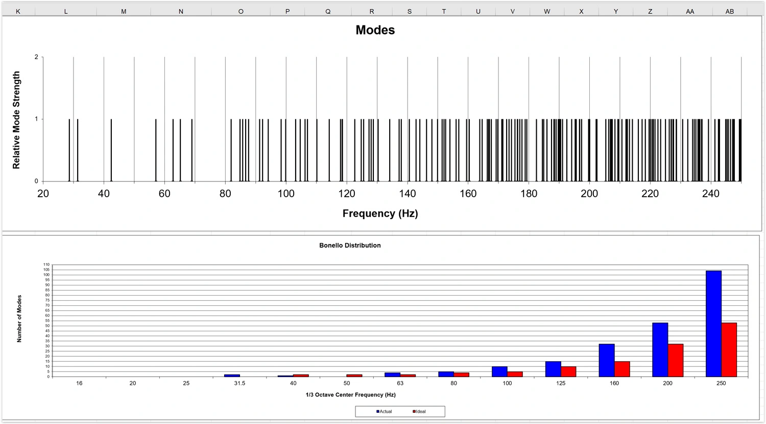

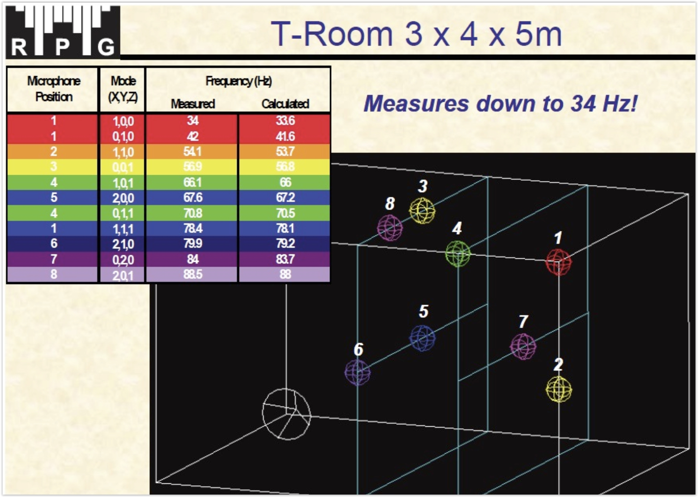

The approach I took was used John Brandt's Excel spreadsheet to model and used REW to verify all the room modes with the room empty using this RPG chart. You'll get confirmation on where your problem frequencies are. From there, you can calculate how deep and how much it will take to get them under control.

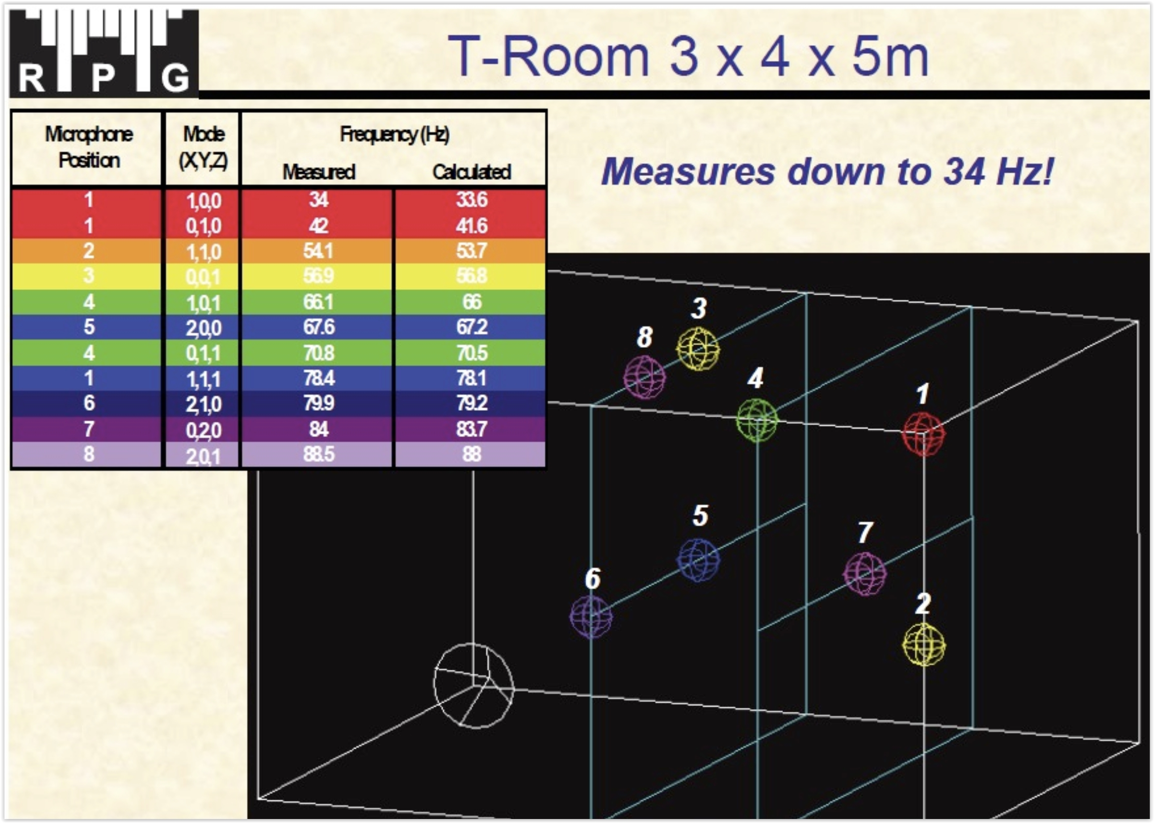

The idea of measuring empty is to verify theoretical. It will likely be off slightly due to variances in construction or physical measurements but the idea is to check that you've not made a mistake in calculation. You fill it up, you won't know. The process is pretty simple. Place a speaker in the corner (represented by the circle in the rear left) and measure sweeps looking for mode peaks in the listed mic positions and compare from the spreadsheet.

I never really liked basement studios so when I built my house, I went up rather than down. Living out in the middle of nowhere meant I didn't have to have a lot of mass so I could build with low end energy escaping (cows next door never seemed to mind). Also was fortunate that my issues both measured and actual were not in the sub range.
I was using a Tannor 15 inch sub with a couple pairs of KRK and struggled with getting clarity in bass above 80 as the enclosed chart will show. Also if you get my user name, sub bass wasn't my thing. Even still, 125 was a real pain to deal with and why I have a full ceiling cloud. I used a JBL 305mkii to measure initially and played with the sub a bit. Because of the porting in the 305, it has a resonate bass peak that made things confusing a bit at first. I jotted down a couple numbers with the Tannoy and quickly moved on as sub 40 wasn't my issue. Of note, actual was pretty close to this chart (got my numbers somewhere but it's late).
The handy thing with the spreadsheet is that it gives you a baseline of what your challenges are likely going to be and John's also lets you know how much bass trapping your going to need. From there you can decide what is possible given your particular circumstances and budget. Lots of other people have approaches that are different. For many years I had some treatment which was better than none but far less than ideal. I spent a lot of time with headphones and listening to mixes outside the control room.
One other thing to note, you'll notice the modes are relative, as in 40 & 80. This is typical. If you address the lower, the higher often tends to take care of itself to some extent.
