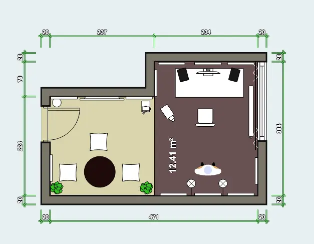

Hello everybody :-)
I'm singer/songwriter and recently I wanted to build home studio to record some of my songs because this was hobby of mine for a long time. I have one spare room where I could build it. Small problem could be small dimensions of the room, and I was wondering if anyone have a suggestions on acoustical treatment of room.
Purpose of the room should be recording vocals, acoustic guitar and also mixing it. I know I can not get the highly professional mix but that is newly discovered hobby of mine and I have strong will to do mixing myself, bought a few courses and got highly addicted to it :unsure:
My plan is to get bass traps on the every corner of the room, and DIY variant of acoustic panels (with rockwool) that i'll be spreading across the room. I had a plan also of building some wooden diffusors if that could help acoustics of the room (i am a woodworker by profession btw, so any diy variant works for me).
I have a little floor plan with dimensions of room and also furniture that i attached into post. Small white boxes that are drawn into floor plan should represent acoustic panels that i plan to build.
I am most grateful for any suggestions that you may have for me.

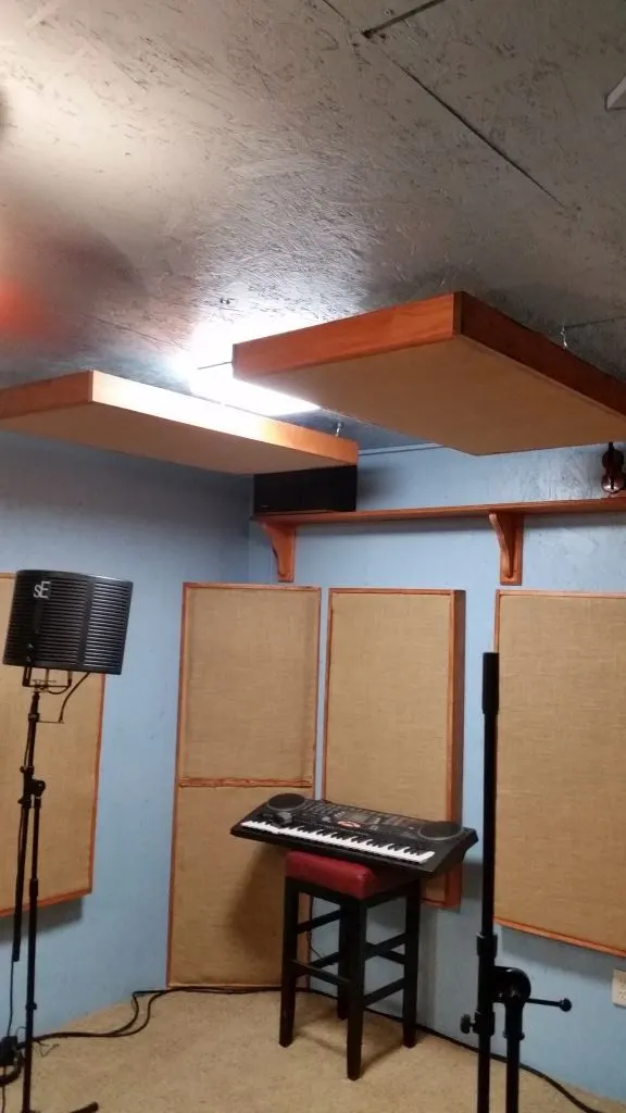

I built these for 30 bucks per panel, I built 30 of them for $1000.00. R80 Rouxul ridged insulation

Mile, it is ENTIRELY possible that this old brain has the math wrong but the dimms on your drawing do not seem to gel with the stated area? That aside it seems we are dealing with a small room and so an even bass down to 20Hz is just not going to be possible. In fact it might be quite difficult to generate much useful LF below about 80Hz...on the basis that "if you can't beat 'em...don't try and if you haven't bought your monitors yet go for small ones, 200mm bass/mid cones or even smaller. Folks like Genelec and Quested make some stonking small monitors.
Small is also beautiful for accurate stereo imaging and a wider 'sweet spot'. Co-incident designs are especially good in this are and allow closer listening thus taking benefit of the 'Nearfield Effect' to reduce room modes. Smaller cabinets can be made more rigid at lower cost than big'uns and so you get lower mid band colouration.
For useful VLF information use some high quality headphones.
As EVER! Look up the back 'Studio SOS' articles at www.studiosound.com.
The acoustic panels you show in your drawing are not in corners. Corners are the worst place for unwanted sound wave build-up and reflections. At least 4" (100mm) rockwool straddling each corner will be better than putting two flat panels on each wall (assuming space allows, of course).
The other problem you face in your design is non-symmetry in your listening position. As long as you don't mind covering that window up, I would set the desk against the wall to the right. It still wont' be symmetrical, but you can treat the corner (upper left area) and side walls (top and bottom in your drawing) more evenly.

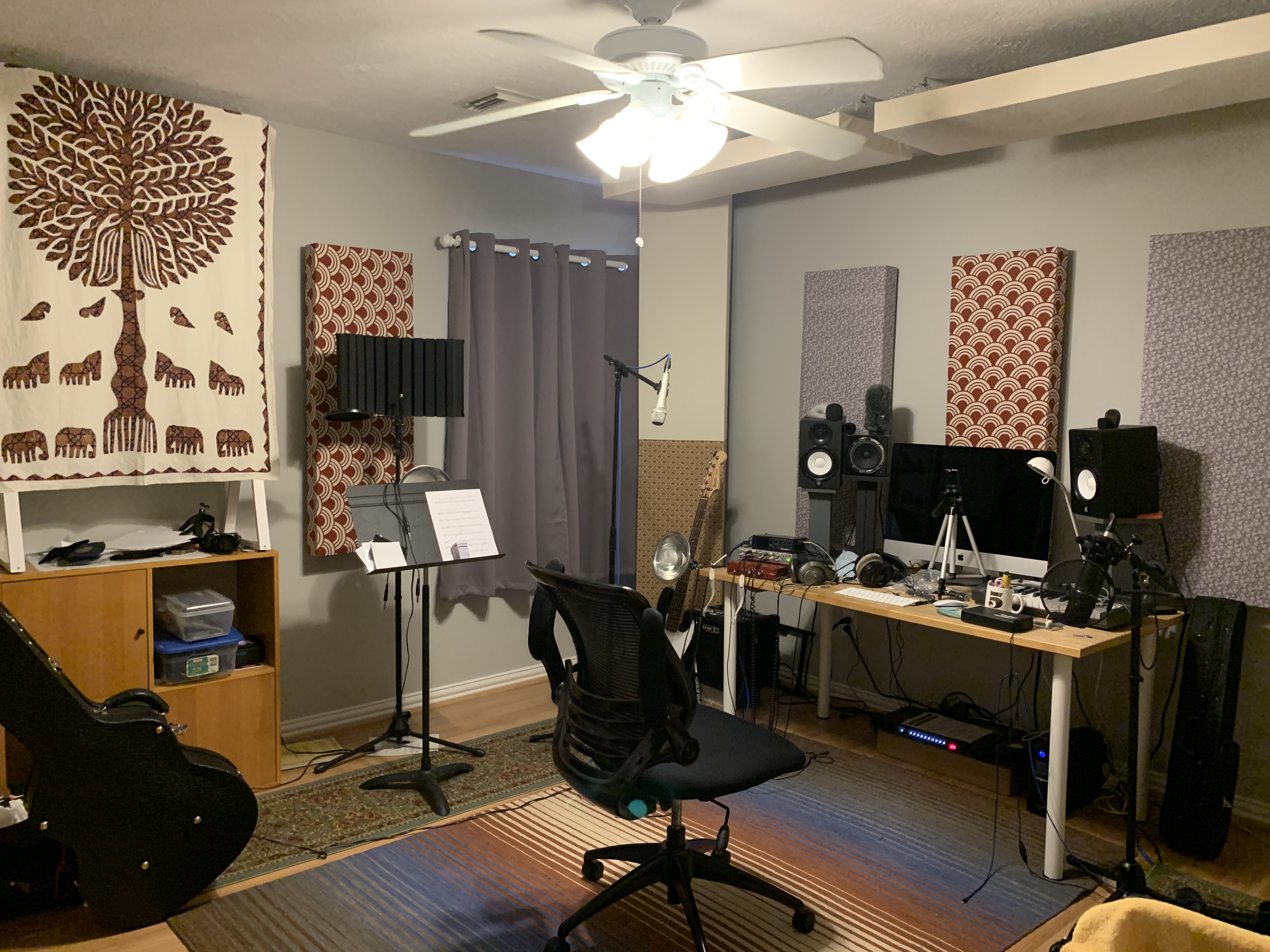

I have small 5" (Yamaha) monitors for my space (an 11' (335cm) x11' (335cm) square room with low-ish, 8' (244cm) ceiling. All panels and traps were DIY, using rockwool and fabric covered wooden frames. I usually don't mix with much bass content unless I have an electric bass track, and then I tend to rely on headphones at least for the bass quality and content.
In my space, I don't have wall panels "everywhere" but kind of alternated on opposing walls, and the back wall is a mix of a heavy duvet/quilt, gobo and short bookcase. (The last is my "diffuser" wall :).) However, I've heard/read that in really small spaces, it's hard to over-treat, at least for recording, since you will likely get better results making sure the room does not enter into the recording, and rely on good reverb plugins to get ambience back. I confess I did not do a lot of home recording initially, and the room's prime purpose was mixing. That has shifted a lot in the past year plus.
p.s. I see that in the forum upgrade, old photos/albums have sort of disappeared, so here's a photo of my space (at the time of the photo - it has not changed a huge amount, though the e-bass and never used vocal shield are gone) taken from the entry door in the corner.

@ecc83 Regarding your question about room size, this is entirely my fault because on the application that I've made my floor plan metric system is used (in cm) (I'm from Europe and I'm sure that you can see that by the grammatic errors that could be found in my writings ?). Room lenght (bottom dimension of the plan) is 15 feet and 5 inches, and width 7 feet and 4 inches (I used a convert application for these measurements, I don't know imperial system very well). I had a hint that everything could be problematic in this room (not only bass freq). My plan was to get good set of studio headphones for that reason and use program like sonar works for color correction of the particular headphones (i have seen that M50x could be good solution with correction and they are also budget frendly). I have not bought studio monitors yet and this is great advice from you Sir regarding the dimensions of monitors that will work good on the room this size. I'm sure that I will get exellent advice for specific model of monitors when the time comes ?
@mjbphotos I thought that this could be a problem, and i did not see the possibility of arranging the desk and other furniture in accordance to the function this room should have. Thank you so much for this good suggestion Sir, if it's not to time demanding I'll ask you to take a look at my new drawing that I did in accordance to your advice (difference is that I've put some closet on the top part of the room in order to help overall symmetry and I've put the desk in accordance to your great tip). I've also put some bass traps on the corners of the room (colored black triangles).
1) The bass traps you have drawn (left side) don't look like could be thick enough to be any good - at least 4" thick rockwool or compressed fiberglass needed. In the corner near the door, you may only be able to put a flat trap against the wall into the corner (that's my situation too).
2) You have left the front corners (the corners/wall you look at when at the desk) untreated.
3) Not sure why you moved the desk out from the front wall, you room is not large enough for this to make a difference, but you probably will need treatment directly behind the monitors on that front wall.

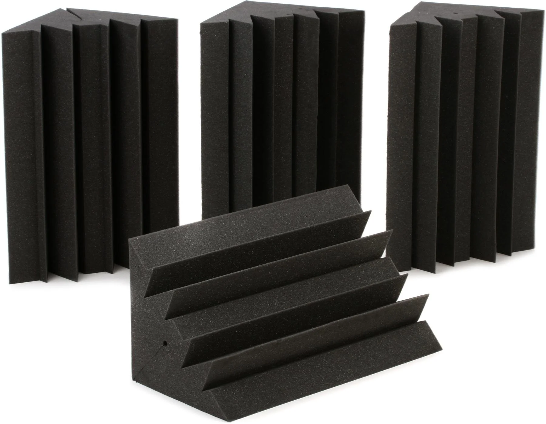

For the bass traps I thought on buying them as a finished product (not really sure on how to make it). I have attached the traps I was planning to buy.

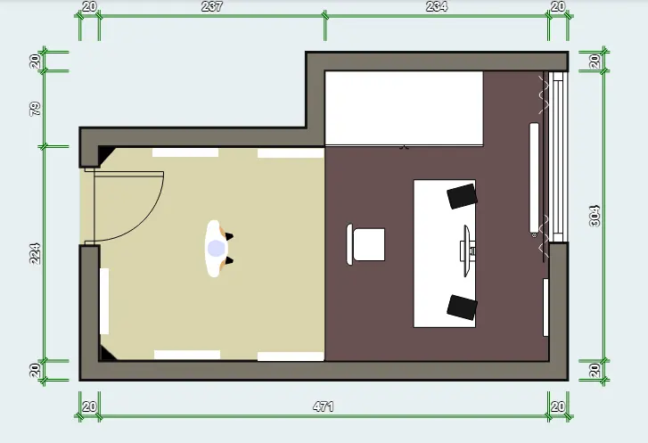

Just to summarize quickly. If the second floor plan would made any difference in the sound quality, do you think that assymetry problem on the first plan should be too apparent?
No! Those are foam. You need at least 4X as much thickness of foam to accomplish the same bass trapping as rockwool.
+1. My bass (corner) traps (you can see one in the pic I posted) are double-thick rockwool batts totaling about 7" (~18cm) of mass, from floor to ceiling. Mass is what "traps" lower frequency audio waves. The rest of the panels are half that thickness. I did not use the denser, more compressed "board" material as it was not available locally, and shipping costs made it prohibitive to procure that so I could make somewhat thinner panels.
