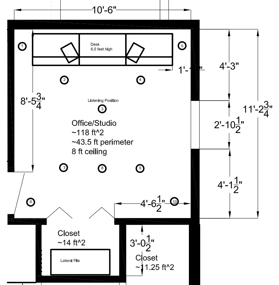

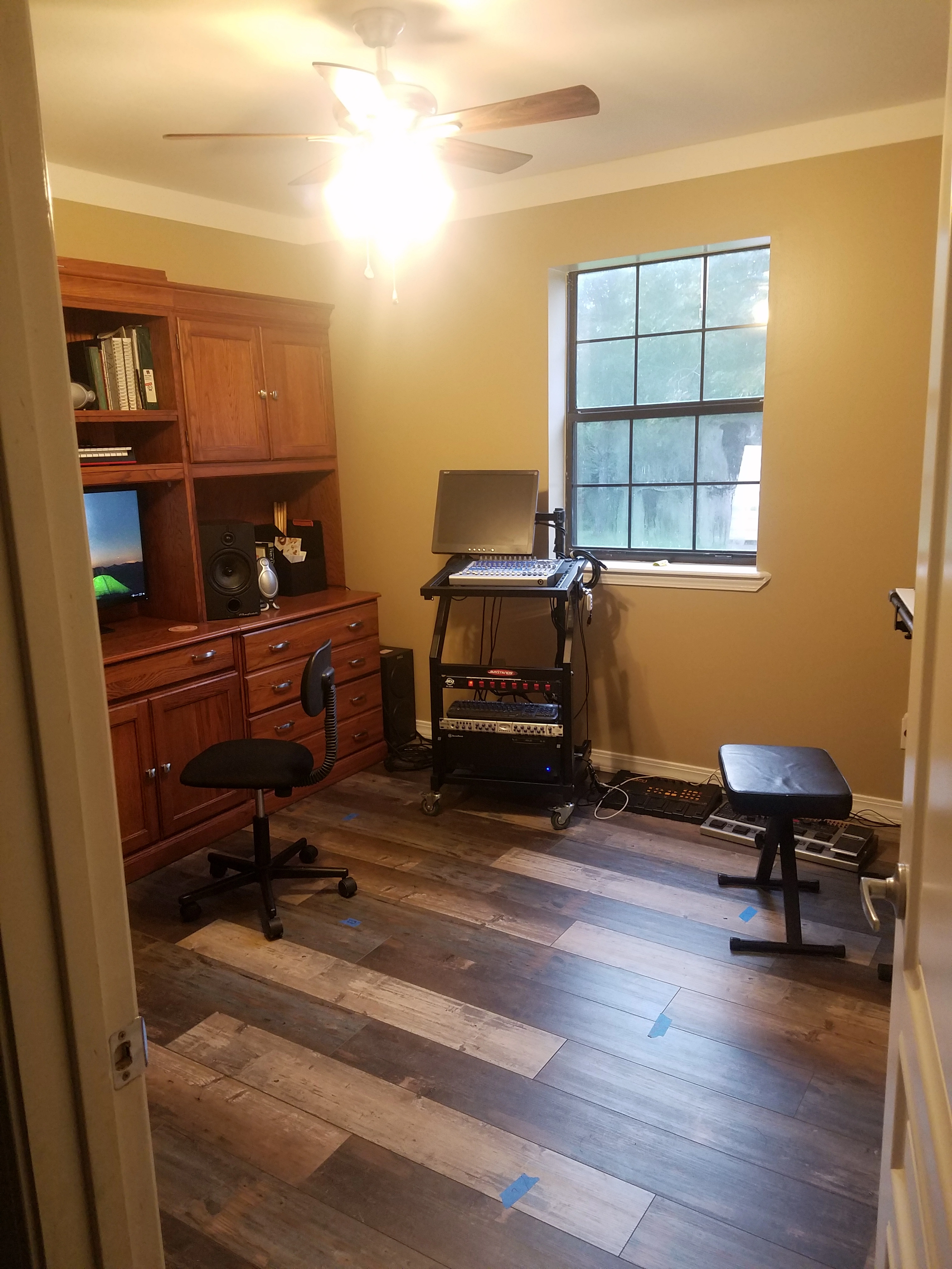

So just over a year ago I started a thread about a room I wanted to use as a studio until I can get a purpose built room. Taking the great input I got there, my wife and I decided to scrap the guest room/studio concept and make this room a studio when I am home and her office when I am not. It is working out well logistically, but I need some help making it work acoustically!
Here is the floorplan:

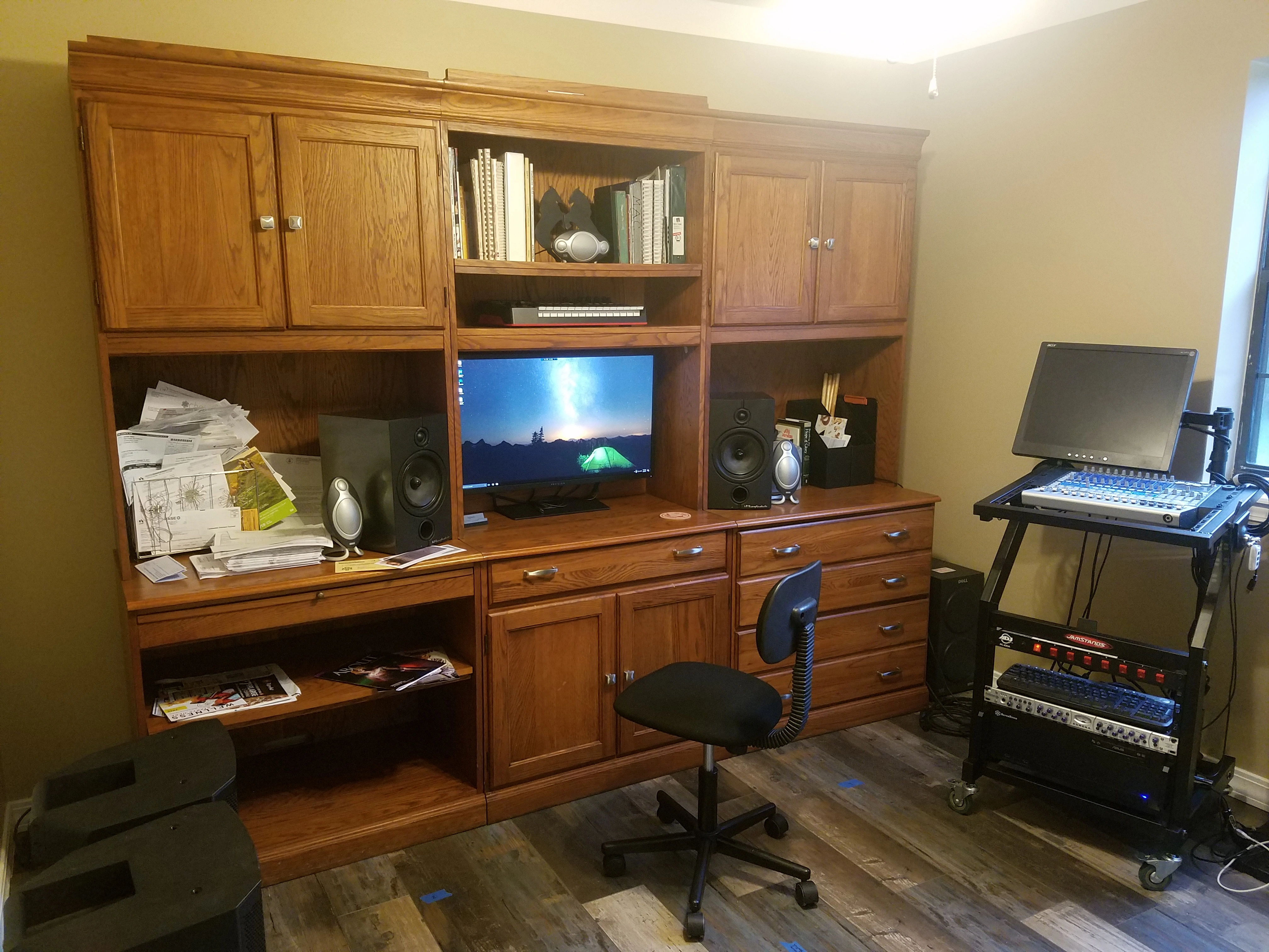

The desk unit we found is less than ideal acoustically, but it is the best compromise for the two of us to be able to use the space. Here are a few pictures of the room and desk unit:
After we painted and floored the room, and installed the base level of furniture/equipment, I got REW and a reference mic and took measurements in 10 locations in the room. The locations are numbered on the floorplan. Below is a graph showing ALL the measurements I took, and another showing only the measurements at the listening position.

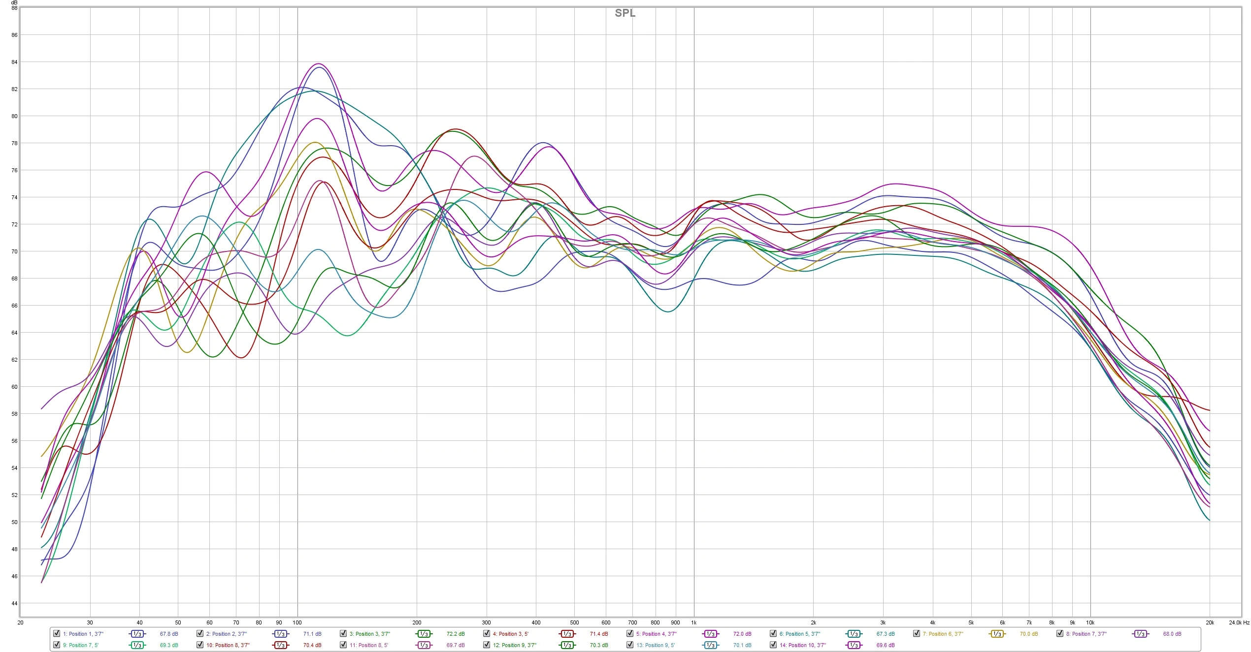

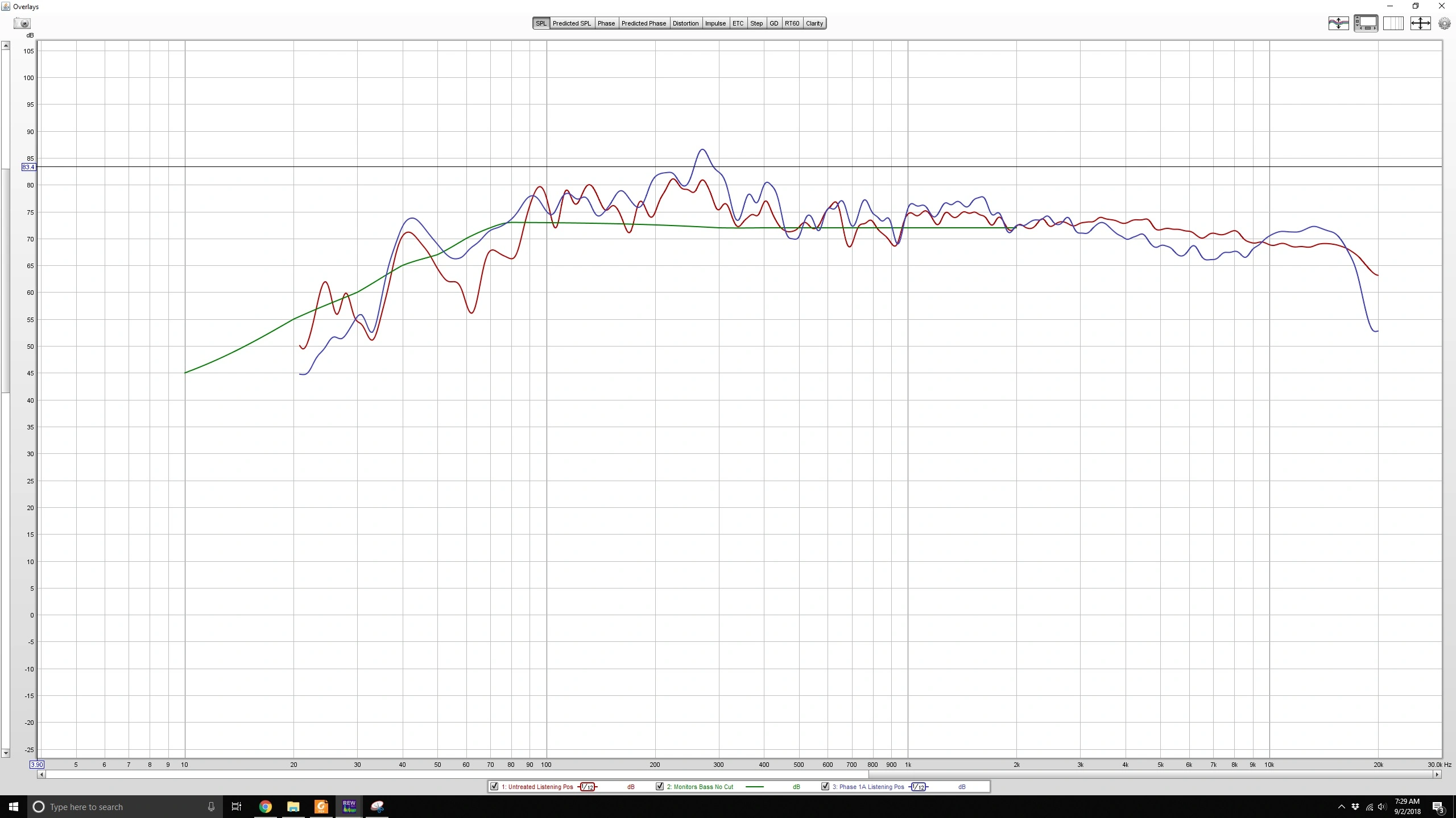

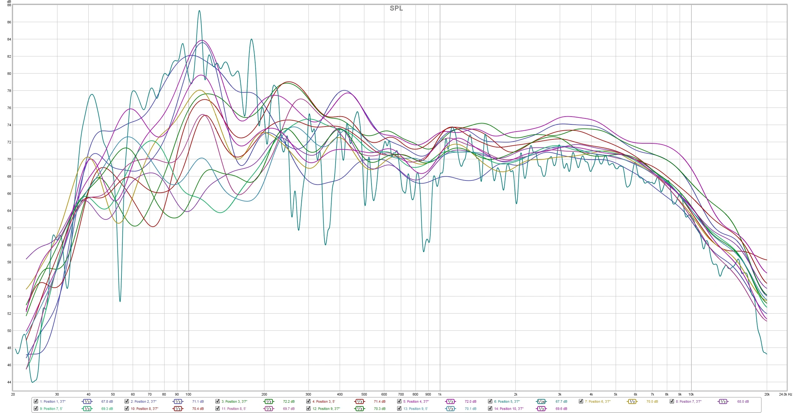

Now my task is to design acoustic treatment for this room. How do you recommend I approach this?
Thanks!

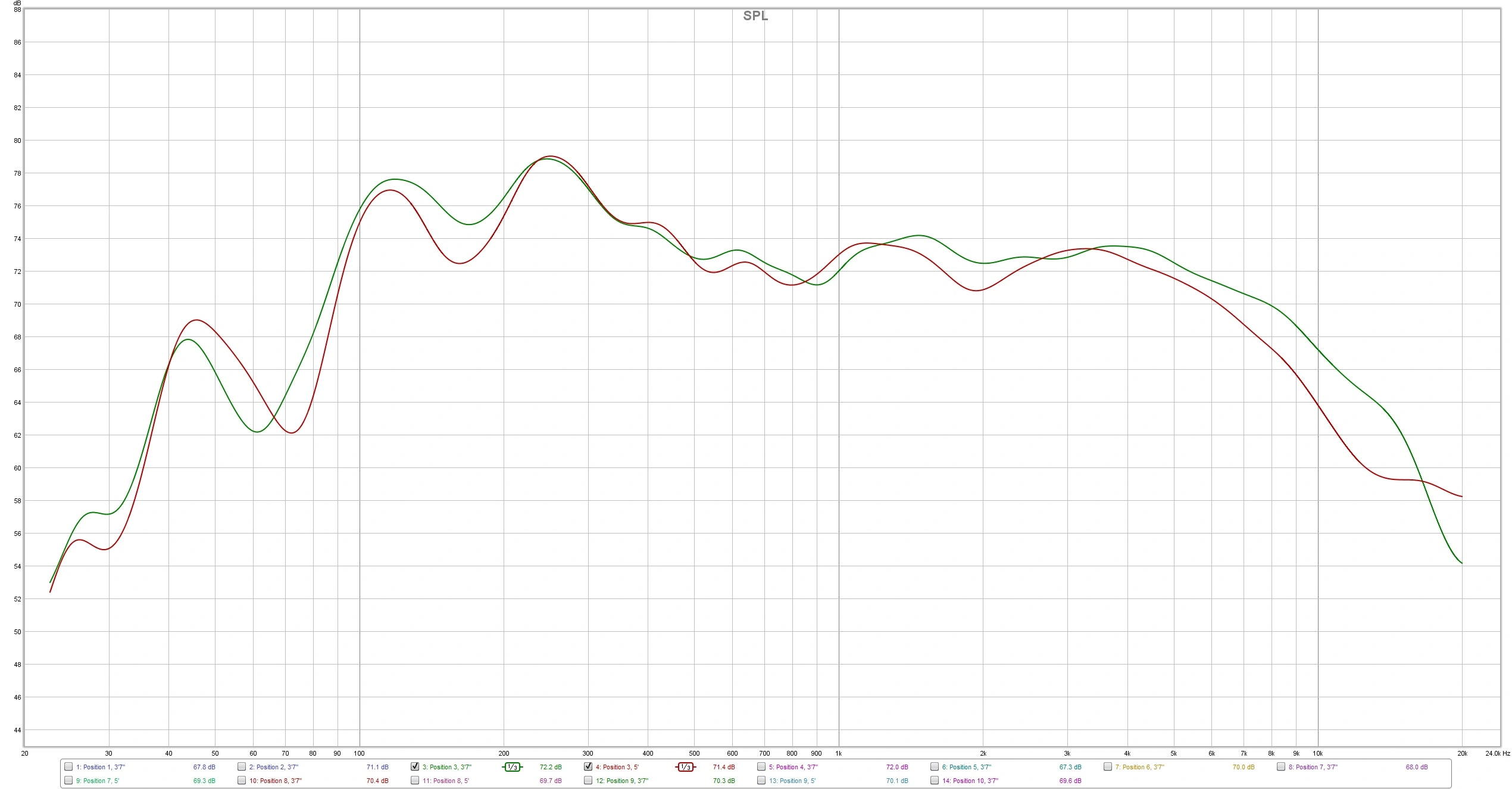

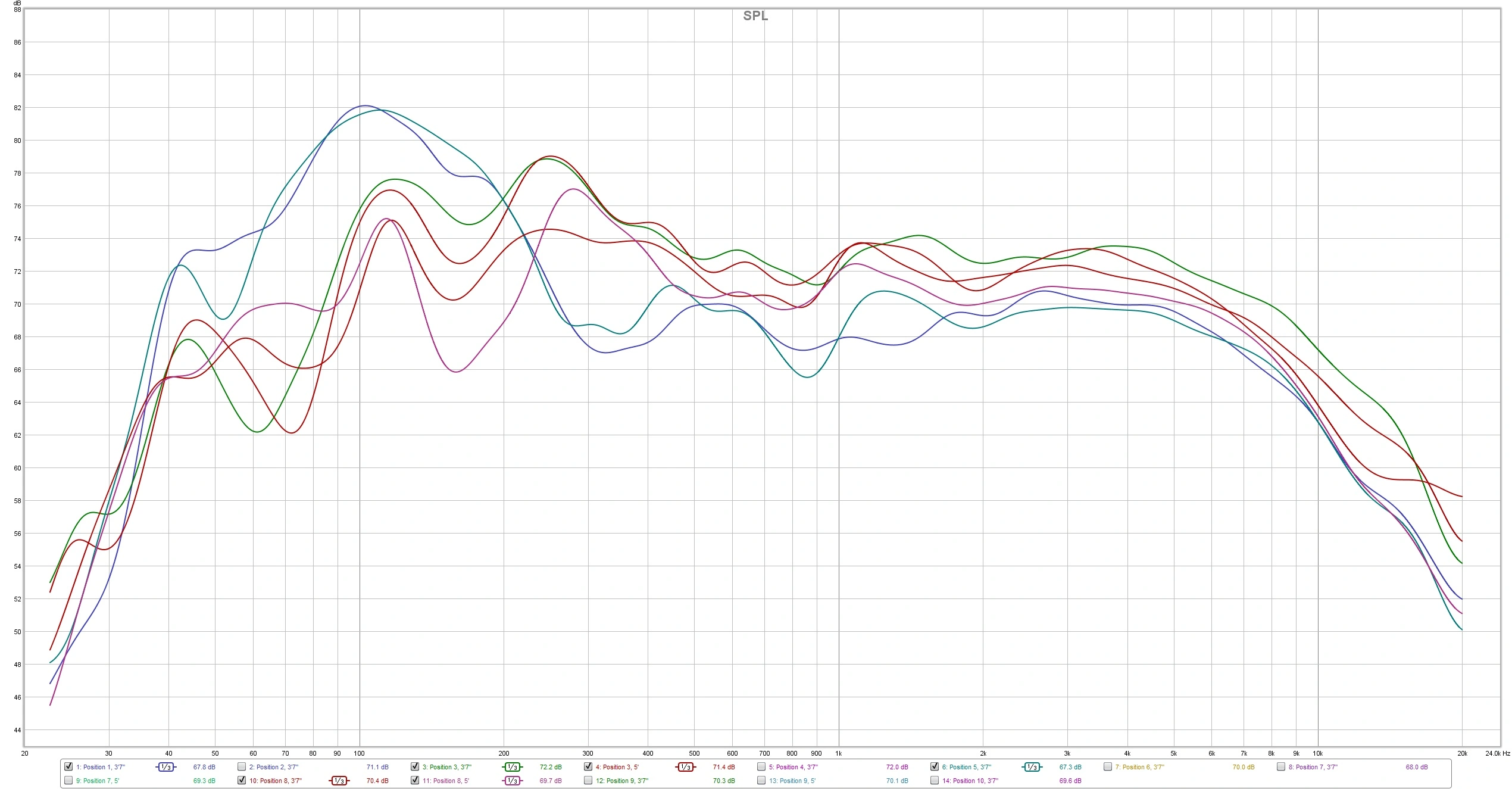

Are you recording with a mic at any point? If so, a couple of 4" thick x2'x4 rockwool gobos set up 'behind' the mic will help reduce reflections from your vocals or instrument off the front walls bouncing around and getting picked up by the mic. You've got precious little space to put any kind of acoustic treatment symmetrically in the room, and that desk is taking all your front wall's room - not leaving enough space in the corners for traps, and no good place to put your monitor speakers. It looks like the compromise was all your wife's way (but then isn't that always the case?!) Headphones are going to be your best option for monitoring/mixing at this point. SInce you won't be spending much on treatment, spend it on good headphones.
Well, it's going to be tough to do an optimal treatment, as [MENTION=39487]mjbphotos[/MENTION] points out, but I can think of a few things I'd do, remembering that you still want to dampen reflections overall and get some kind of bass traps in place, if it's permitted, that is.
You have one corner between the window and closet that you can put a floor to ceiling bass trap in, and I'd do that, built at least 6" thick with rockwool. And, while that 1' space on either side of the wall unit is small, I'd build something for that, floor to ceiling and fit in there, too. Angled panels above the wall unit and the opposite wall (ceiling-wall join) and clouds immediately over the mixing seat, and a couple of large-ish panels on both walls on each side of your chair, as symmetric as possible. Heavy, blocking drapes for the window that can be opened/closed, depending on the room usage will also help.
Then, a rug for the half of the room behind the chair would probably be a help.
The space where you have the monitors is not good, at least from the pictures, so I'd think about removing the doors on the upper part of the wall unit, and moving loose items up there (diffusors :)). Get something seriously heavy to put the monitors on to get the height better, and fill the space behind them with a cloth covered rockwool batt, trimmed to size.
Good luck getting the clouds and ceiling-wall angled panels approved...
Well, first things first. It's hard to tell from the pics, but I think the speakers are too low. Raise them so the tweeters are at or slightly above ear height.
One problem with a small room is that some distance from the speakers is beneficial because it sets things up for normal cross bleed levels. But in a small room the reflections start to become a problem if you get very far at all from the speakers.
In lieu of proper treatment I would open those top cabinet doors to break up that surface. And I'd open every other drawer by different amounts. Leaving the room and closet doors slightly ajar might also help scatter reflections. Get some nice looking heavy drapery for the window.
I agree with all said previously. The wall unit desk thing is definitely an issue. Can maybe get away with boosting the monitors up as high as they can in the cabinet space with something and also a decoupling material like the Mopads.
But I think you may be able to get away with the 'superchunk' thing there since the wall unit gives structure. In this situation I would fill both sides and top of the beast with Roxul 80 or OC 705 and wrap with cloth to start.
The side reflections really should be addressed as well. Agree that a super heavy curtain (or build a removable panel to fill the window space when mixing) for the window on the right side, and a 2'x4'x2" panel on the left. Cover that with a pretty breathable cloth of wife's choice and call it art. :)
And yeah, I can see the ceiling clouds being hard to approve... May have to just attempt a thick rug on the floor.
Do you own the home?

Coming from a scientific approach, I understand what I did with REW, but I don't know exactly what to do with the results.
1) Am I correct that taking measurements in 10 locations in the room was unnecessary, and the listening position is the only one of real value?
2) Or do you need to measure in the corners to solve issues in the corners?
3) In the results from my listening position measurements, am I correct in saying I should attempt to address the 40-400Hz range? What about the dip above 4kHz?
4) I didn't do any sort of node calculations for the room. Is that of value at this point? Does that mainly help one determine ideal locations for speaker, listener, and mic? Whereas mine are rather locked in by my furniture? Or is there some other value in calculating room modes?
5) Is it feasible that I can run calculations with a proposed treatment design to predict its effectiveness, or is guess-and-check about all we can do? (See B and C above!)

Measurement at your mixing spot is probably worthwhile, because it can point out obvious problems. Measurement elsewhere might help you identify where best to tackle the problems, but overall treatment with adequate bass trapping is probably worth doing first. Coverage (sqft) * absorbtion coefficient / room surface will show you how you are doing relative to some of those formal specs for studios, control rooms, etc. You need to be somewhere in that range. After that, ears and listening to your recordings along with input from experienced ears here may offer more guidance than graphs. (Graphs alone are misleading, e.g., what looks good on paper can still have too much reverberant content to be useful for recording some things.)

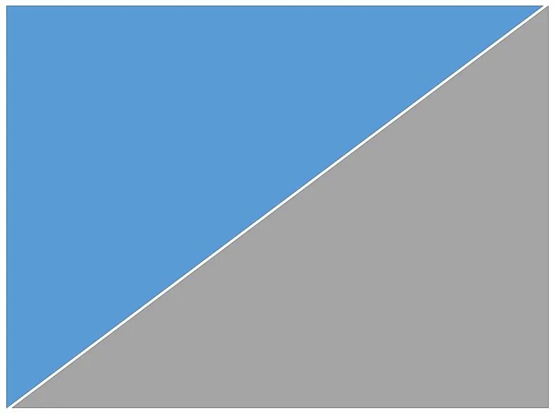

Phase 1A: "Superchunk" Surround for Desk Unit.
While most people appear to build their "Superchunk" traps as triangular prisms, I am going to build mine as freestanding rectangular prisms to fill in all the space up to flush with the upper part of the desk unit. I am going to build each of the sides as (3) stacked sections, 12"W x 15.75"D floor to ceiling. Since my readings indicate it is okay to have an airgap behind bass traps, I am going to build it to sit just inside the baseboards, with a resulting gap of 0.75" on the wall side and back. I am going to build the top section as (3) side-by-side sections 15.75"D x 17"H and flush with the side sections on either end. I am going to use 3" thick Roxul Safe'n'Sound because that is what was available locally.
QUESTION 1: I am thinking to make my rectangular prisms actually (2) nested triangular prisms, as shown in the picture below. It will be the same amount of insulation, a little more lumber and definitely more fabric, but it will give me the following significant benefit: my recording rig is portable and triangular prisms would be more useful than rectangular prisms if I take my rig elsewhere for tracking. They will have to be scalene triangles, rather than right isosceles triangles. Can anyone tell me why this would NOT be a good idea?
Once you have a trap that's 8' in height, you may wonder if moving it around is actually a good idea!
I actually built my corner traps with double layers of Safe'n'Sound and found out when I tried to stack 2 4' panels - didn't build them to 8' - that it was not possible to actually fit them into an 8' ceiling without a lot of scraping. So, I used the 4' pieces on the bottom, and made the top half about 1" shorter so I could assemble them in the room. I wrapped some egg-crate packing foam in cloth and wedged that in to the top, after fastening the top and bottoms together, to keep everything tight. It's not something you want toppling over!
The fabric and lumber make up a good part of the cost, so I wouldn't build them the way you plan unless you're sure you'll be using those in the way you describe. For not much more money you could just build the corner traps as single units and build some more moveable ones that would be easier to move around, and perhaps be usable in that space, as well. Depends on how much mobile work you'd plan to do, I suppose, or if you just want to plan ahead to when you'll be in a different space, and make something less custom fit for the room you're in now.

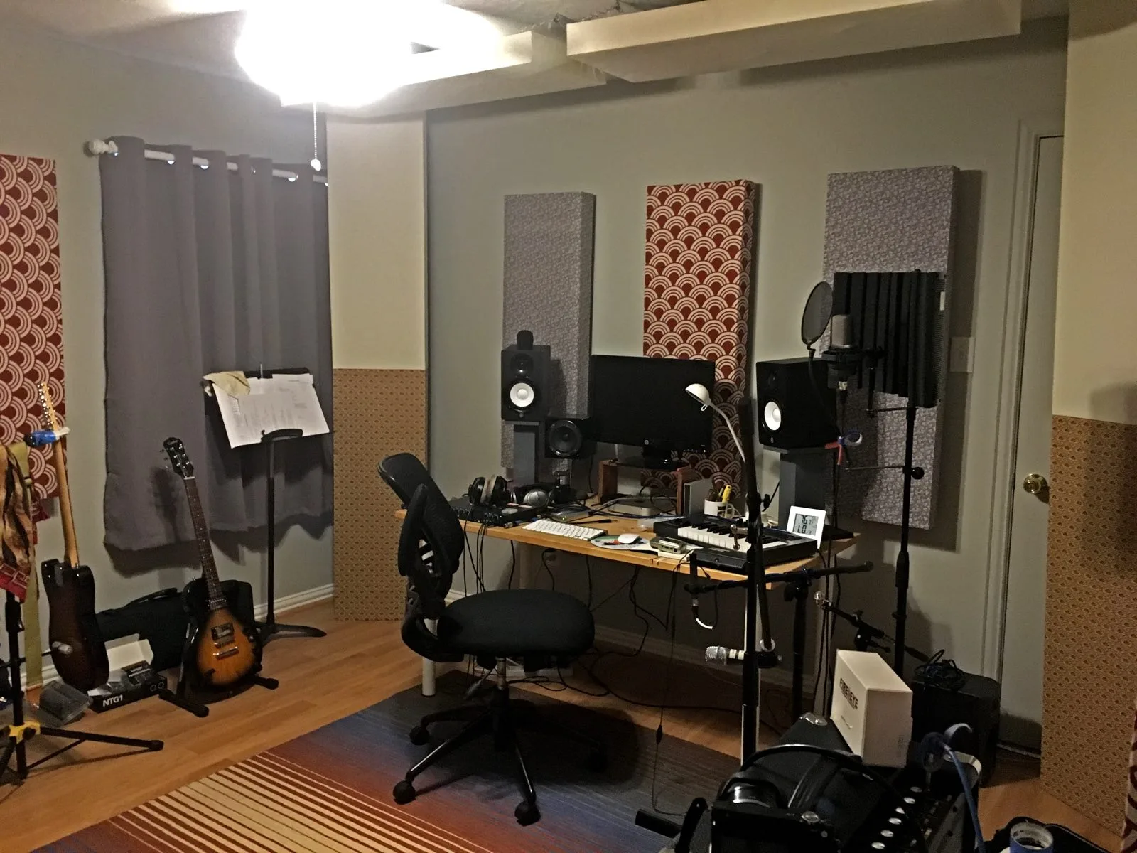

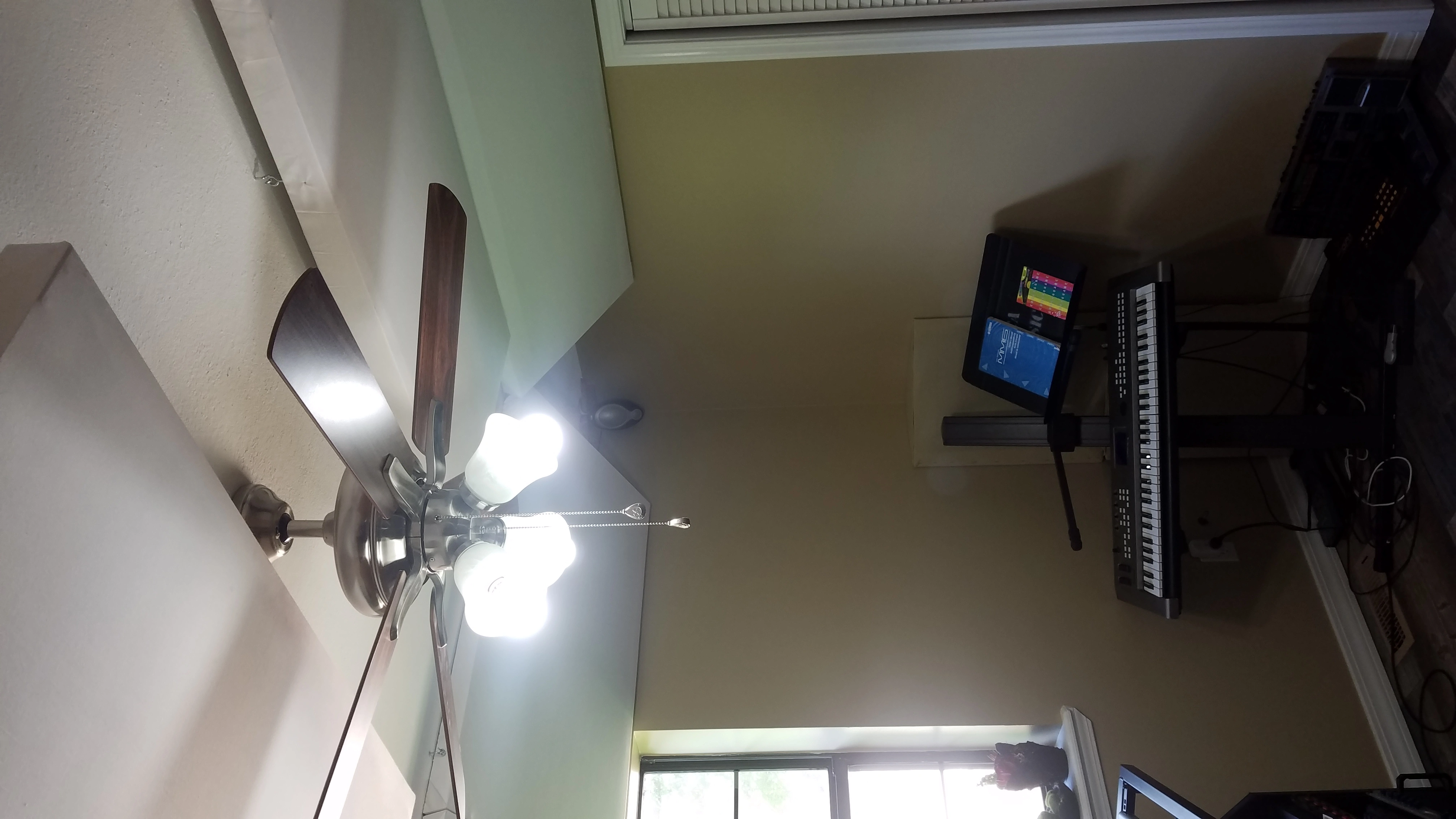

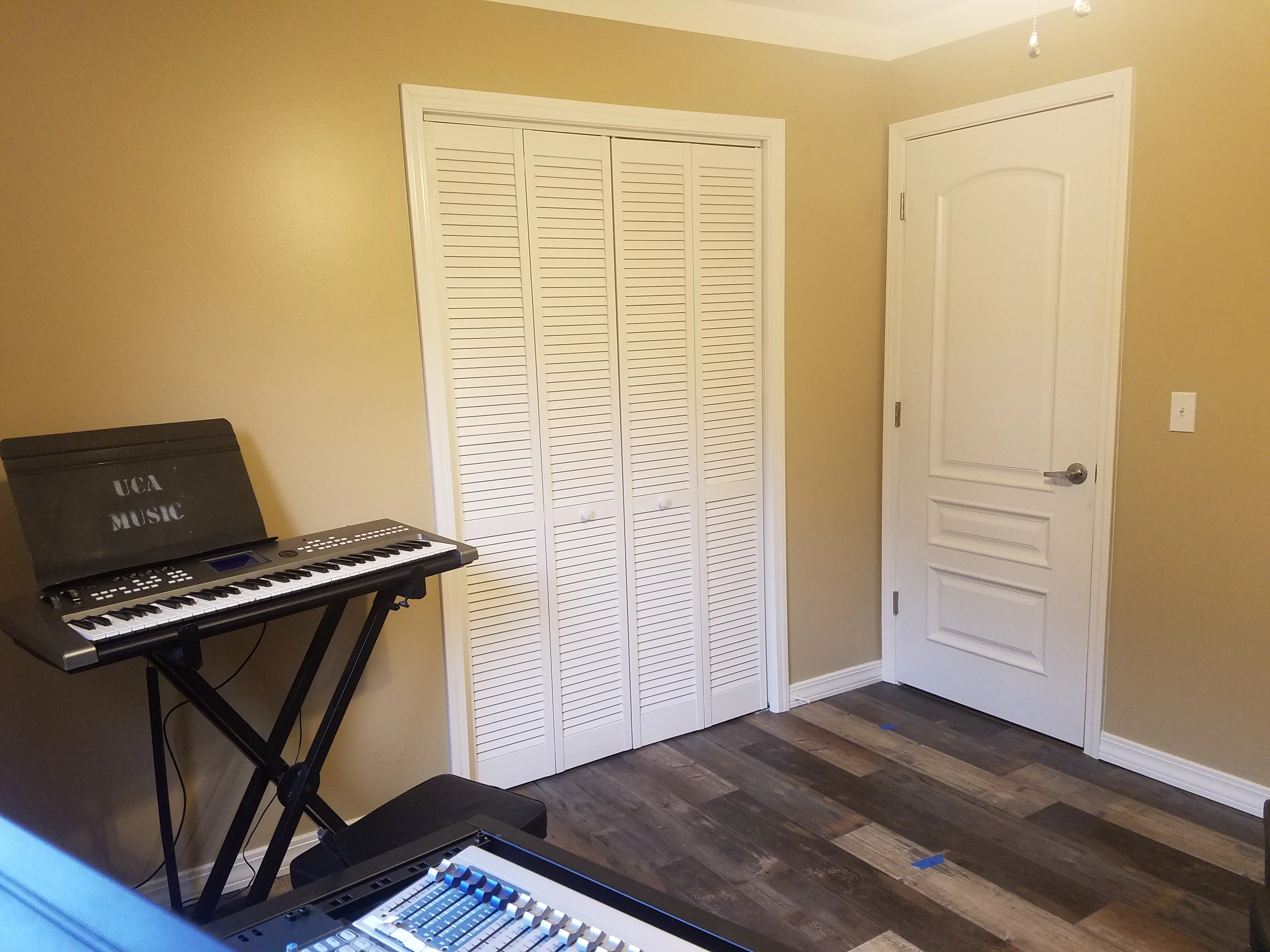

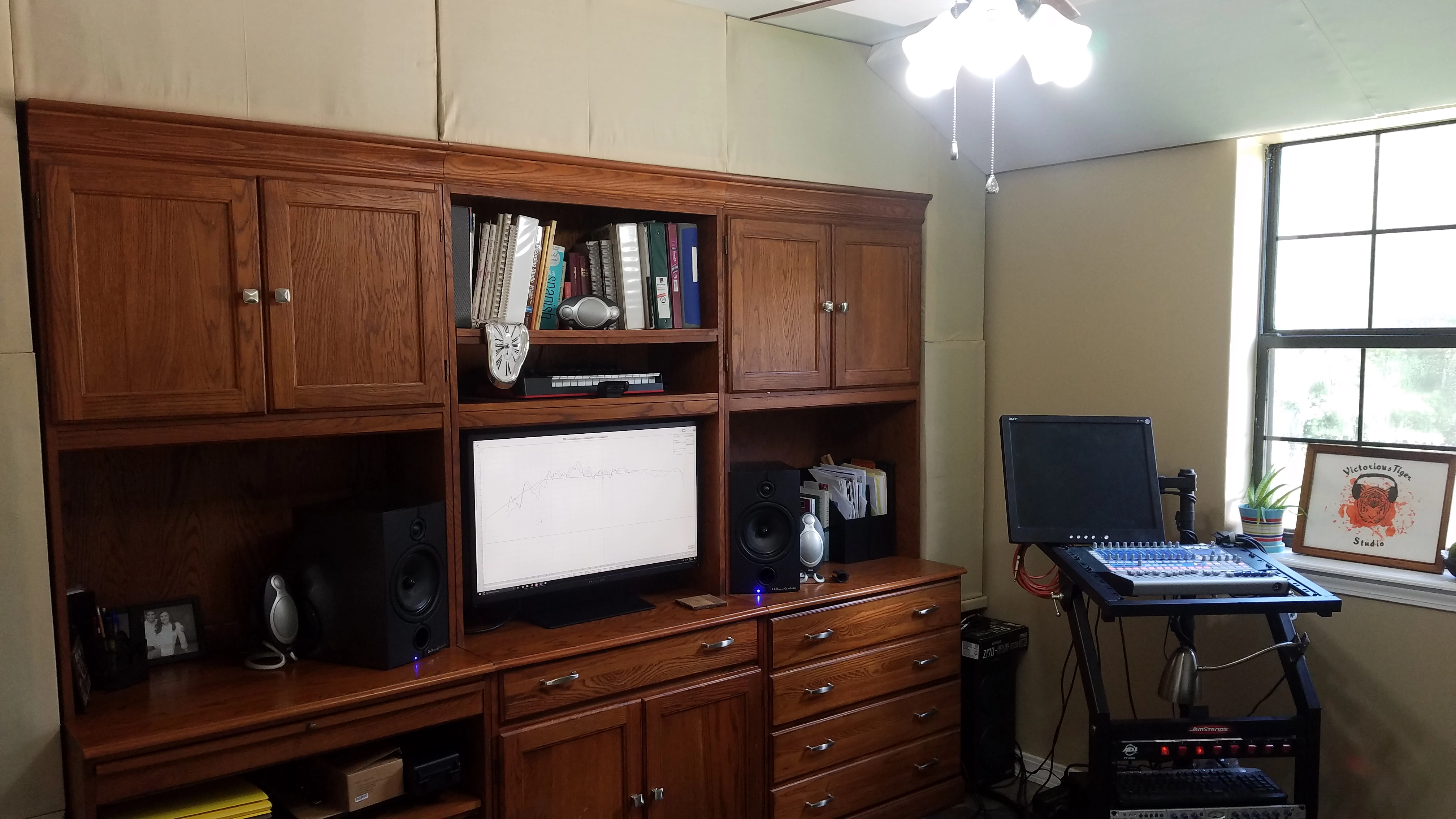

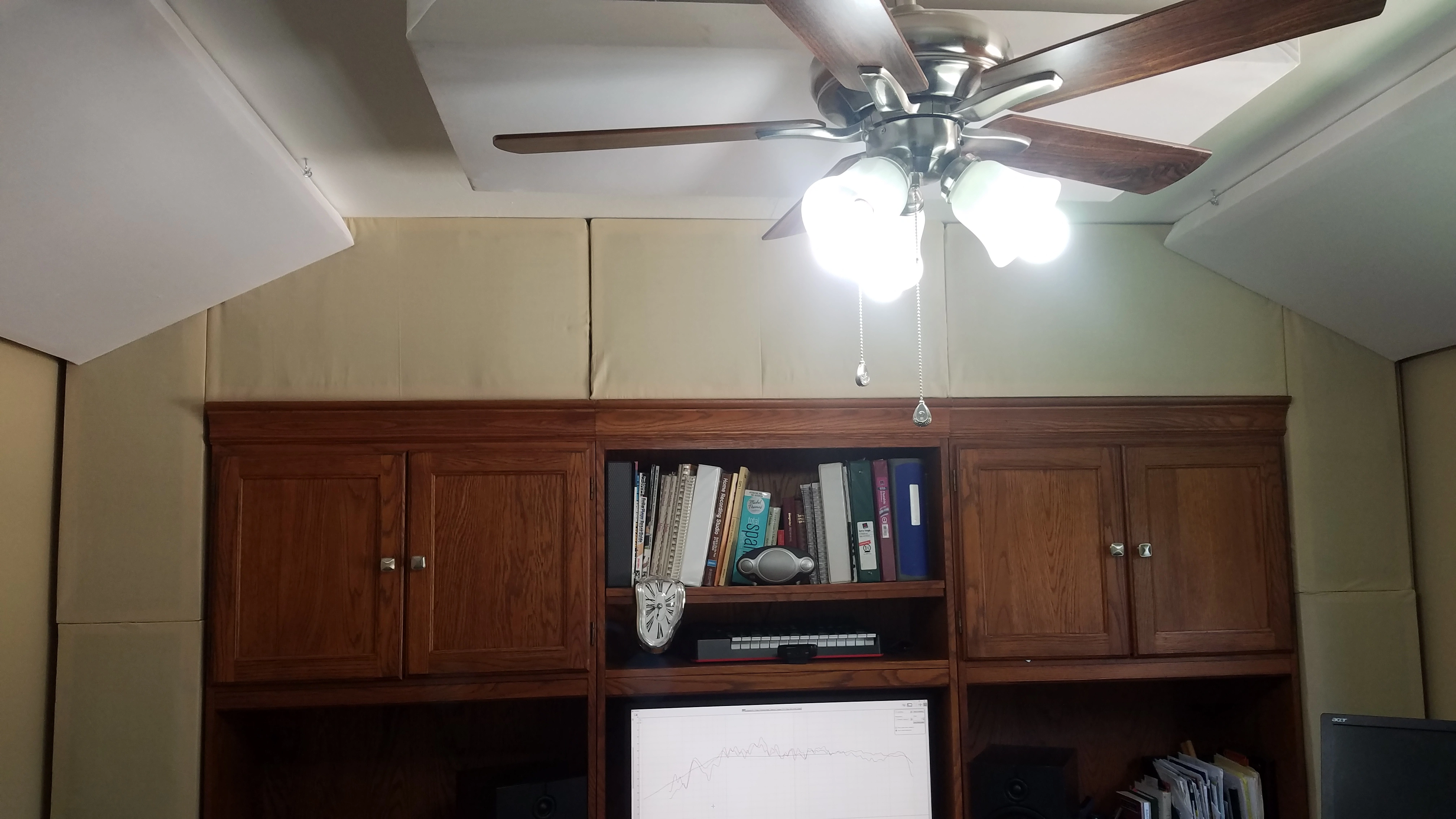

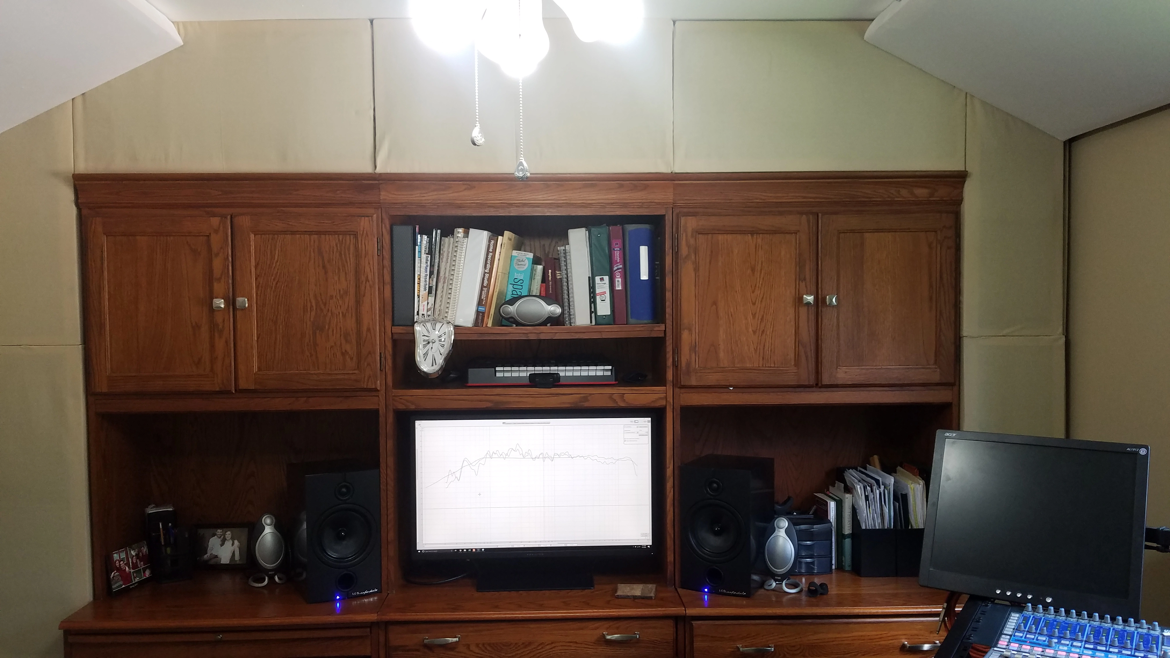

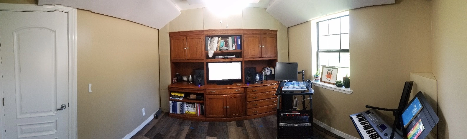

Studio build update!
So I have completed several phases of my acoustic treatment project and have pictures and results to share, for comment and advice going forward.
I have completed:
Phase 1B: Insulation Panels for Wall-Ceiling Corners.
Phase 3: Treat the Ceiling.
I still lack:
Phase 2: Treat the Walls.
Phase 4: Treat the Cabinet Space Behind the Monitors.
Phase 6: Isolate the monitors
Here's a picture.

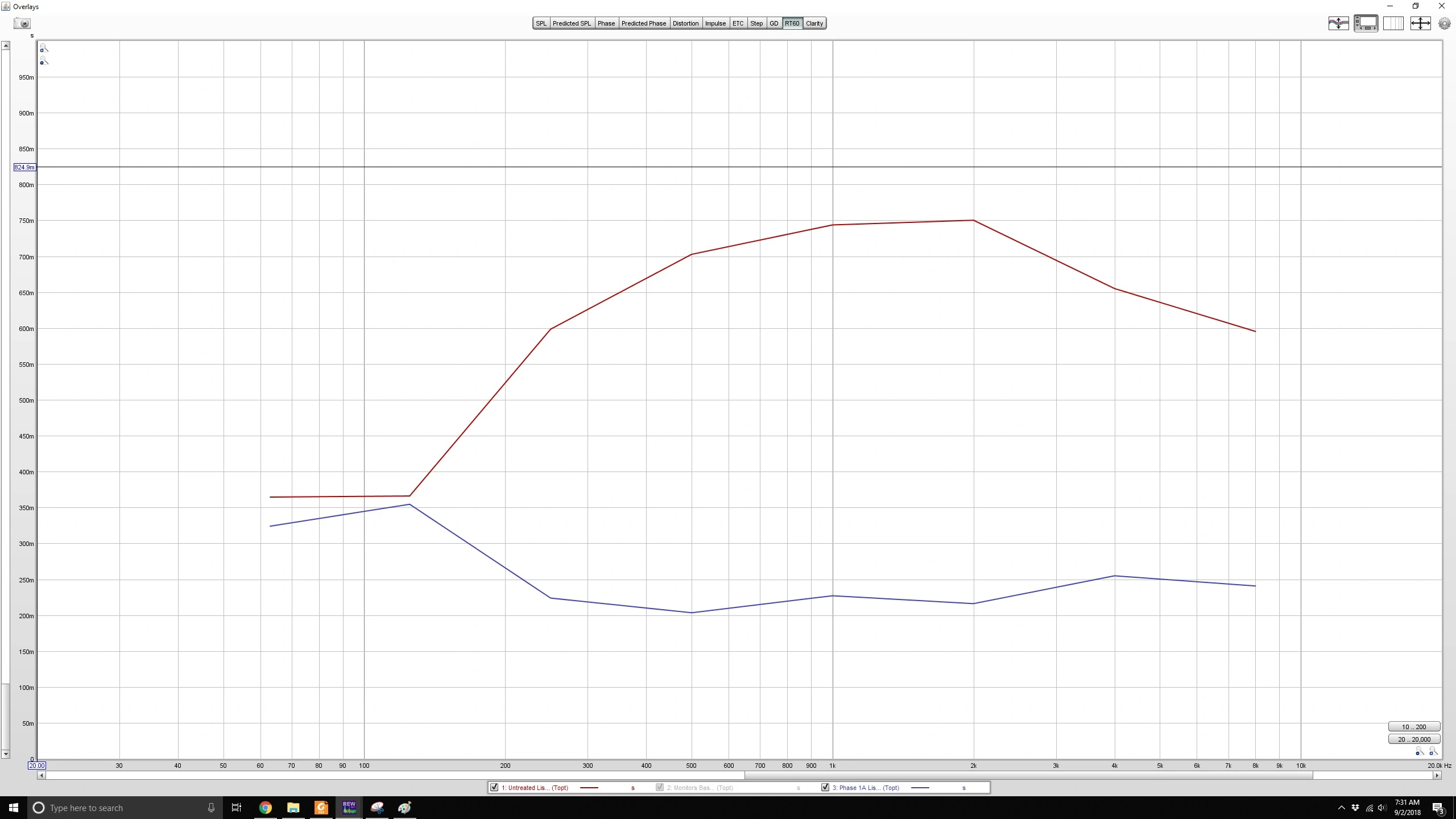

Here's before and after frequency response from REW (Red is before, blue is after, green is my monitor's characteristics).
Most notable improvements were in the 20-30Hz and 50-80H regions.
I still have issues in the range of 40Hz, and 200-300Hz is worse after than before, so I'm thinking those should be my focus now.

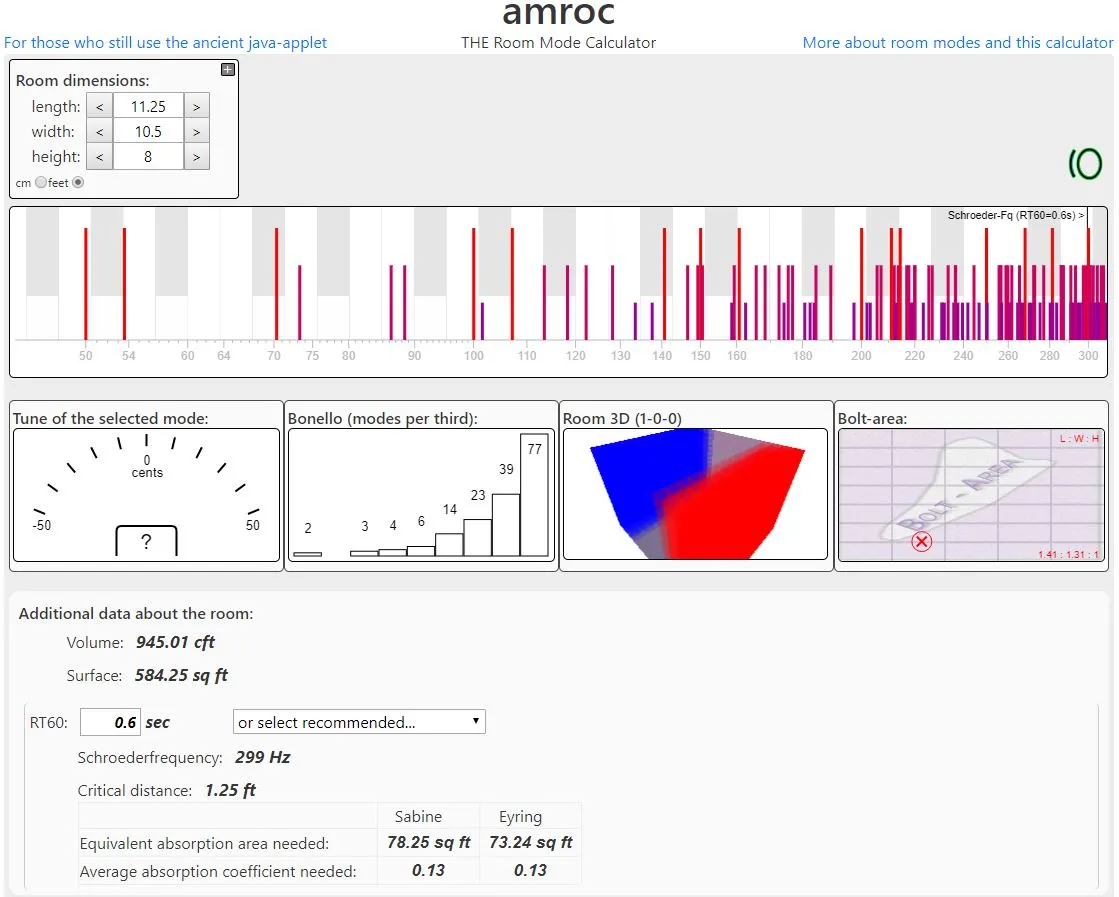

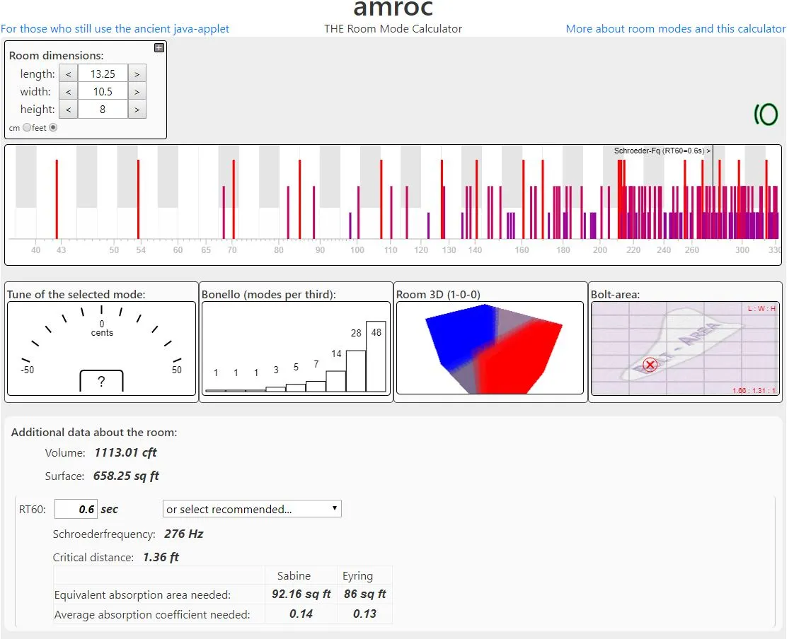

I spent some time with the really cool amroc room mode calculator, and it looks like the 40Hz mode corresponds to the depth of my room with the closet. And as I understand it, the 200-300Hz is getting into the broadband region.

The room definitely sounds dramatically different. Quieter. It takes more effort to be loud.

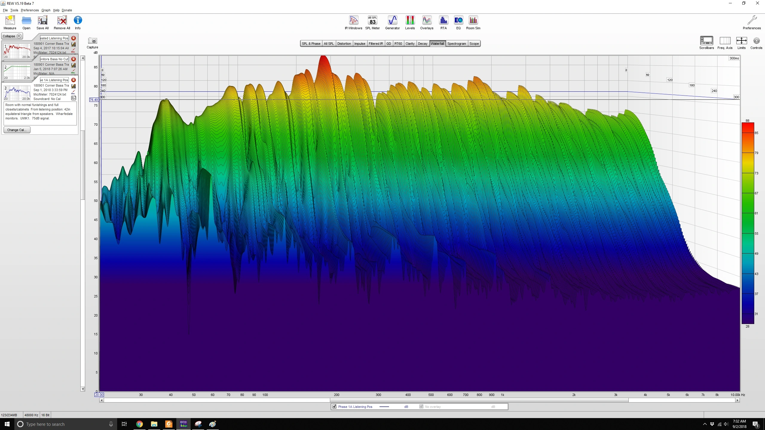

Here's a waterfall graph. I don't know what to do with it, but it's pretty.
Any comments are welcome! I will post my specific questions for going forward in a seperate post.

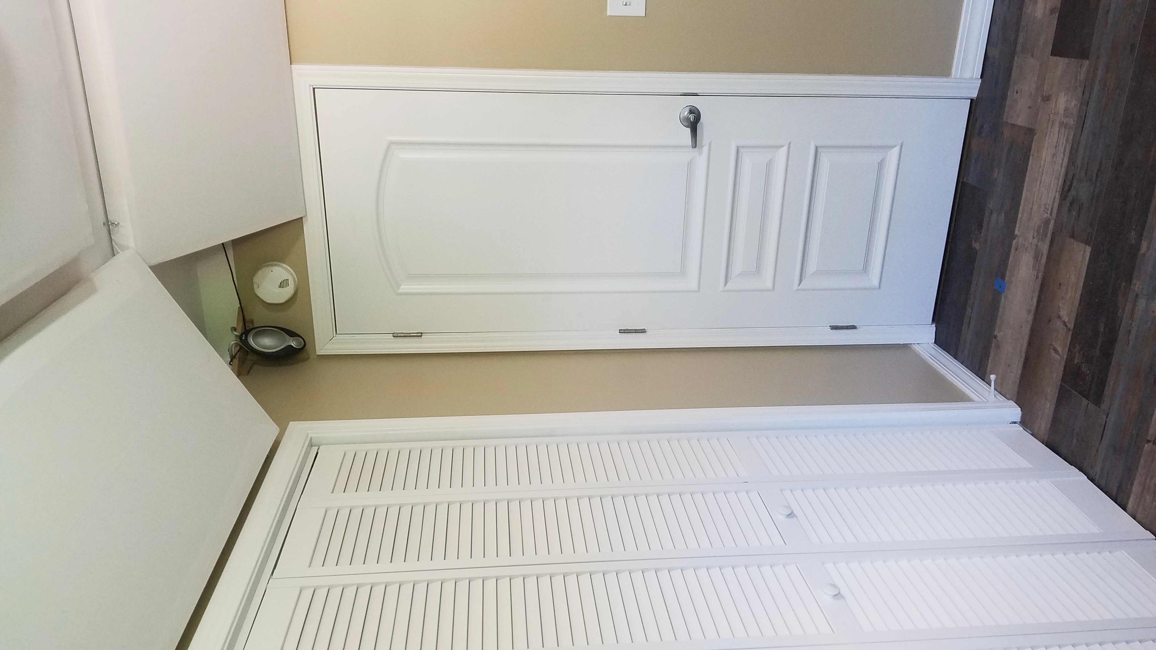

Here are more pictures of the room.
The math says I have the following treatment coverages on each surface:
Ceiling: 65%
Front Wall: 34%
Left Wall: 22%
Right Wall: 27%
Back Wall: 8%
Floor: 0%
So my big question is primarily about Phase 2: Treat the Walls.
Question 1: Location
Clearly I need to treat the first reflections on the left and right side. The, just based solely on wall space, I was thinking (2) 2' x 4' panels on the left wall, (2) on the right wall (one on either side of the window), and (1) on the back wall. I will also get a heavy curtain for the window. I feel like the back wall needs more treatment, especially with the 40Hz node that seems to be related to the closed, but I'm not sure how to treat the closet space or closet door.
Thoughts?
Question 2: Material
If you hadn't already noticed, my OP about this room was in December. My original analysis of the untreated room was exactly a year ago. I am moving very slowly, and it hurts. Also, I changed jobs, and now work from home so this room's dual purpose is now my home office. This both slows me down, AND makes me more motivated to finish, since I live in this room 8+ hours a day.
I am thinking I need at least (5) 2' x 4' wall panels. I could make them myself, but I move so slowly at that, and I am ready to have this done. I HAD to do the desk surround myself, since it was so custom, but I am thinking commercial products for the wall treatment now. A rough calculation says it costs me in materials alone about 50% of what this ACOUSTIMAC DMD-BT4000 BASS TRAPS 48"X24"X4" costs. My time has become very precious to me, so I am about to just bite the bullet and order these.
What do you think? Is there a better value product out there?

Those prices are pretty good. Yes, you'd be at least 50% doing it yourself, and I'd say probably more like 30% of those current (sale?) prices, depending on the fabric, largely. But, not a bad option.
I'd get the 6" deep ones and stack a pair floor to ceiling in all the corners you can for good bass trapping. Then, minimally, a couple of maybe just 2" ones at early reflection points beside and above your mixing position, and then some more on the end of the room.
