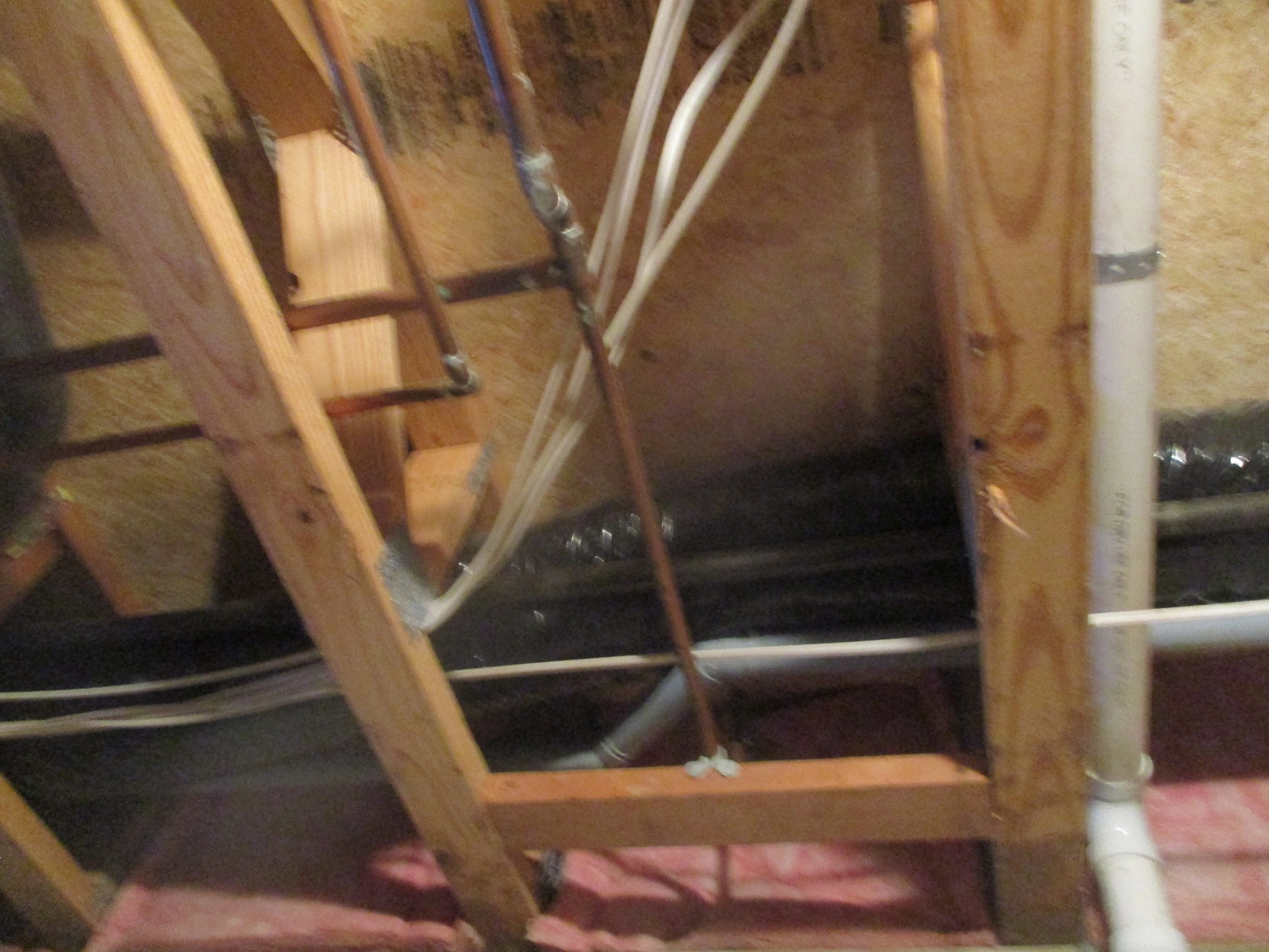

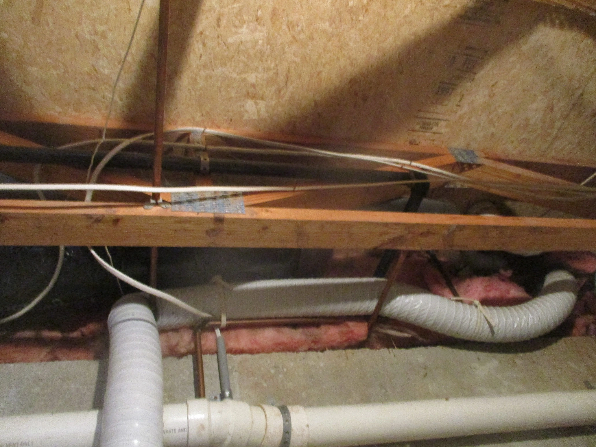

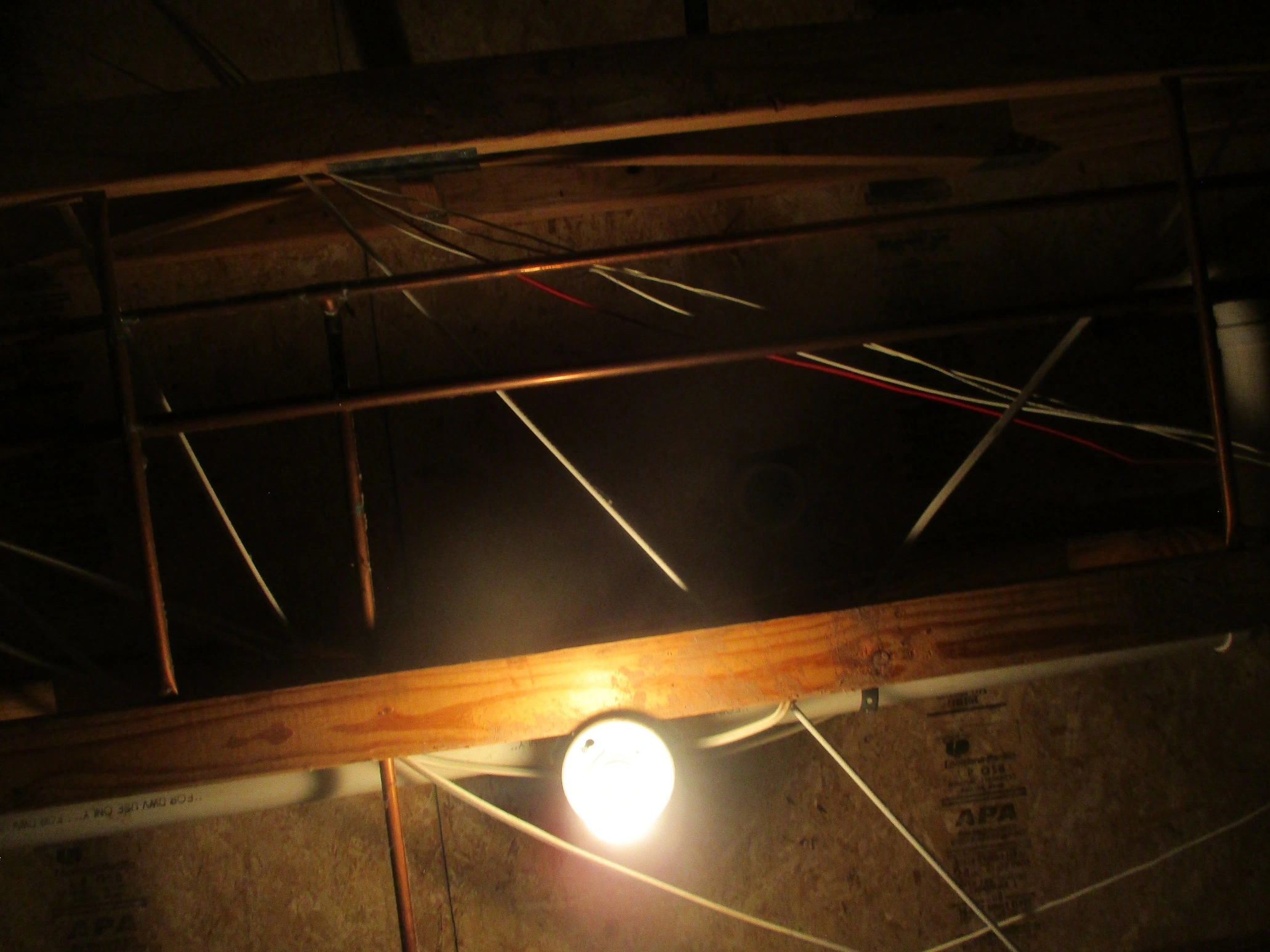

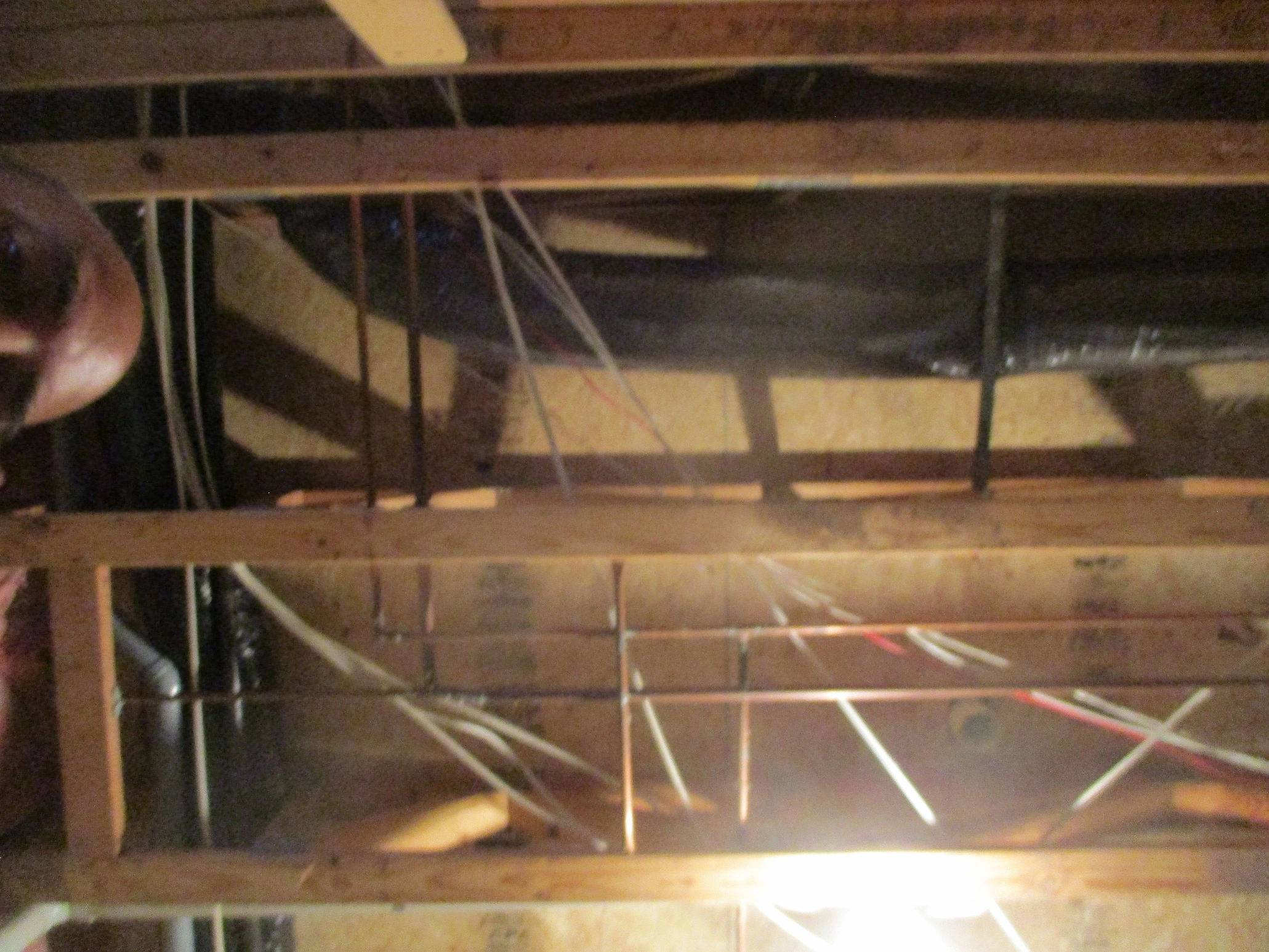

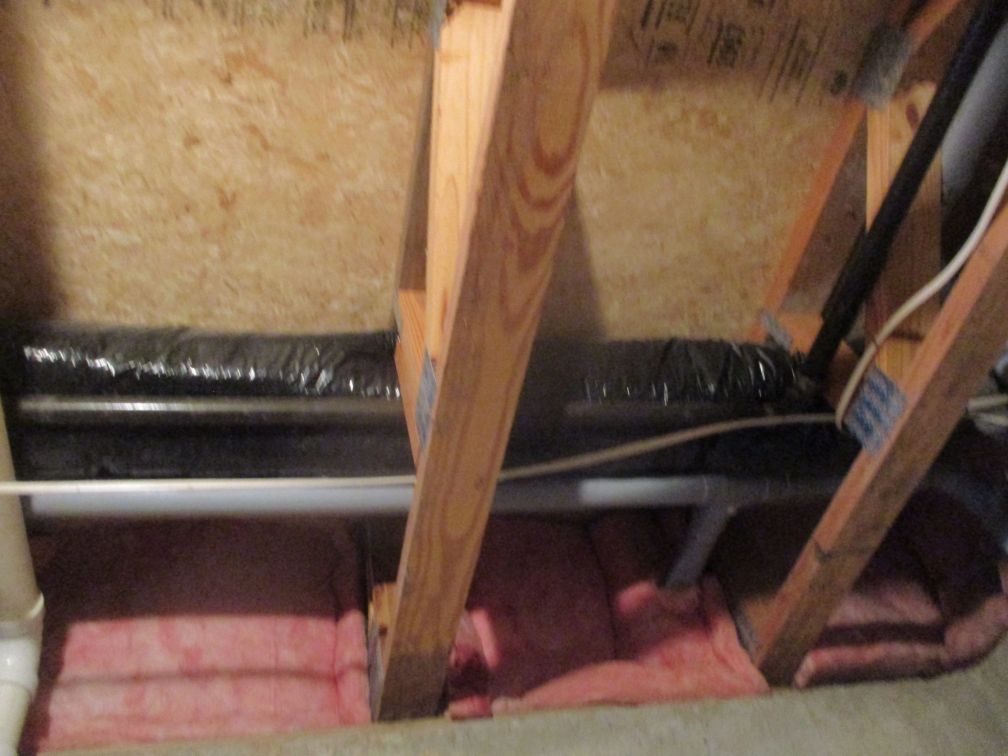

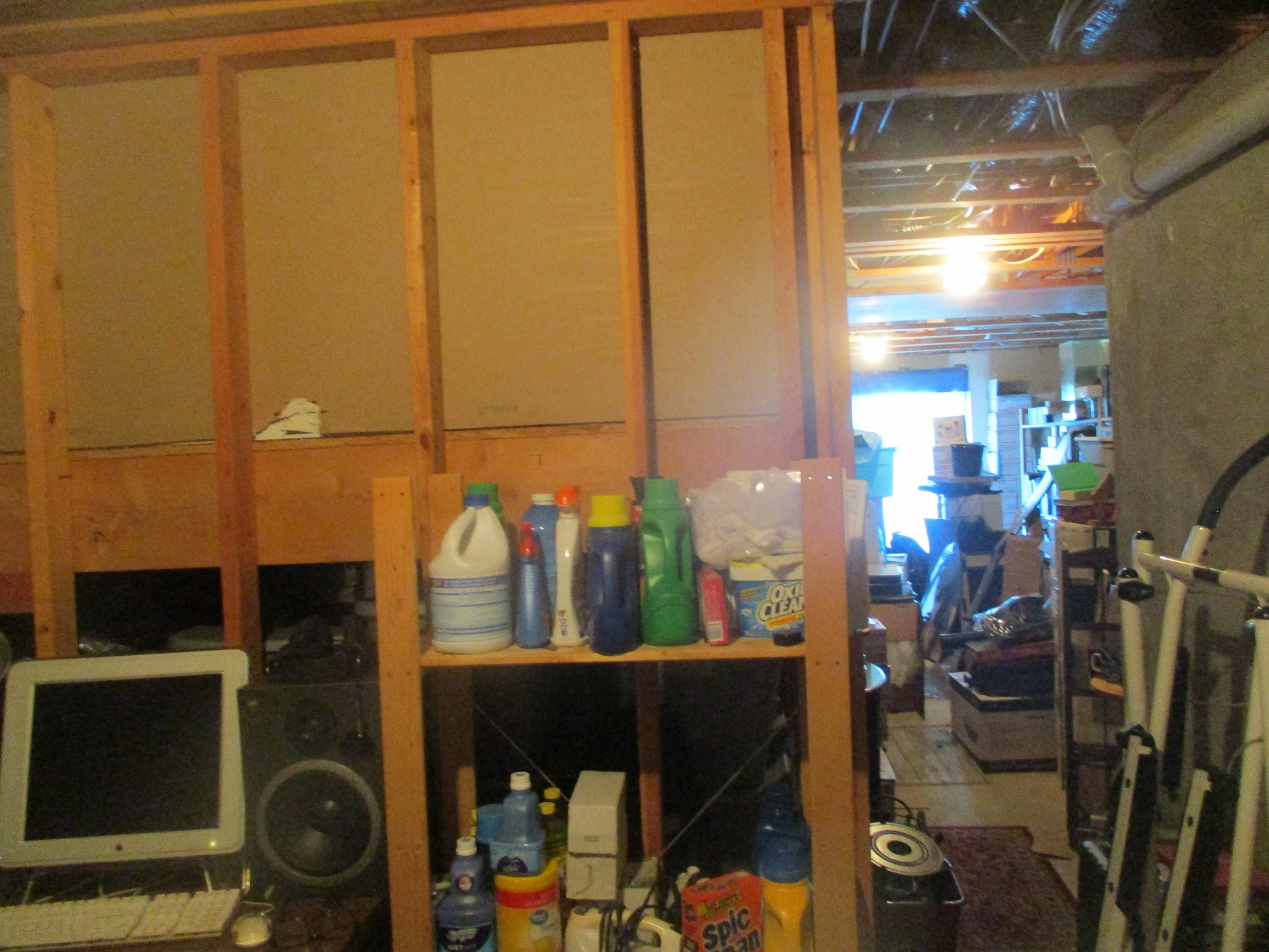

The problem throughout the basement is the wiring, tubing and crap going throughout the ceiling. I want to use the Rockwool Safe and Sound, but don't know how to put it up over the multitude of shit up there now. Here are some photos.
Looking at these photos. Can anyone possibly explain how to put the rockwool in? There are numerous problems - the wiring and pipes are the biggest. The tubing I think you just cut out the rockwool to fit over and under it. But, I'm not absolutely sure. Rockwool has never responded to any of my questions. The last photo is the only wall I need to rockwool. That's the stairway. The doorway would go in the opening. Yes, all the laundry detergent and stuff will be moved. It shouldn't cost much to soundproof this space, if I can soundproof the ceiling.
I put a little boom box on. It was on 4 out of 10. I could hear the music when I stood in our foyer. But, there's only a piece of pressed wood separating the floors. TH's are made of crap.
Thanks in advance.

The only insulation you can put in there is a granular type but from the top onto an installed basement ceiling. The other way is small pieces of thermal fibreglass insulation stuffed in off a step ladder which will take you forever. Even then it is thermal insulation and not acoustic insulation. For that you would need to install a false ceiling and also add acoustic insulation from below. Again taking forever and the weight may be an issue.
Then there is pumped foam. Is it allowed over wiring and has it any acoustic properties?
If it were my place I would seriously only attempt that from above.
Are they really floor joists you have there?

Wow, there are some serious code violations happening there with the wiring all over the place. How tall is the ceiling - can you add a drop ceiling? BTW, Safe and Sound is not going to "soundproof' the space.

Ii would group the wiring and probably put them in PVC Conduit - then clean up all your other Code Violations you have in there - after you clean up the wiring and piping you can put whatever insulation you want.
This TH was built in 1997 and it passed all inspections. It's one of the first in the neighborhood. My wife's mom had nothing done. Maybe PA has lighter regulations than everywhere else. I look at it, and I think it's a huge mess. Apparently not for PA.
This TH passed inspections with the wiring exactly the way it is. Go figure.

Snowman is there anyway you can clear a decent space down there and build a box? A box being a room which could be your studio. It may only be as big as a bathroom or possibly the size of a bedroom. But at least then you could insulate this straight forward shape very easily and job done. If you could get a space like that down there, even if you may lose a bit off the height to the ceiling, it would be very simple to do and then you wouldn't have to think about stuffing insulation between those ceiling joists in that maze of cable and piping.

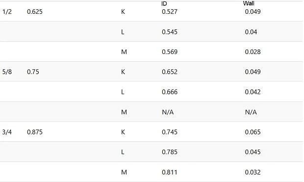

Snowman obviously has copper supply lines. I'm guessing that being the economy minded builders, they used M thickness pipes.
017-jpg.119511
When I replaced mine, I insisted that they increase to L gauge, which was more costly but is thicker walled. I figured if it lasted 50 years with M, it would outlast me with the L type. At that point, I wasn't comfortable with PEX on the supply side. Not sure I am still....
