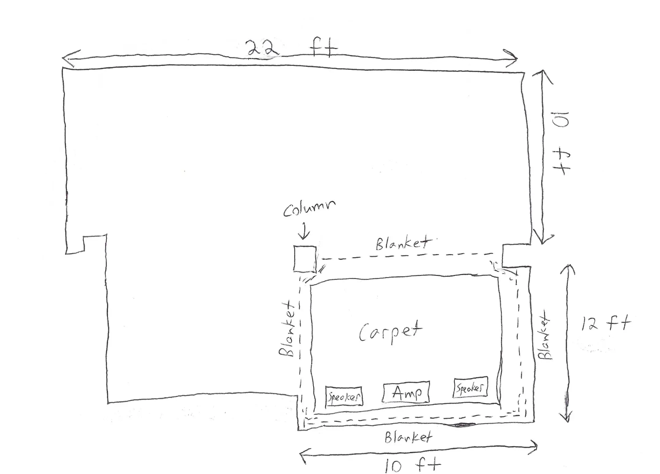

If only sharing ceiling with neighbor, is it best to focus most energy on treating ceiling?

Mass is what stops sounds - and you can't insulate enough to stop the sound from going through the Floor.
But will that matter if the ceiling is what I'm worried about? I don't share the floor or any of the walls with any neighbor. It's only the ceiling.
Basically the ceiling when the sound waves hit it becomes a large vibrating membrane transferring mostly the bass frequencies through to the upper floor. By putting a false ceiling with a uncoupled gap between you and the real ceiling, the vibration happens in the false ceiling and can’t transfer well through the air gap to the real ceiling therefore reducing the noise. I did a room inside a room when I built my studio. You can still hear the band but much quieter. There is no easy fix for sound proofing.

It would be easy to test out one of those DIY booths. Simply put your guitar amp in there, turn it up to normal volume, and see if you can still hear it. You can even open up the booth, measure the sound level, and then "close it" and see how much attenuation you get. A lot will depend on how loud you play your guitar. A Marshall cranked to 10 won't stand a chance. a 5 watt Champ that isn't turned up won't be any problem.
You might want to have your neighbor listen to see how much sound you are needing to attenuate.
That's the point - unless you get Mass between you and your Neighbors it's going to come through.
