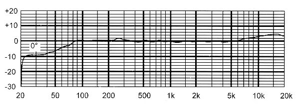

Oh, and I don't usually hang out in the mic forum because it's like a freaking warzone, so I'm not up on what everybody's saying about the latest chinese mic, but I looked up the graph (frequency response curve) for that mxl 990, and it looks flatter in the mids than I thought...there does seem to be a weird bump around 300 Hz though...(the "warmth," I guess). You might try EQ'ing that out of your vocal track.

I was actually just removing at 250 hz, I guess while you were posting, so that makes sense. thanks again.
