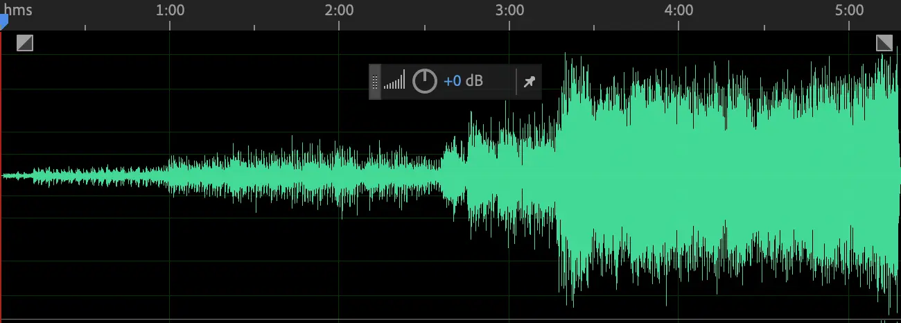

It's just genre - if you look at this one it looks totally wrong, but is a piece of popular classical music - but if you look at electronic dance music - it's virtually a flat line from end to end. The only problem with compression is that people are told that you MUST use it and it MUST be loud, and if you have anything leaping out or needing bringing up that is WRONG. Those kinds of rules are made for breaking. Look at the famous dance hit people and you often see there are multiple version - some with quiet bits but the one for the clubs needs to be mixable with the next and previous tracks.

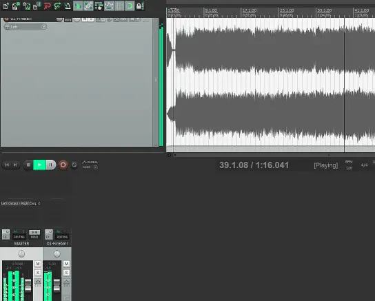

On the other hand, if you look at a lot of metal, it's generally compressed to the max. That's the desired sound, with the crunching guitars, a pretty steady barrage of bass, and usually a pretty constant drum beat as well. It will often look like this:
