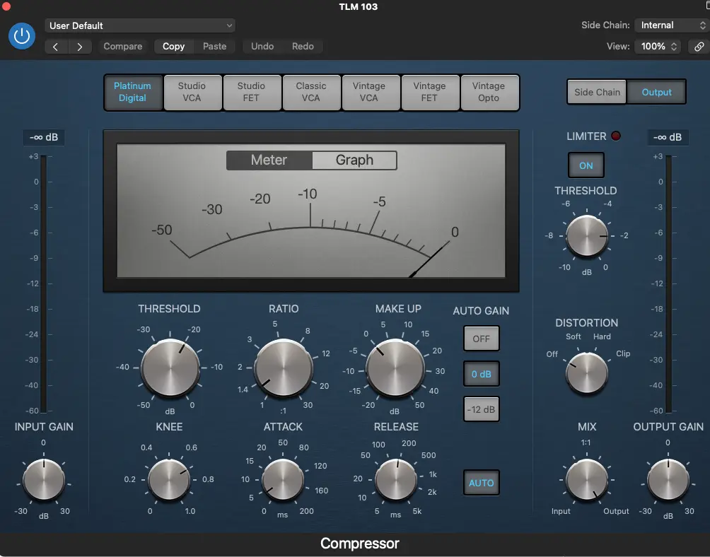

Compressors -You compress the volume by a Ratio amount - 1.5:1 or 3:1 means that whatever comes in gets compressed down by the first number - 3:1 means whatever comes in at 1db will be compressed by 3 db - the speed in which it compresses is set by the Attack (fast to slow) - how long it compresses is set by the Release (fast to slow) - Knee is how fast (Hard) or slow (Slow) the compressors reacts at the threshold - then you use Make Up to compensate for the loss of volume - which when you’re using low compression ratios it might be 1db - 3 db - but when smashing snare drums or something might be 10 db -

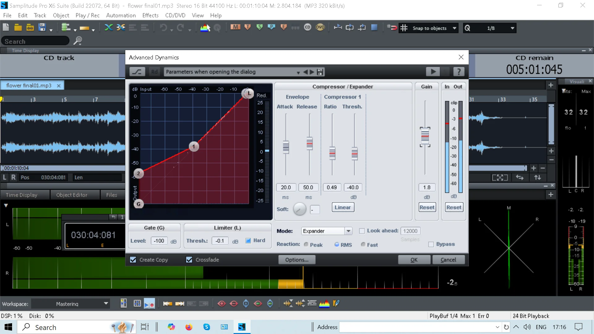

Compressors don't make quiet parts louder, you need an Expander for that. Piccy is the one in Samplitude ProX 6. I am sure there will be one in Reaper and probably Audacity.
In hardware terms there is really no difference between a compressor and an expander, it just really depends what you "tell" the gain changing element* to do!
Put them both together and you have a "Compander" beloved in the (awful!) days of tape recording because of its pitifully poor dynamic range (sorry Mr Beats!) Now we can have 100dB for less than a nifty, companders are rarely seen. The DBX company made their name with the most common one but they have moved on to other, better things.
