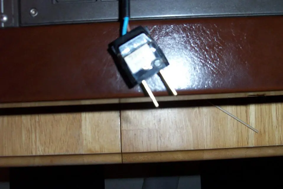

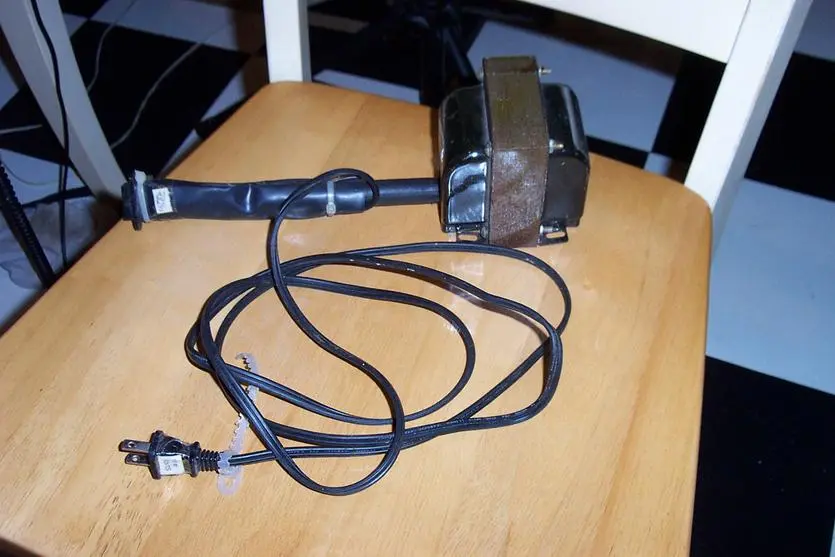

My 388 is from the UK.When I went to buy it the guy pulled out this horrible looking power converter thingy made up from an old transformer.It almost made me change my mind about buying this thing,but I had to have it.My question is...can I buy a commercial store bought convertor for this because Im scared to touch this thing sometimes.Looks like a homemade bomb!
It powers up the 388 just fine,and there is no noise or humming,but I would rather have a nice new one.The plug from the 388 looks like a standard N.American plug not the bigger sized ones from the UK.It has a sticker on it that says 220v.Im posting a picture of this monstrosity.Where can I buy me a "real" one.
