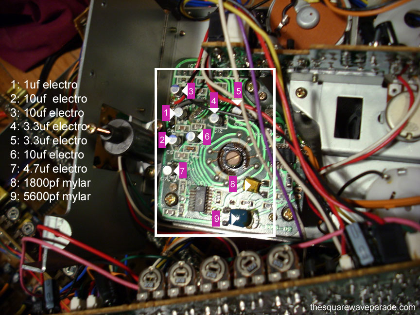

I have a 238 with a highspeed running capstan motor, . I have read that it 99% is fixable by changing some components on the motor board? Any tips?
Below, same basic Tascam motor from the MK deck series, same issue..
http://thesquarewaveparade.com/tascam122.html
"there is a common problem with the tascam 122mkii (and other mk's) , after a certain age the motors start running really frigging fast, to the point of being completely useless. anyone that has ever had this issue has more then likely contacted tascam and received a replay saying that a motor replacement will cost over $80. ridiculous, but some people have done it several times because this is a really nice deck. others have just pitched them out or sold them cheap ($10 off of craigslist a long time ago) that think they can figure out what’s wrong with them. i've searched and asked but never found a single person that could tell me what's actually wrong with these things. clearly the motor is not toast or if would not work at all or it would work erratically or something. so a while later and several leaps forward in electronics knowledge i understood that the motor is actually controlled by pulse width modulation, ahhh... there is an oscillator that tells it how fast to go, and nearly ever oscillator i know of is dependant on a capacitor to determine its range. well some old caps fail after about 20 years of constant use, give or take, and most fail closed, meaning their capacitance will diminish to the point of them becoming the equivalent of a jumper (often causing problems shorting the rails to ground in the power section of older gear too). when the caps capacitance begins to decrease in value it will force the pitch / rate to increase causing the motor to speed up. soooo.... if you replace the timing cap (or caps in this case) it will theoretically restore the motors speed control to the factory rate and kill the chipmunks living in your wonderful and at one point incredibly expensive tape deck. "

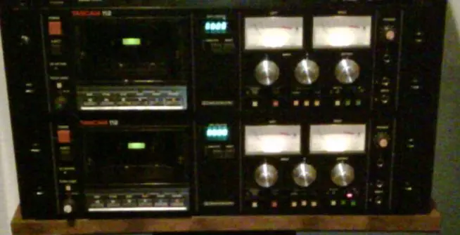

I have inquired in the past about a speed issue on my Tascam 112 cassette deck, and never gotten any info. It runs maybe 10% fast, but if I turn on the Varispeed, it spools up like crazy. Is this possibly the same sort of circuitry issue??

"when the caps capacitance begins to decrease in value it will force the pitch / rate to increase causing the motor to speed up. soooo.... if you replace the timing cap (or caps in this case) it will theoretically restore the motors speed control to the factory rate"

Now all I need is a schematic on the 112 .......not the MK models, just a plain ol' 112.
Anyone??
