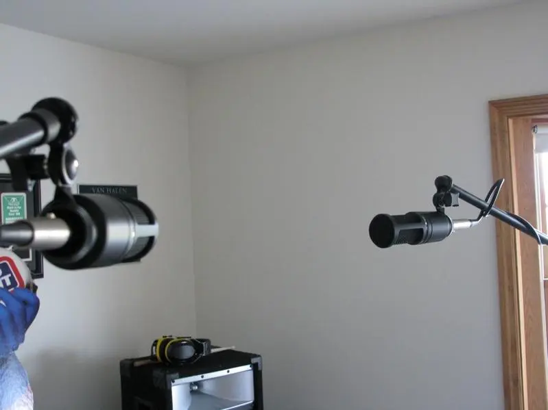

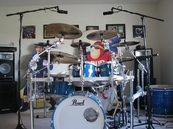

Thanks man! I know how you feel... Here's two pictures of how I have the AT 2020's mounted :D

I just posted a couple pics of how I have them setup. And in regards to how they're panned, one is panned completely left, and one completely right.

Hey BRX, the mics work in a cone shape. You're pointing half the cones towards a low untreated ceiling. If you're solo tracking, try the overheads out in front of the drums versus the usual overhead config. Give the drums as much room to breathe as you can. Add other live instruments to the room and the fun begins.
