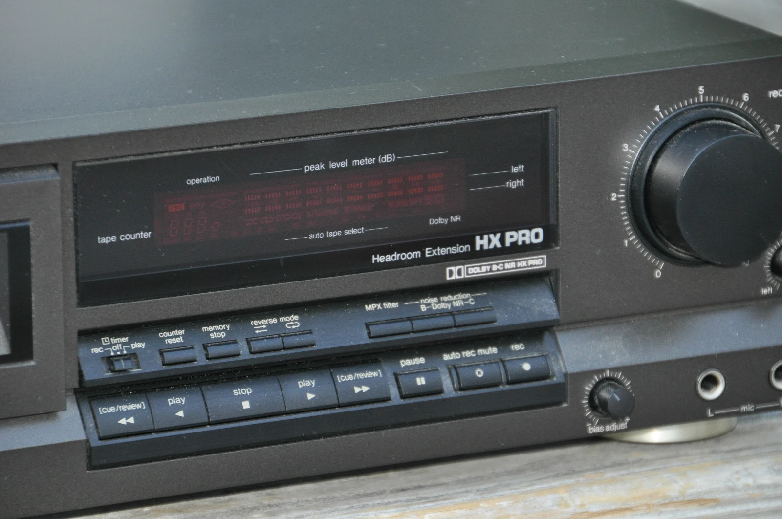

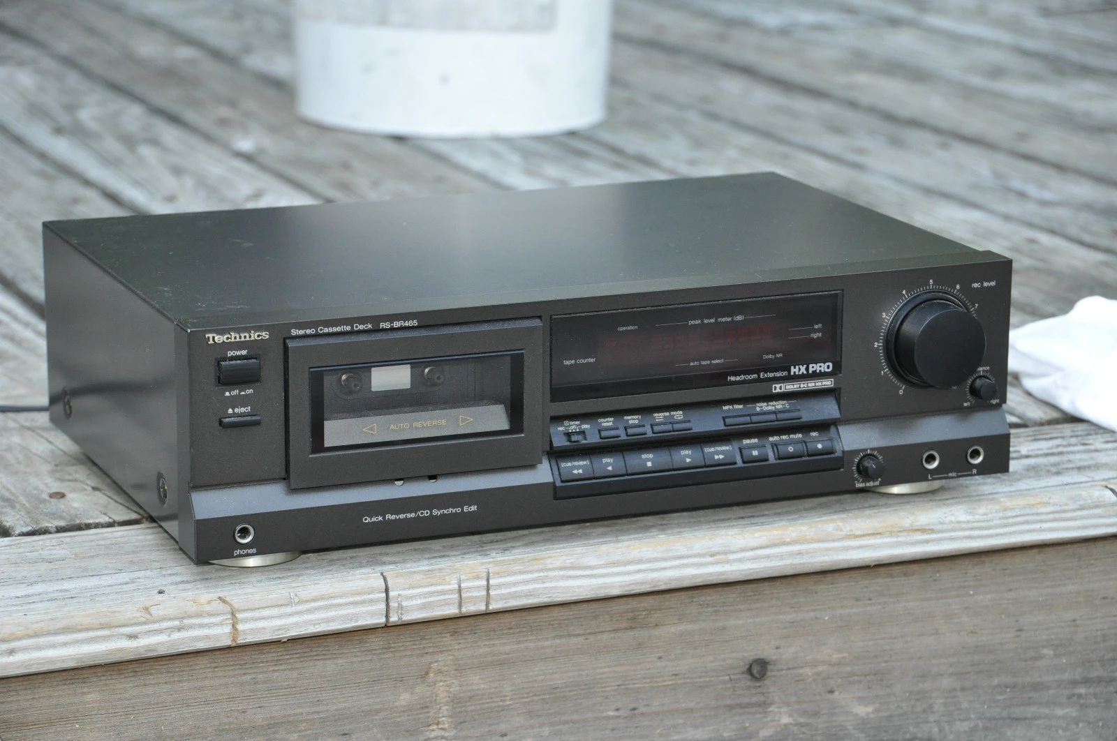

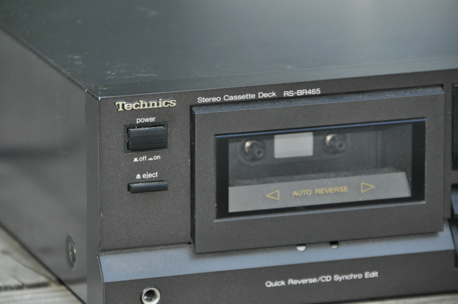

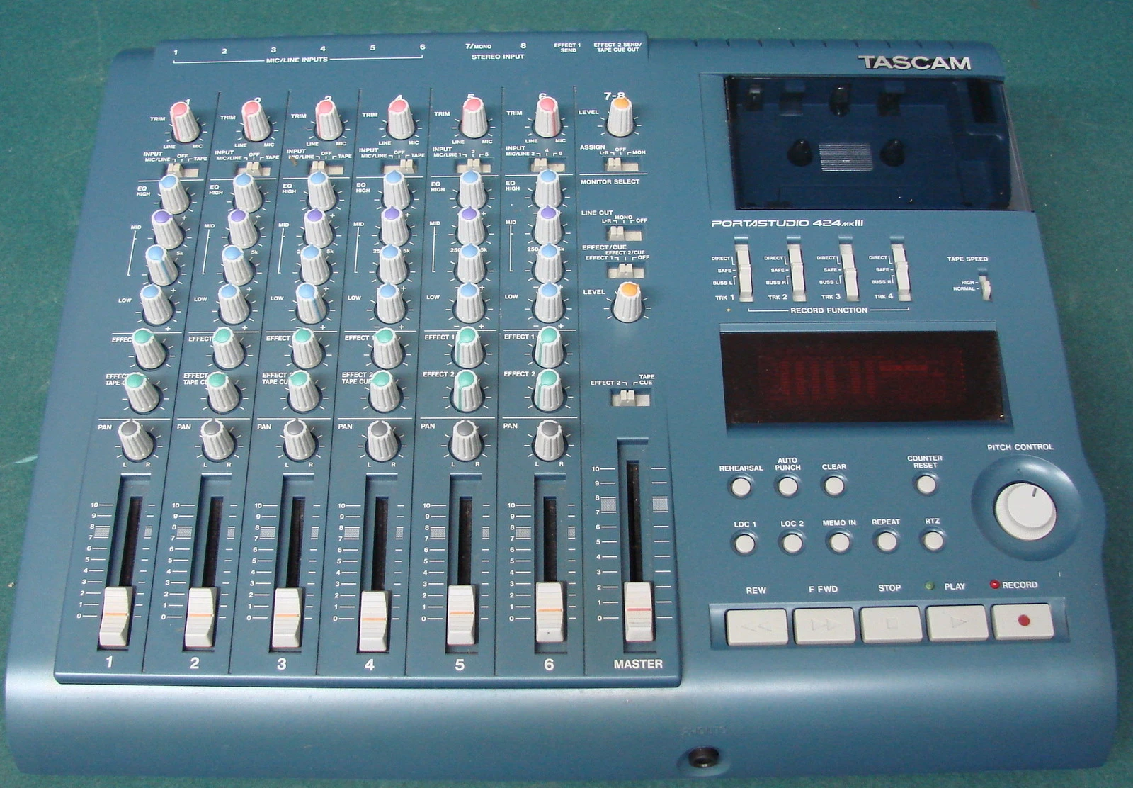

Thank you all. Those are good suggestions. Would something like Tascam424mk111 Portastudio reduce the ammount of time I would be able to record one track on cassette? Or something smaller like a four track?
The 424 is a 4-track machine. I believe it can run at both normal cassette speed and double speed for higher quality. Double speed would halve the amount of time, naturally.
What a portastudio does mean is that you won't necessarily be able to flip the cassette over, if that's important. But running at normal speed, it will give you 4 channels of cassette. You'd use a stereo pair for the keyboard, and that would also give you the option to overdub some test vocals if need be. Or alternatively, you could mute channels 1 and 2, rewind and record another song on tracks 3 and 4.
Oh, and with the Portastudio, you'd need a pair of mono jack leads, since it takes those instead of the RCA ones used by most cassette decks.
EDIT: How much time do you actually need? Are you planning on recording some kind of epic drone-rock like Bull of Heaven?
On a 424mkIII Portastudio, (as well as other Portastudio models), you may record on a stereo pair at normal speed (dbx off), flip the cassette over for "side B" and it would be virtually compatible with any other standard cassette deck. You may even do that true "single" track recording, which when you added up 4 lengths of that would actually be more recording time. (dbx ON would give quieter & more dynamic recording, but isn't compatible with "std/stereo/non-dbx" recorders).
The 424mkIII really shines is when you want to to a more complex recording up to 4-tracks and/or 6 inputs, which being a Portastudio with an integrated tape drive and mixer, eliminates some of the interconnecting cables of a traditional recorder/mixer setup.

The Tascam 424mkIII Portastudio (@ double speed & dbx) certainly fits this description and shines in this regard, with higher fidelity than "standard" stereo cassette recorders and a full complement of plug compatibility with inputs of all sorts. It's quick to set up and easy to use, literally plug and play!
With switchable (Hi/Low) tape speeds and dbx NR (On/Off) selection, it's also compatible with other "std" cassette recording and playback purposes. You could dust off your (mom/dad's?) old stereo WARRANT and WINGER cassettes out of the garage, too. What fun!:)

424mk111 looks like a great recorder. I only need 90 minutes.
:spank::eek:;)
The 424mk111 sounds incredible. Do the more basic four track recorders have the same features?
The more basic 4-track cassette Portastudios (and non-Tascam clones) will not all have the same features. The 424mkIII was the top of the line when it was produced. The lower ones on the totem pole had less features, accordingly. However, some older topline models will have all the features you're looking for, too. They all vary a little bit, so you have to look at features very carefully when comparison shopping.
