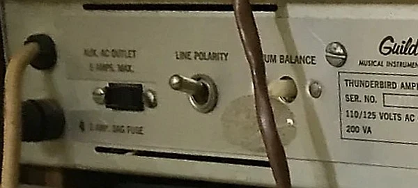

My old Guild Thunderbird amp has a plug on the back, but this is a design from the 60s, so it's a 2 prong socket, and not polarized. I don't think there was a chance that someone would plug a 10 amp space heater into it. It was handy for plugging another amp pulling a couple amps max. That amp also has a polarity switch and a 'hum balance" knob. It's also got the proverbial "death cap", which is another reason I don't fire it up any more. It needs to be converted to a grounded 3 prong plug.
I was really only thinking UK for the 3kW fan heater! Can't do that on 115V fused at 10A. Yes, that amp needs converting unless it has some massively stupid collector value? Personally I would punch out the two prong socket and fit an IEC. I hate fixed mains cables!
FWIW, I did have my 1953 National amp (Valco build) rebuilt, with new caps and converted to a 3 prong grounded plug. For me, there's no problem with a fixed cable. I don't know if it was that way in the UK, but in the US, most things came that way 50-60 years ago. If I have the Guild rebuilt, I'll keep the fixed cable by convert it to a grounded plug.
