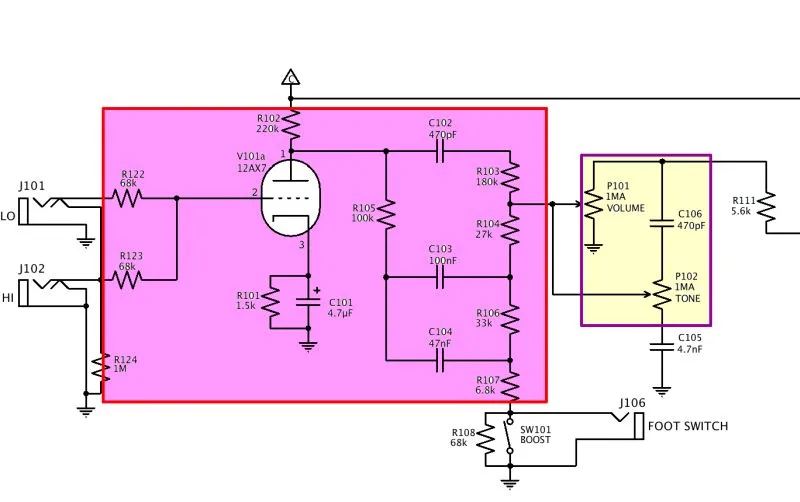

The fact that the noise changes when you roll down the tone control and roll the volume means that the problem is before the volume and tone stack, which rules out the power tube. I suspect that V101 (12AX7) or possibly one of the capacitors or resistors is bad. They need to check the section in red. Volume and tone are in the yellow box. So the problem has to be before that.
Totally agree with @TalismanRich. The 12AX7 also does double duty (V1-A and V1-B).
They're not a lot of $$$. I'm surprised your tech didn't go the the front end first.
