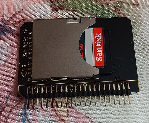

The limitation of it is that it doesn't have USB, so backups are not easy. You have to use the CD burner. Plus it only had a 20GB hard drive, so if you did 8 channels for a few practices, it filled things up pretty quickly. There was talk on the Dijonstock forum about upgrading it to use memory cards, so a few years ago, I bought an IDE to SD card adapter, thinking this might be a fun project someday.
Anyway, today was the day. I spent about an hour getting the CD burned for the upgrade, found all the parts I needed and disassembled the AW. The stock drive is a 2.5" Hitachi Travelstar 20GB, a standard laptop drive for the day.

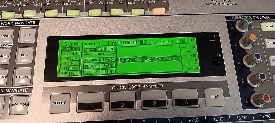

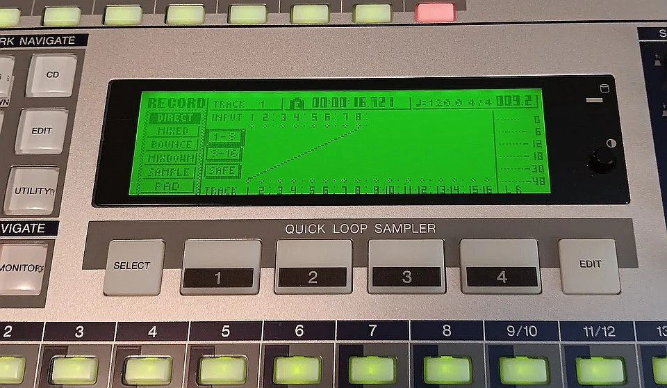

The replacement was a generic IDE to SD card adapter purchased from Amazon. A fresh 32GB SanDisk SDHC card was used. It was basically plug and play. Pull the HD and plug in the SD adapter. I put in the CD with the OS files, held down the proper buttons and the screen greeted me with CHECKING HDD then LOADING OPERATING SYSTEM. In short order, it was finished. I rebooted and got the Yamaha screen and it was ready for song #1. I plugged in a guitar, set up to record to track 1 from input 8 and hit record. Absolutely quiet and very fast. I renamed the song and saved the file, shut down and fired it back up just to double check. Everything is working perfectly except for the power switch. I used a switched outlet to turn if off and on..
