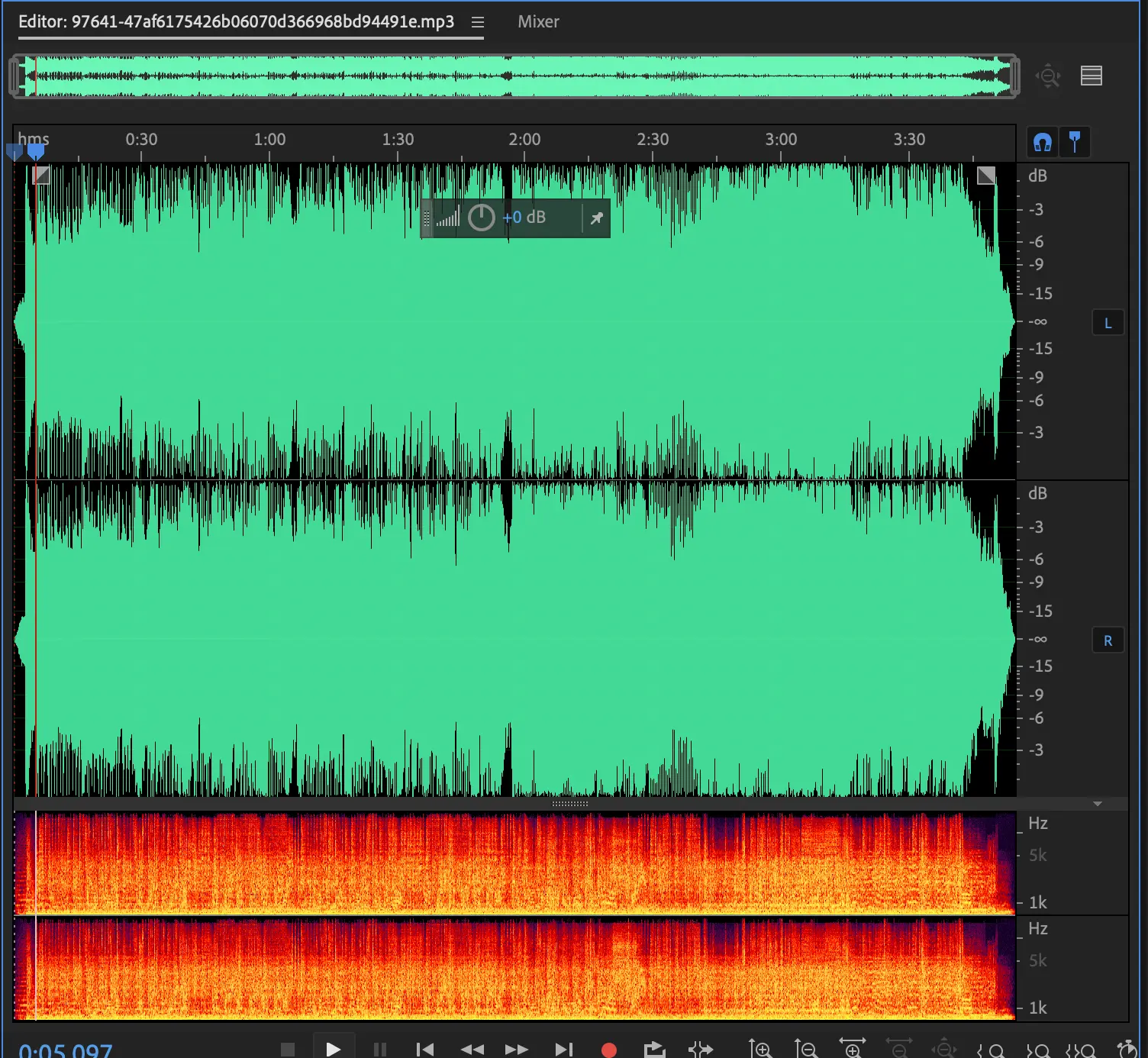

This is way, way too loud and is flat topping - the red danger light comes on and stays on. If you release it - spotofy and the others will instantly mess with it to make it not ring the alarm bells. I actually had in-ears in and when I pressed play, it was a made grab to pull them out as quick as I could. You need to look at the volume data - LUFs wise.

I actually did think about the limiting aspect of it but clearly still over egged it! I’ll try taming that a bit as well as the stereo imaging stuff that Spantini mentioned. Thank you.

So, general consensus is vocals need work and the limiting needs to back off. Thanks, that gives me something to work with.
