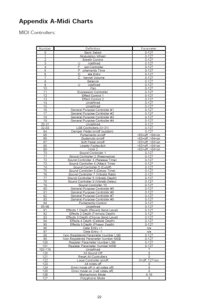

For one thing, certain CC's are generally freely assignable to controlling whatever parameters you want via a hardware controller or sequener. This can be for a softsynth, effect, DAW parameter (fader levels, pan, etc), hardware synth with only menus, almost any thing that is midi.
For synths (including softsynths) the the CC numbers are usually fixed to a certain control (this will be in the midi docs of said instrument) or can be assigned to a certain parameter (Live and Reason make good use of this). It is also worth mentioning that not all CC channels are available, there are certain ones that have a certain control associated with it and there are some that are reserved. Take a look at the attached chart
There is also something called SYSEX (System Exclusive) which is more common for controlling parameters and greatly exceeds the CC controls capabilties. A good midi controller will allow for programing sysex strings as well as sending midi cc's but that a whole other discussion
Not necessarily. It's true of some older hardware synths, for example, that modulation is hardwired to CC 1, master volume to CC 7, 'pan' (actually 'balance') to CC10 and so on. When working with softsynths, softsamplers, soft effects, etc. these traditional assignments go straight out the window leaving the clever midi user with a blank slate of 127 freely assignable, scalable and recordable 'pipes' to control every aspect of a synth sound, fx generator or wav/aiff file playback. The chart is interesting but outdated.
