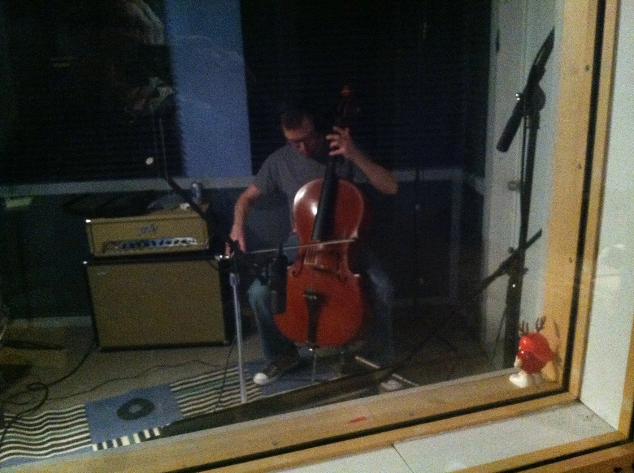

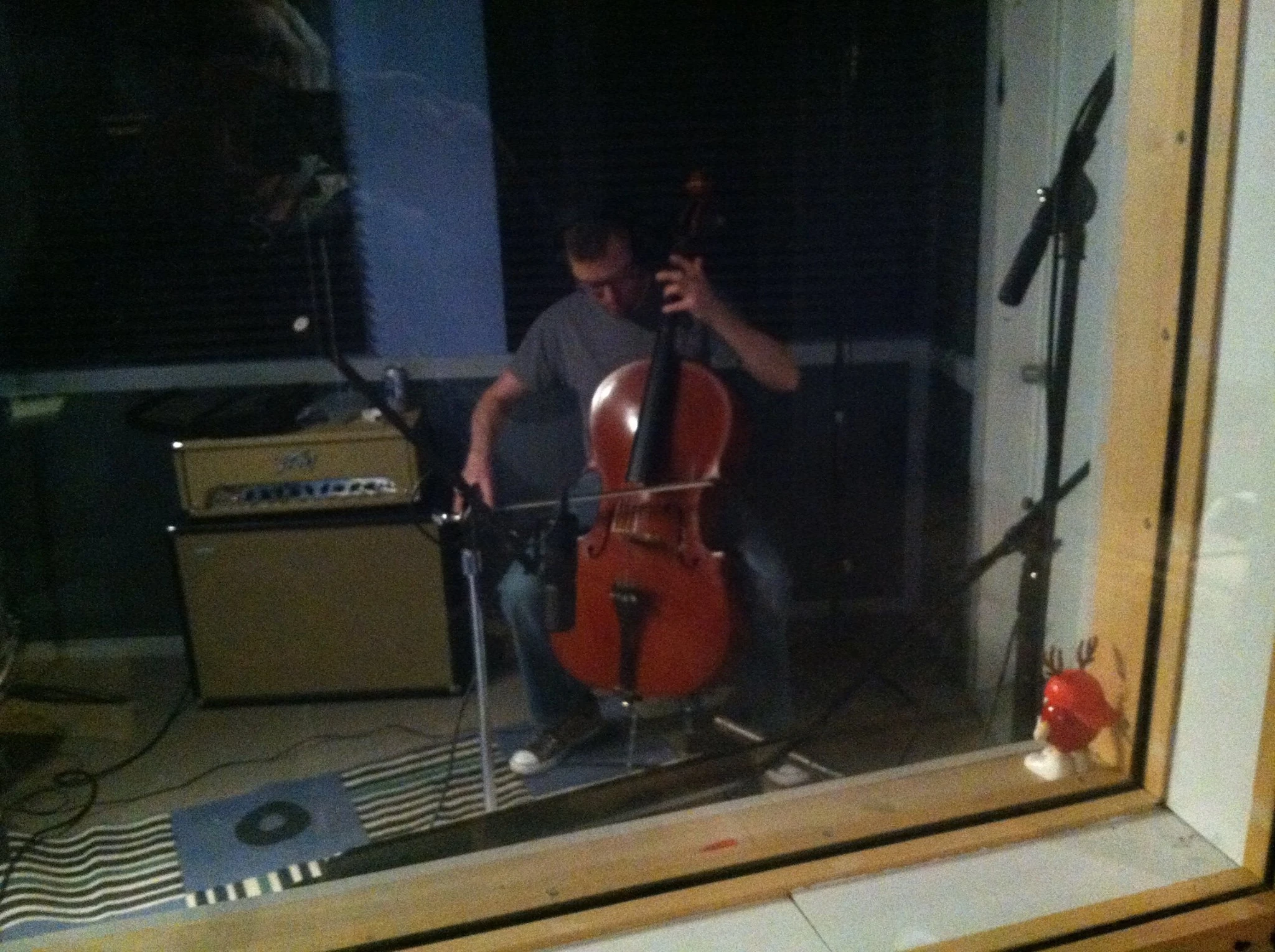

I've recorded solo Cello a number of times and have tried a couple different techniques. I've used some SDCs set up not unlike I might record acoustic guitar, one pointed near the bridge and the other pointed near the neck. A pair of Rode NT5s did not work at all, a pair of AT 4041s worked much better. Also tried a pair of LDCs in a Mid-Side pattern, that had an interesting sound because it picked up some of the room, If I was going for something different I would use this process again. But, I've found that a simple LDC (I usually use an old CAD E200) pointed at the bridge seems to give the most consistent sound that fits well in a mix. I usually play around with the distance from the mic to the bridge to try and get some of the room ambiance.
