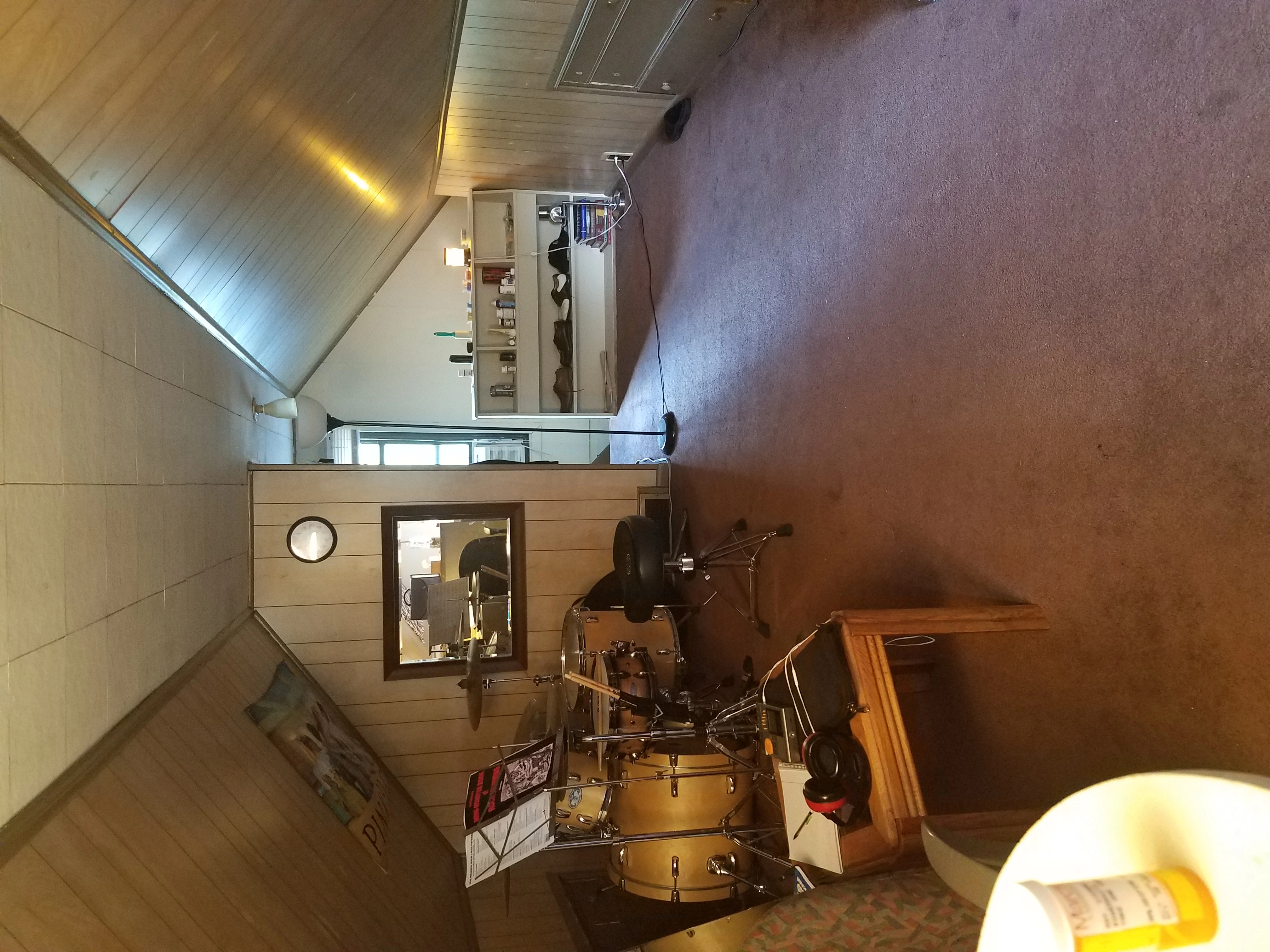

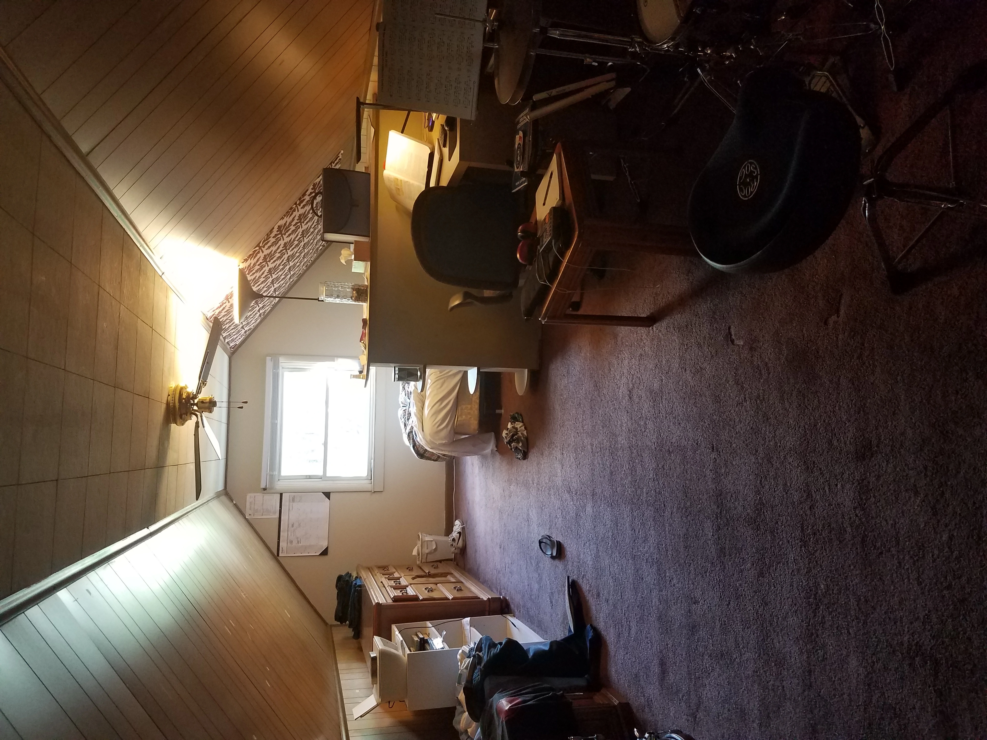

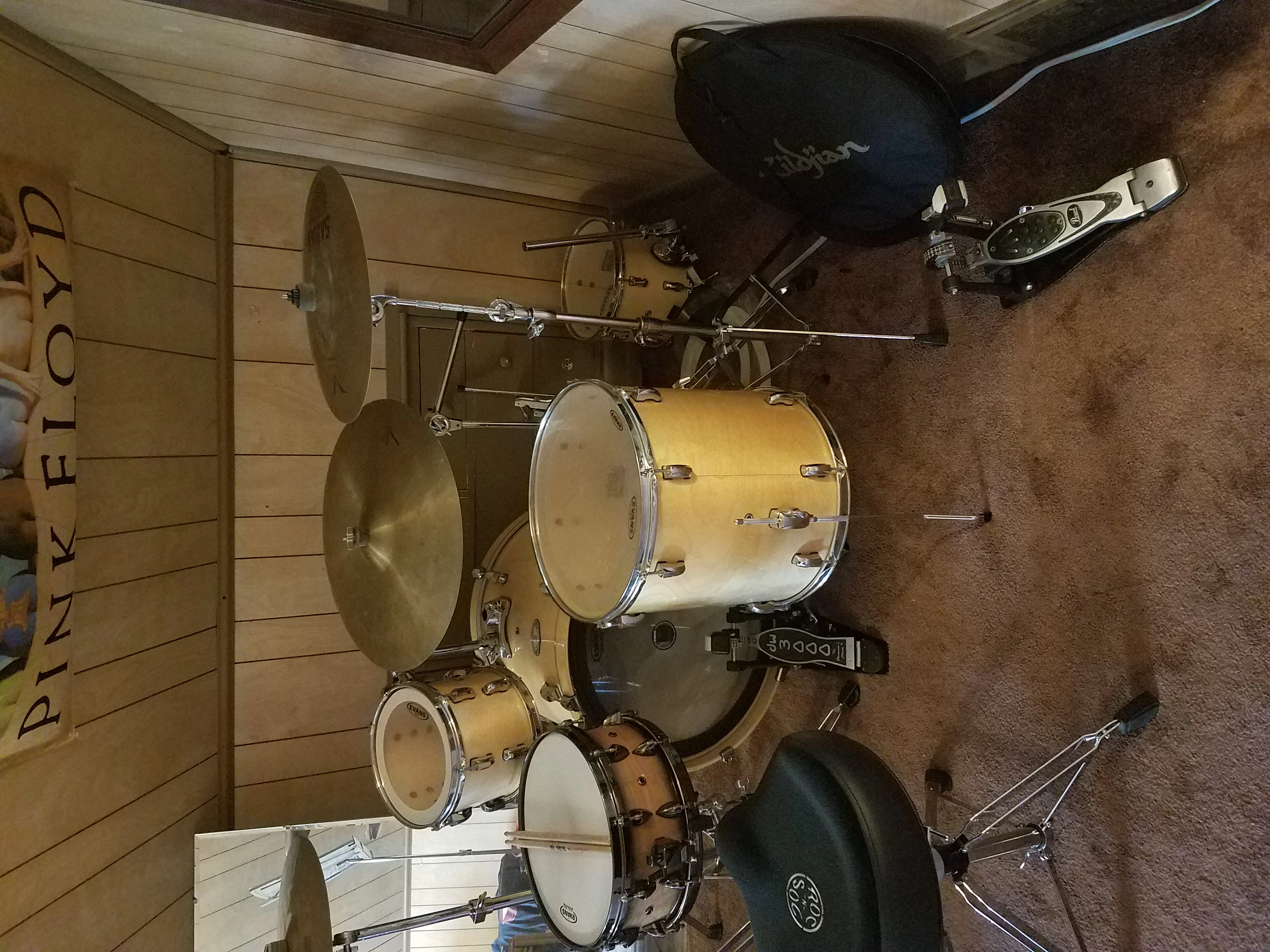

I am about to order some microphones so I can record drums in my attic. I have pictures attached below (not sure why they posted sideways?), and the dimensions are as follows:
Length: 28 ft
Width: 12 ft
Ceiling: 4 ft
Slanted parts of ceiling: 5 ft
The walls and slanted parts of ceiling are wood tiled.
I have many questions about this room, but my main question here is where should I put foam? And is my drum set located in an ideal spot in the room, or should I move it somewhere else? Any help would be appreciated, thanks.

Nowhere whatsoever would be my recommendation. You would be way better off with broadband absorption with rockwool or OC703 in there. Much cheaper and way better at the job.
Strange room that could be great or shit, depending on how you treat it. But I would start with a bunch of 2" thick 2'x4' panels (staggered 2' apart) on the side walls to keep the flutter echo down. Definitely get that kit in the center of the ceiling vaults and hang as thick of panels as possible directly above the kit. The toughest part of drum recording in a low ceiling is the reflections back from the ceiling into overhead condenser mics.
That looks like a dropped ceiling. I would suggest getting rid of that and see what is up there. May be cheaper/easier/better to fill that space with pink fluffy stuff and cover with cloth.
My opinion based on my personal experience. Sure others will have ideas also.
Best to ya!
Again, screw foam.
Yup, foam in the garbage. 2" rockwool panels all over the walls, 4" rockwool in every corner/wall angle you can fit them in.
I use foam inside roadcases to protect the equipment.
Jokes aside, I do have a small amount of acoustic foam in the recording room to tame some splash slap, but very little, most of the acoustic treatment is as the guys above described. Foam is not the big fixer of acoustics.
