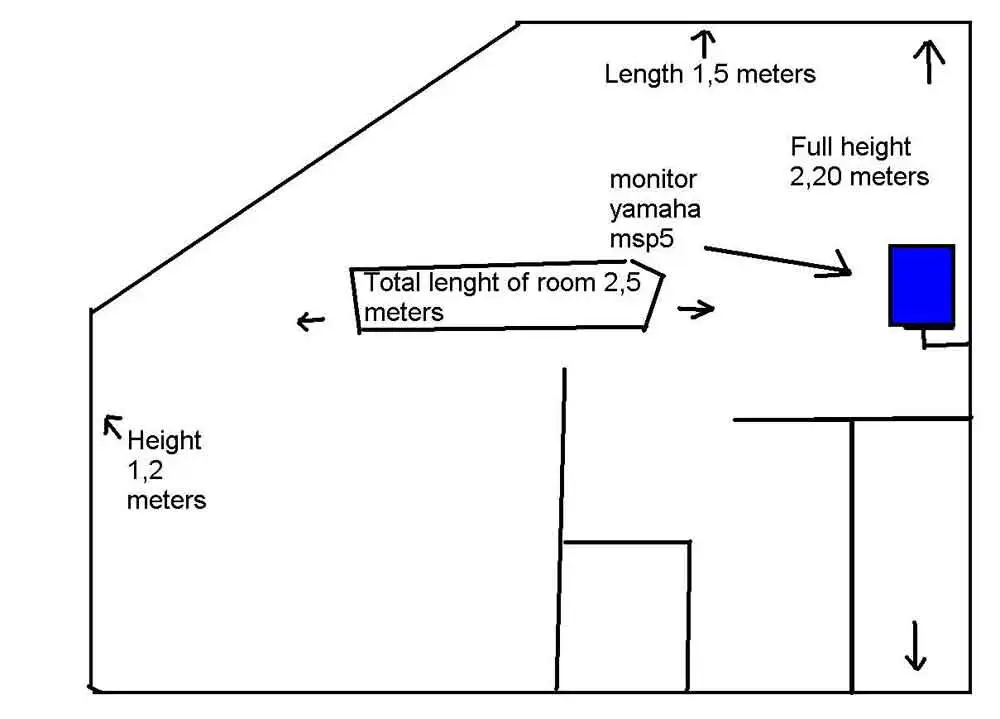

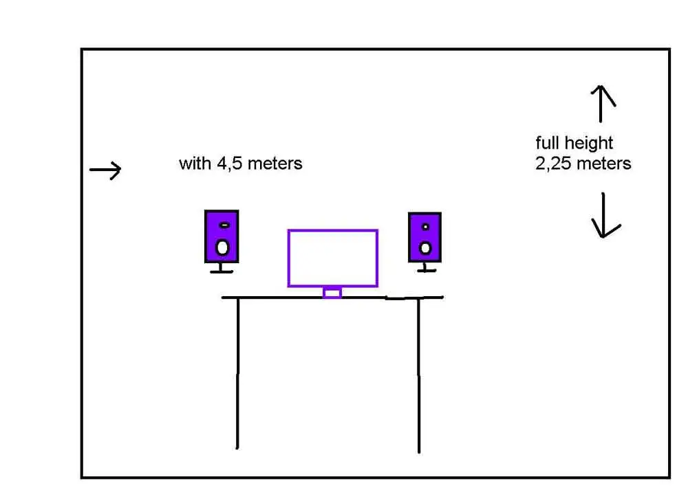

I`m moving into a new house.
I`ve got a even shaped room to put up a studio in.
On the side of this room I have this small bedroom\shed.
I was thinking about making it a controll room.
The roof is slooping after 1,5 meters into the room.
total floor size is 4,5 meter x 2,5 meters
Full height is 2,25.
I`ve made some drawings.
So my question is Should I drop it and setup the controlls\monitors in the Music room instead (its much bigger).
I just thought it would be good to get the controlls isolated from the rest. :)

I think I would use the little room for a vocal or iso booth. That ceiling is gonna reflect the monitors right into your head, so either way you'd have to completely deaden it.
Thanks for the quick reply :)
I was planning to try some DIY acoustic treatment.
when you say deaden it.
I`ve deaden a few rooms before to get that 70`s prog rock sound.
I used a whole bunch of thick carpets floor carpets, wool blankets, you name it.
If the room was completely dead, It would be worth a shot?? :confused:
I was planning to set up Acoustic panels, but if carpets would do the trick I have some experience with that.
thanks.. .... Daniel :)

Ps the two pics are of the same room, just different angles.

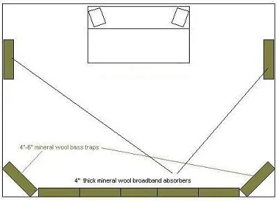

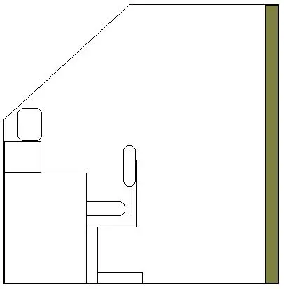

I believe that you could use that room as a control room. Just swap you idea round, and line the back wall with 4" broadband abosrbers, with 4-6" bass traps in the corners. Also have a broadband absorber on the sides of the room between the monitors and mixing position. (shown in the pics)
thanks for replying
Intresting... :)
It would be nice to separate the live room and the controlls\monitors.
One more thing should I put up carpets in the rooms, or leave them as they are "wooden"?
thanks for the great drawings :)

Shouldn't matter too much, 'cause the reflections on the floor from the monitors will just bounce to the back wall to be absorbed anyway. Save your money and keep it wooden. Looks better too.
