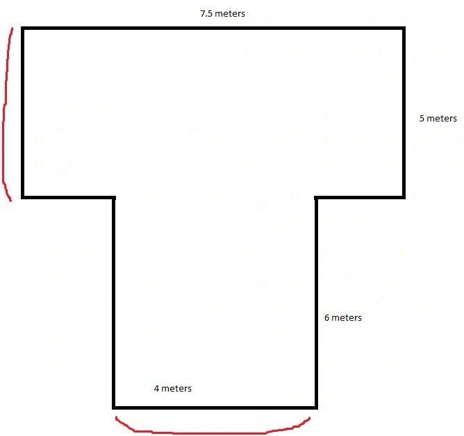

Me and my band want to build our own rehearsal space / recording studio at home since we currently are paying way to much to rent out a (way too small) rehearsal space with a really bad PA for four hours twice a week. I have quite a large basement, so my house was, and still is, by far the best option. However, I'm no handyman and I really don't know how to get started on properly isolating and sound treating a room for a loud (like 120-130 Db at the peaks, averaging around 105-110 Db) band. The main goal is to build the entire studio over time, but have a rehearsal space ready quite soon.
The plan for the studio is a two room setup, with a control room and a recording/rehearsing room. I have quite a large room available, setup in a T-Shape as you can see on the image, the walls accented with red are open and will have to be build, the rest are Concrete-Brick walls with soil behind them. The plan is to use to larger section on top as a rehearsal space and then build a seperator between the upper and lower portion to have control room in the lower portion. My best guess is to Build the walls using wood and fiberglass insulation and then use the usual acoustic treatment methons on all the walls like foam pads and bass traps. (Honestly I don't know what my options are, I can't find a lot online without exclusively North American delivery...) I could really use some help as to what exactly would be necessary to properly isolate the walls that will be built and then treat the entire room to have a nice balanced sound for recording.
My main problem however is that we want a window between the control room and the rehearsal space, I'm thinking of 2 layers of plexi-glass, but if there are better options, then I really want to look into those! My budget shouldn't be a problem, I'm willing to spend around 2-3 grand on the construction and sound treatment, we can do most of the assembling and stuff on our own so no labor cost. I really hope I can get some feedback from you guys, I've read a couple of posts on the forum but the combination of a window and then multiple wall types really throws me off!

So explain with a bit more detail about your long-term intentions...the need for the 2-room setup...and what your acoustic and/or soundproofing goals are.
Whenever I see a smaller home studio plan, the first thing I ask is if you really need to break it up into two even smaller rooms.
I've got a 26' x 34' new studio build in the works, and it's going to be one open space. I will have the benefit of a pretty high cathedral ceiling too...but if I was in a basement, even more reason to go with one room and have the benefit of the total volume.
That said...if you do really need 2 rooms...that "T" layout is pretty good for it...though push those yet to be built walls as far back as you can...go for max size in both...because by the time you treat the walls/ceiling...put in doors...load in equipment and some furniture...etc...etc....what looks pretty good empty, suddenly feels a lot smaller.

I drew out the room and yeah, it won't be as large as I thought (especially with the gear in it) however, with internal soundproofing (taking 30cm off of each wall) it still is more than large enough to house all 4 of us and have space left over for either a keyboard or a couch... as for the control room, I just did the measurements it is plenty large, the only minor fluke is that it will be a bit narrow (only around 3.5m) but it will do the job for the coming years until I move to my next accommodation. ;) The ceiling is at around 4m high though, so that's a plus... It's not cathedral high but it's a lot better than just a 2.5m high concrete block :rolleyes:
The main need for the second room is so we can do all the recording and mixing in house, I have a few friends studying audio engineering who already wanted to man the board during rehearsals and recording (mainly recordings) so it will be put to good use! My main goal for the room that we will be building is to have a place to rehearse and record some at least more than decent music until I have the money to actually build a house...

The main need for the second room is so we can do all the recording and mixing in house...
I do all my recording and mixing in house...and one room works just fine. The only considerations are that while tracking, the engineer has to use headphones, since he is in the same room and can't use the studio monitors, but that's never been an issue because normally you do some initial test passes to get you levels and everything set, so the worst case is sitting to hear the playback on the monitors and finding you need to make some adjustments, etc...
...and then other consideration would be if you needed to have isolation booths/rooms, but you don't appear to be planning a 2-room for that purpose.
Point being...mixing in a smaller space is just as bad as tracking in a smaller space...so one bigger open space will yield better acoustics and better results.
I get the feeling that you will be tracking the "band" and maybe only doing vocal overdubs...so they're all going to be in one room, and since you are dividing the space up, it will be a smaller room.
I know the whole "control room" thing looks cool and all the big studios have them...but often the bigger studios have massive live rooms, and the control room is just for monitoring...and the actual mixing ends up getting done in another studio where they have a suitable mix room.
Not saying you can't make it work with 2 smaller rooms and all that...just that you should consider how much you really need to have it like that VS one large room. I mean...you are not going to be mixing while you track...so no need for the isolation between the rooms.
That said...your "T" shape doesn't necessarily equate to a normal looking single, larger room...so it's kinda easy to break them up.
You may even consider using the short end of the "T" as an iso-room with a large window...and stick your drummer in there. Then put the mixing setup at one end of the other, bigger space, along with the rest of the band etc.

Thanks a lot for the extra info, I redid my plans and having the entire T shape as the recording room would really give us the better results, Maybe make an iso room for the drums in de smaller part of the T like you mentioned, but just having one Room would make everything a lot easier so I'll go with that! I also convinced our drummer to start using less loud cymbals so we should get the noise down to a way better level that way...
My main issue now is to get a sound-treated space, sound leaking to the outside isn't a big issue, just the internal acoustics should be optimised. How should I go about doing that? I ws thinking of making my own sound panels instead of just using foam, I'd make some bass traps and some general panels to have 60-ish percent of the surface area covered. What would my optimal strategy be?

You may not need to isolate the drummer completely G?
I have read that kits sound better if they are raised on a "dias" or platform about 200mm high? Made out of 19mm ply and battons it can be covered with HD carpet tiles. Then a a panel, maybe two of ply, better MDF (even better HDF!) erected in front and maybe at a side of the hitter. Double glazed glass becuse you want MASS and glass is denser than plastic. I doubt he is pretty so even wired glass would do...
Make a few Gobos, ply or MDF panels 2x1.5mtr'ish. One side hard and painted, tother faced with absorbent material. These can be stacked against/along a wall when not in use. If you dont want the absorbing, hard face out. Some can hav DGzd panels in them.
Bass trapping I shall leave to the experts.
Absorbent material = rockwool or compressed fiberglass - NOT FOAM! Foam does not absorb low frequencies so will only make a muddy sound as the low frequencies bounce around.
