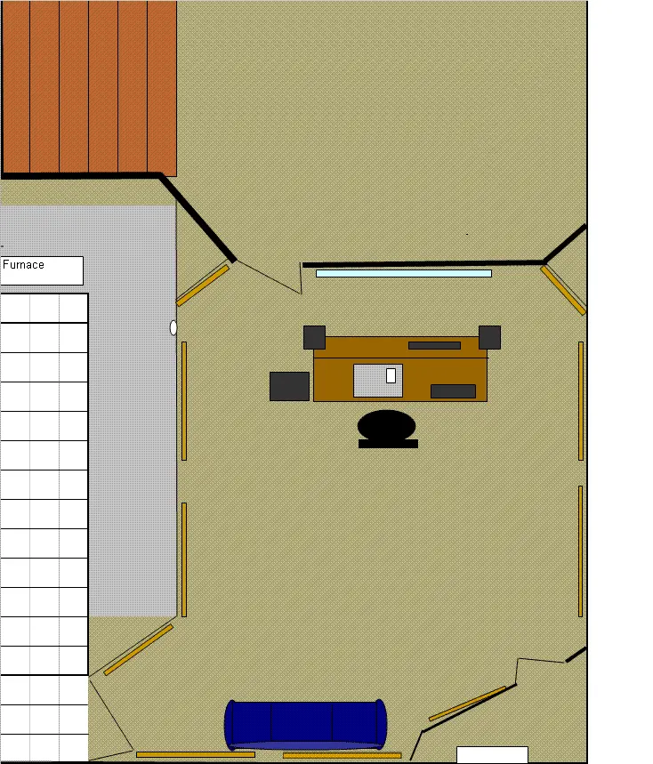

a little diffierent take on Panda monk's idea...This is in excel so please forgive the crappy drawing. i tried to make each cell represent 1 foot.
Ryan

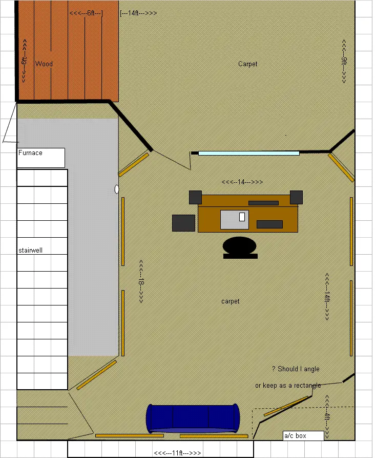

this one has dims . I worrig about the Cr dims. the are not equal if I leave the electric and plumbing closet angled. also shortening the cr makes it more square.
Ryan

So where does the door come in. It seems, by your drawing, that it comes in the stairwell bit. I
s there any way you can photograph the place, because your drawings confuse me a bit, and can you explain a few things, like the need for a door to the left of the sofa, etc? Could you explain every bit of the room as you can think of on your drawing, like the grey/blue bit to the side of the stair well, etc.
i can take pics tonight...the grey bit would be storage..there is a furnace and water heater under and beside it. there is also a support beam that will be in that wall.( it is there currnetly and can't be moved.It's the white oval in the 'drawing'. the door would com into the CR from the bottom of the stairs. the door to the gray storage area will come in on the west side of the stairwell... it is a difficult space... p.s. there will be a sofit that follows the dividing wall between the cr and live room. It has pipes and duct work. the soffit will be in the cr room side.
