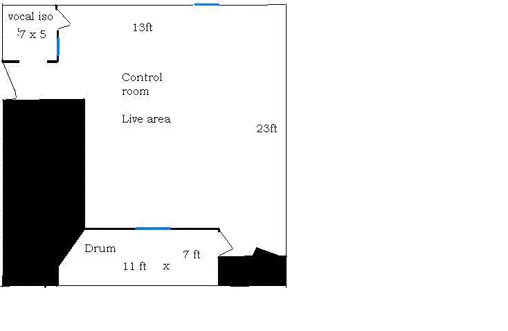

Ussually hang out around VS planet since i'm a vs user, But thought you could offer a little more help over here. I am ready to convert my basement. I have a couple of spaces that i have to work around. I do a lot of direct recording guitar, bass, keys, etc. Will prob be micing drums, vox, acoustic guitar. My initial thought is to make the CR more open since alot of what i do can be done in there. and then also maybe use some GOBO's around the compuer to kill the noice and maybe do some live recording the CR space too. i have some crappy sketches of the space.
block walls, ceiling height 7'9", Not sure how to treat the big room. which i would use as a control room.

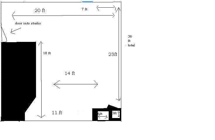

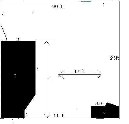

What are the blacked out spaces? Is the small one a cupboard? Can it be knocked down? Is the 23' the full length including the 6'x3' black thing? What's the distance from the top to the left black thing? The angle in the left black thing, the dimensions don't seem to show that, the 6' black thing + the 11' drum booth = 3', but the full width - the 17' width of control area = 3', so what's the angle? Is that a door on the right black thing? What distance in is the window? Any more info would be great. :D

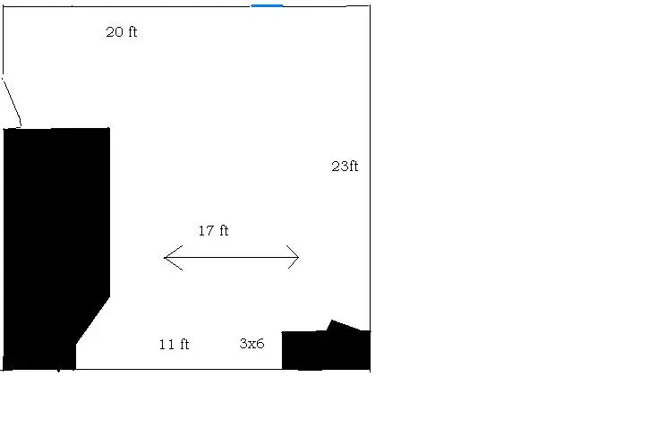

Blacked out spaces are areas that have to stay. the 3 x 6 area is where pluming and electrical terminates. it makes noise , plumbing. the basemen length is 26' total. the other area is a stairwell that has a furnace and a water heater to the side of it. it is 18' long. 7ft at the widest portion. 3ft at the base. Neither of the blacked out ares are built. But tried to show what will be needed take up the least amount of space for recording. yes it is a door on the right black thing. it has a clean out for the plumbing system.
the window is 7 ft from the right wall...tried another horrible drawing LOL
again i can really change the blacked out areas. the angle could change some but not much. thanks so much!
ryan
the length 1s 26 ft not 36! sorry typo

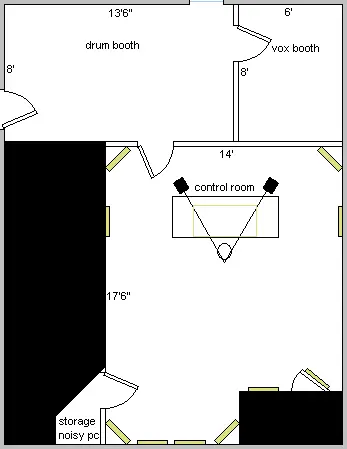

WOW! panda monk that's great.... Honestly i never thought of that, i was always trying to keep the drum and h vox seperate. But really i dunno why i always use a scratch track for vox guitar and the ever important metronome when doing drums bass and rythym...
so i'm assuming i would use mineral fiber or the receycled cotton material to try to iso the vocal booth from the drum room, as well as independent walls.
thanks for the direction!
Ryan

Just use standard insulation, and you might have to do RIAR(room in a room). Do you really need to be recording drums and vox at the same time? I'd suggest forgetting about the vocal booth and having one live room with gobos. You could record drums, then bass, then guitar, then vox, or all the instruments(miked drums, DI bass, miked guitar in Control Room), then vox.
For the absorption panels, use rigid fiberglass, mineral wool, or acoustic cotton.
Anopther problem is that the live rooms are 8' wide and almost 8' high. Square dimensions are bad acoustically. I couldn't see a way round this, because of the black bit on the left. There will always be a square dimension.
