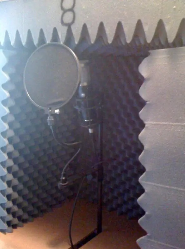

Hey everyone,
I came across this box at work that had the egg crate foam with pretty deep craters on all 6 sides (4 sides, top and bottom). So i rigged it into a spot for my mic. I tested it out it out and it makes a huge difference in sound quality, theres def. less echo. What do u guys think of it? Is it hindering me from a specific sound or is it ruining my sound? I know u havent heard it but for those of you who know acoustics - is it hurting or helping me?

It probably not hurting, but its also not addressing the real and much more pressing problems your likely to have in any home recording space. There isn't a single piece of foam in my treatment scheme and I think I have a pretty decent sounding tracking and mixing space.
Also, a technicality, but a big distinction; your concoction would be considered acoustical treatment as opposed to sound proofing. I'm not point that out to be a smart ass, but to lead you into kind of the first lesson of acoustics as it applies to HR; the difference between treatment and soundproofing. Acoustic treatment is a matter of creating a more acoustically pleasing or accurate space. Soundproofing is a matter of stopping the sound from one space from entering into another. The degree to which you need to do either of those things will be determined by your space, specific needs and budget...
if you found this lining the 6 sides of a packing crate - then it is packing foam not acoustic foam..
To begin with it is a lousy foam for acoustic treatments........ BUT - even more importantly it is a monster of a fire hazard.
It was packing foam that was the fuel source for the Station nightclub fire in Rhode Island that killed 100 people....... you should not be using this material for acoustic treatments.

Also, a technicality, but a big distinction; your concoction would be considered acoustical treatment as opposed to sound proofing....the difference between treatment and soundproofing. Acoustic treatment is a matter of creating a more acoustically pleasing or accurate space. Soundproofing is a matter of stopping the sound from one space from entering into another. The degree to which you need to do either of those things will be determined by your space, specific needs and budget...
Great post. I also agree with Rod. This stuff bears no resemblance to proper acoustic foam AND it's a significant fire hazard. I hope you're not smoking around it...

Let me try to be a little more explicit - don't use this product for room treatments unless it is flame proof............ you can test by taking a small piece of the product and setting it on fire - once it is burning freely remove the flame source - if it continues to burn without the flame source it should not be used for any purpose.......
This is not an issue of being careful around it - it should not be used - period.

As to whether the foam is hurting or helping you, it's hard to make that judgement unless we heard the space before you treated it. I suspect it's killing alot of hf material which will make it sound "better" or more "controlled". However, that's kinda fools gold for ears. However, I can see where it might be less reflective, assuming that was a problem to begin with.:cool:

I don't see how it's so dangerous if it's only used in a box around the mic like he's done.
If he put it on the walls then yeah, that's dangerous.
But if just having that stuff in a small box around the mic is so dangerous, then are you also saying don't allow any boxes of stuff you order that come packed in foam inside the house?
I doubt you get something you ordered in and immediately frantically unpack it and get the dangerous box outside!
That's a bit of an overreaction.
However ...... it's probably not very useful for the purpose he's using it for either.

Regardless of the danger or lack of danger, it's a stupid idea because it doesn't help anything sound better.
