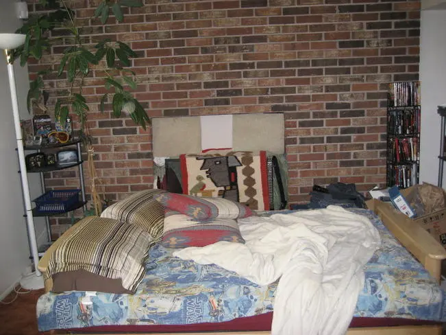

I have been recording in my office, which is a square shapped 9 x 10 1/2
with half the ceiling being 6ft high, and the other half is 7ft.
Anyways, I stopped recording with mics because of quality. But this is what I have been planning:
My bedroom is the "family room", and it is rectangle, and is 15.9ft long and is just under 11ft wide, with 8 foot ceiling. Not to mention that the wall I would put my desk, is a completely bricked, with a stove indented into the brick.
My current desk is a L shape, but it sucks trying to combine an office/school desk with a music production desk.
This is why I am planning to step it up. Switching my two rooms around, and buying a second desk, would give me that extra desk space. Plus the L shape sucks for studio monitors.
There is the desk I would get, it is affordable andt will be the one I settle with:
Buy Studio RTA Creation Station Studio Desk | Desks, Tables & Workstations | Musician's Friend
They have a newer one in the Guitarcenter catalog, that you can also buy a side cart, that has like a 20-30 space rackmount built in. I like the one I showed you cause it's longer and then I would later get one of the side tables.
I want to put a new desk symetrical with the brick wall, and they sell studio monitor stands, that have triangles for the base. They are 18 inchs, and where the brick wall is, on the floor, the brick comes out exactly 18 inchs, so I can either put the stands on the brick, or on the carpet, giving me 18 inchs behind the monitors.

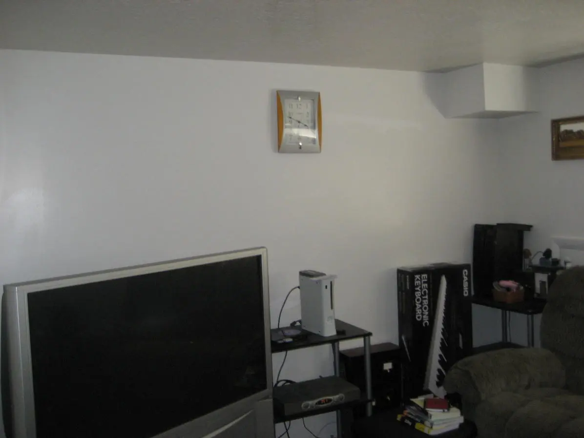

I figured a brick wall would give it better sound. Next I was thinking of buying a DIY foam kit, like the auralex studio designer kit, but since I don't own the home yet, I figured I would buy a couple slabs of plywood, or some kind of wood, and I would glue the foam to them. That way I can mess around until I find the best spots, and nail them to the wall.
I would put them on the opposite wall of the brick wall and get the corners kit. I really don't have money to do floating floors, or any other professional constructions. I just want something simplistic, that gives me the minimum quality that someone would need.

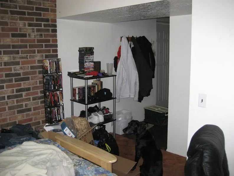

Your probably going to mention that there is no door to this room, and there is a 7ft x 7ft opening that opens to a hallway and another little hallway to the laundry room.
I am not sure how to fix this problem, cause I know things should be air tight. My parents have a carpenter friend, and he quoted us a lot of money to install a wall and door. So unless I want to cough up a bunch of money,the best solution I could think of, is buying a huge piece of wood to cover the majority of it, and glue the foam on it. That way it would be a temporary fix, and not to much money.
I am not trying to go full blown studio, but I would like to get a decent sound, that is worth adding to my tracks. Once I own the house, I will probably redo this whole room.
Since I will be having two desks, I plan to get one of them new iMac's especially since they got the new sandy bridge cpu's in them. If not I will have a mac book pro by august for school.
So can you tell me what you think? I am still debating a few things, but this is what I am thinking of doing right now.

Don't waste your money on foam. Build or have someone make you panels made with OC703 or rock wool. They are portable and will actually improve the sound in your room. Foam will do nothing other than attenuate the high end and lessen flutter echo. You can purchase prefabricated panels if you or someone you know isn't handy. I built 12 2'x4'x4" panels for under $300 using Roxul 80, drywall corner bead, rivets, spray adhesive and $2 per yard cloth.
Carpet the walls. Brick is horrid and not. Hard reflections in room. But it will block a bit of the outside world too. On the cheap, already in inventory options. Lean your bed mattress against the wall. Comforters draped over book shelves and other things to improve the inside acoustic. But it depends on what you'll be recording. Human voice only, a headset mic and an sE reflexion filter to smother your head in kind of works for me when I need to take the room out of the image. On the bed and under the comforter if you need more isolation. Although not ideal or "professional" by any means. But sometimes you've gotta do what you've gotta do.

Not a good idea. Like Jimmy says, foam is not good for acoustic purposes. You won't control bass, which is 99% of the problem in 99% of rooms. You need rigid fibreglass for proper room treatment.
This is good advice.
Carpet the walls.
This is horrible advice.
Carpet is the worst advice (I rank it with egg cartons). Brick is OK but you need to tame it. Hang some high-band and broadband absorbers over the brick, try covering about 1/3 of the brick first and increase it if the brick is still too reflective. Add some bass traps to the corners of the room. Carpet will make the room dead, a dead room sucks the life out of the recording and is a horrible place to work in.
The reason the door is expensive is that to build a sound proof door costs money, you need a solid core door with a good frame and good seals.
There are no short cuts but you can make the absorbers yourself to save money.

I'd say that with foam, carpet or blankets you will be seriously disappointed with the results. Also a good chance of your “sound” being super muddy and bass heavy, as you remove the higher frequencies with those materials.
1st off I would seriously consider looking at absorption materials that are more broadband. As they will have a more balanced effect on your room reflections.

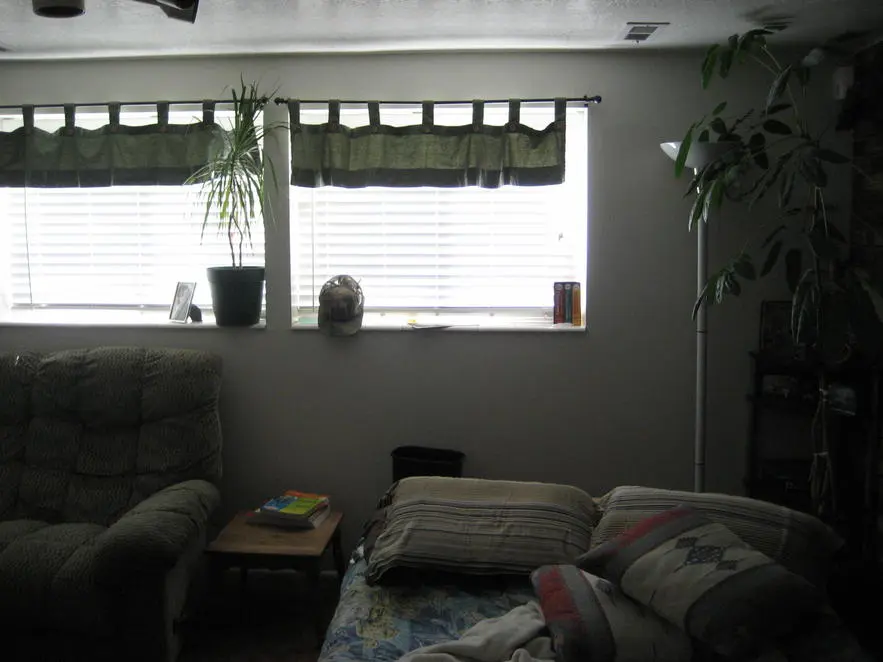

2nd with all of the furniture in your pictures, Id say keep whatever material you get up above the furniture (kida a no brainer I know)
3rd If the desk goes back-facing to the brick wall, then I would say that you should start treatment on the opposite wall, and the corners of that wall as well.
4th That open space will probably need something to cover that open hallway/other room, to remove coupling effects. Not only that but reflections from the sidewall on the other side will reach your ears while the ones going through the opening will not, and this will throw off your balance/stereo field decision making. I guess you could look for one of those zig-zag folding privacy walls of get freestanding acoustic panels to set in front of the opening while you are working. You wont get this room “air tight” even if you sealed that opening off completely.
