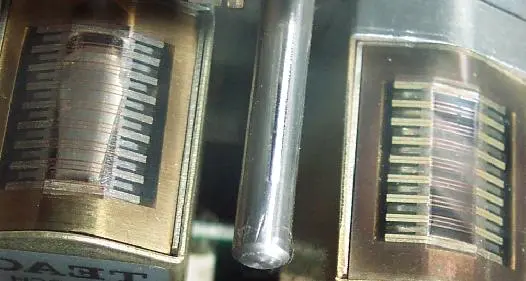

What bad heads look like!
Great post, thanks!
I never knew to look for spots where the head is "opening up."
-MD

Now if we only had some pics of good head and some partially worn heads. To compare to. I recently say a 34b on ebay and it showed a pic of the heads and they looked absolutly new. I didnt know heads came that way...too bad I cant post a .jpg dont know why???
That's one of the best pieces on head wear I've seen on the web. I have Mike’s site in my bookmarks but haven’t seen that section before.
It should help a lot of people looking at used equipment. I always ask sellers about the heads and to send or post pics of the heads. Some of them act like I’m asking too much of them. I try to explain if you have no heads you have no recorder… and new heads can cost you hundreds on a typical TASCAM/Fostex multi-track, and some you can’t even buy new anymore..

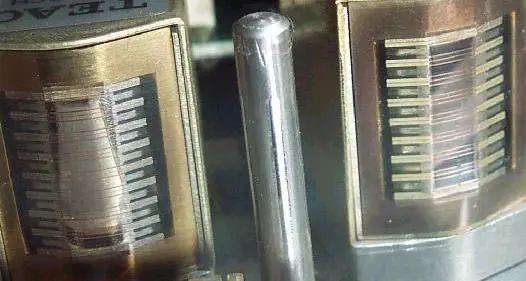

Not always so clear to see
I had a 3340 that had a worn out head. The gap did not have parallel sides but was more ragged....Still you should not see any gap there in general.
one wave at 20 kHz and 15 ips takes up about 0.75 mils (0.00075"). Typical head gaps are 0.25 mils (0.00025").
The very finest hair (flaxen hair) is around 0.66 mils (0.00066") and is still 2almost 3 times larger than a typical head gap.

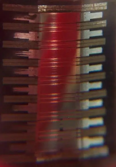

Head photos
It is just hard to get good photos of heads in the deck and with the camera that I have. Here are 2 photos of the heads on the 38 that I have. the reproduce head is worn out. Several tracks do not reproduce at all. the record head is worn but is still functional and can be calibrated. Both heads show even wear (no keystoning) even though the photos make it look otherwise. The reproduce head shows a number of places where the head has been worn down so much that the gap is huge.

Yikes!
Yep, that repro head is toast. Those are good pics for reference. Evaluating heads is one of the hardest things to do when shopping for a machine, even for those of us that have been around awhile. (It’s hard on the back too) :(
Its tricky to estimate head life on a good head for sure, but these you have are good for extreme examples of what to avoid. If someone new wanting to get into analog can keep these in mind it could save them much grief.

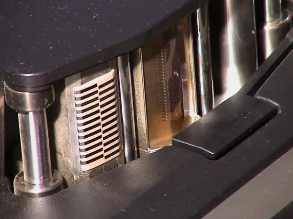

Have a look at this for us Guys! I think this one is OK apart from what looks like some cotton fluff?
The guides have a bit of wear though?

It is difficult to tell from photos, but you will need some different angles, including straight on with no glare. If the guides haven’t been turned the tape path looks gently used.
I agree. There is a small flat spot on the tape lifter and guide on the left and, as Tim already mentioned, if these have not been rotated previously, this seems not a high hour machine. On the other hand, if there is uneven head wear [hard to see from photo] then all bets are off. Do as Tim suggests as per the photos.
Cheers Guys!
It's an Tascam MSR 24 went for Winning bid: £1,230.00 that's too much of a gamble IMHO!
