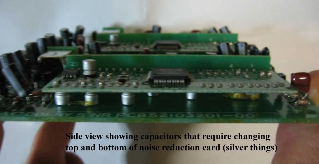

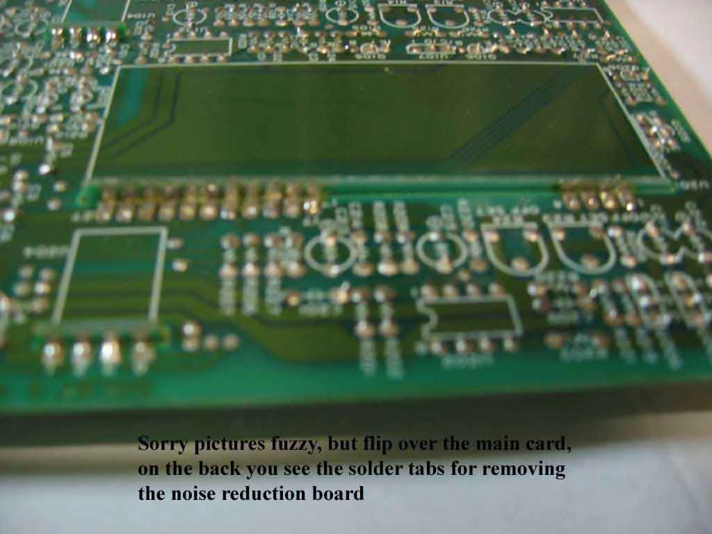

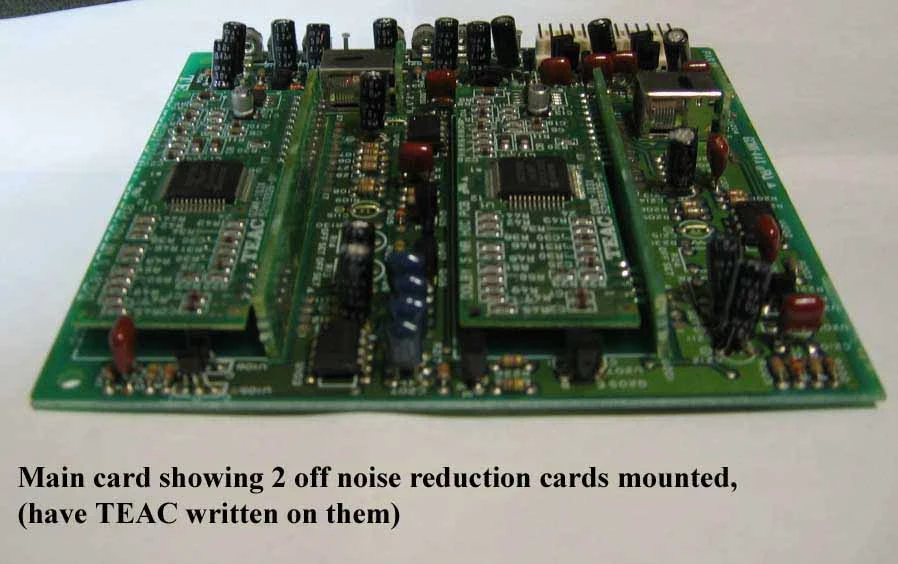

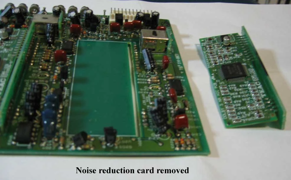

Hi,
What you will find is that on the MSR24S there are 12 cards in the back that pull out, one for each pair of channels, on each of these cards there are 2 Dolby noise reduction cards. It is the capacitors on the Dolby cards that need replacing. To get to some of the capacitors you need to unsolder the Dolby card from the main board.
I will have a look round in the next few days and see if I can find what values we used, I do know they where common parts that only took a few days to find. We did try only replacing the dud ones the first time we did a board, but the other capacitors went out of spec about 6 months later so replace all the caps on the noise reduction boards.
We originally thought there was an IC problem but replacing the caps did the trick. If the problem remains or a new problem appears, check the soldering around the tracking on the circuit board, one of the boards I had fixed did not work at all when it came back but I managed to fix it myself as there was a bit of solder across one of the tracks. This is very fiddly work.

More info if the photos load,

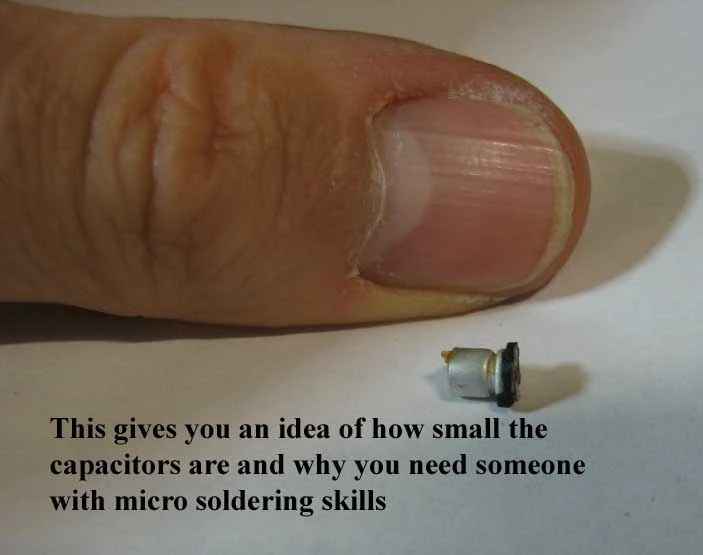

That's pretty impressive, alright!
Sweet, man. So those are the newer capacitors, right? Are the capacitors generic?
Hi,
The capacitors are off the shelf parts, in actual fact you will find that you can get capacitors with the correct values but with a better spec. Caps with a better spec will last longer and the manufacturing of the caps has also improved since the original boards where made.
Glad to see the photos where of interest, I try to help out where I can as I hate to see a great recorder out of action due to a few dollars worth of parts.
When you find a tech that can do the soldering, they will know where to get the parts from. Finding the tech is the hard part.
Cheers
Alan.

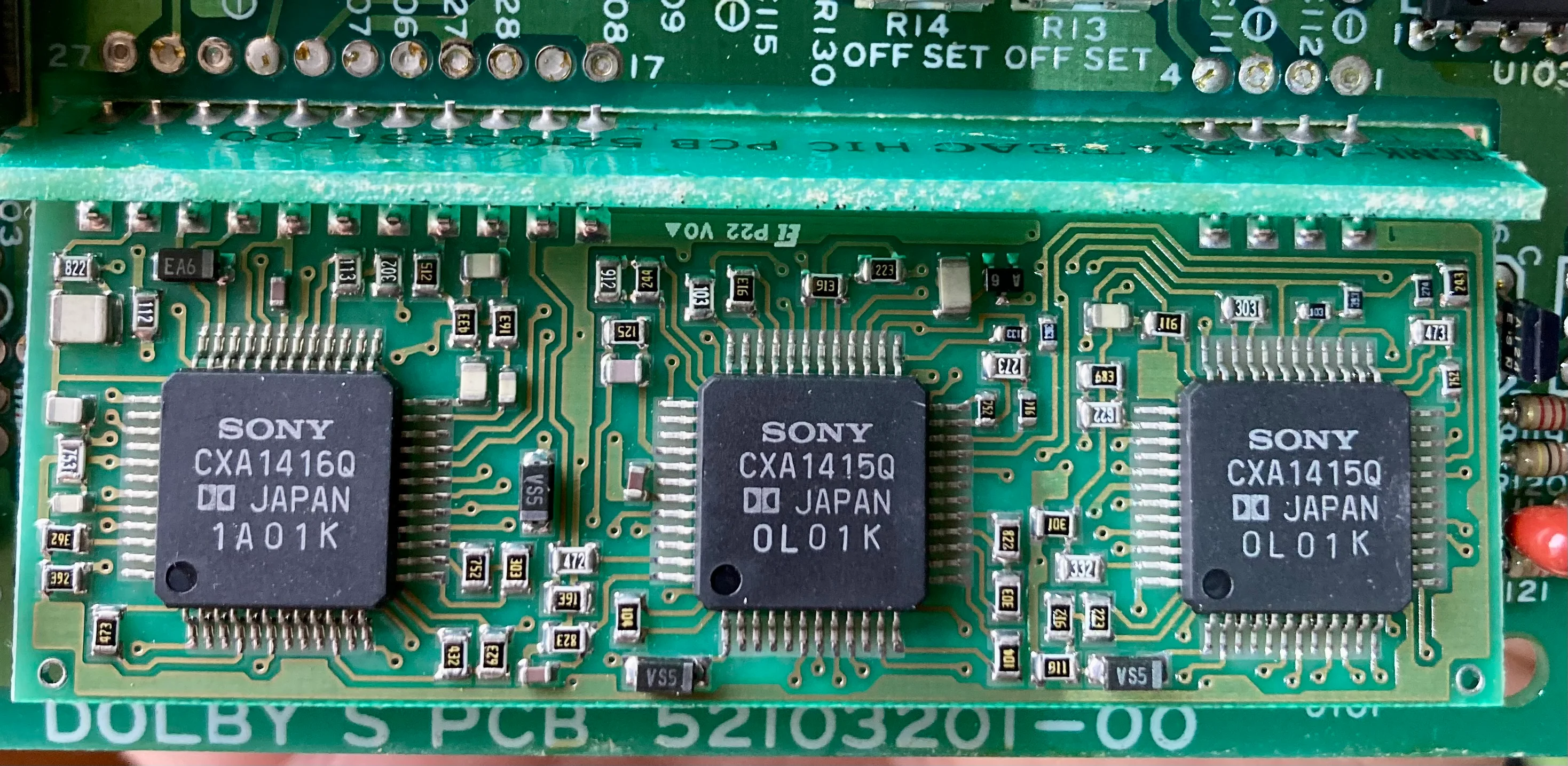

You know it wrong. The early versions of their Dolby cards had the leaking SMD capacitors, the later versions had a state of the art PCB that lacks these issues. And I have this version, actually two.

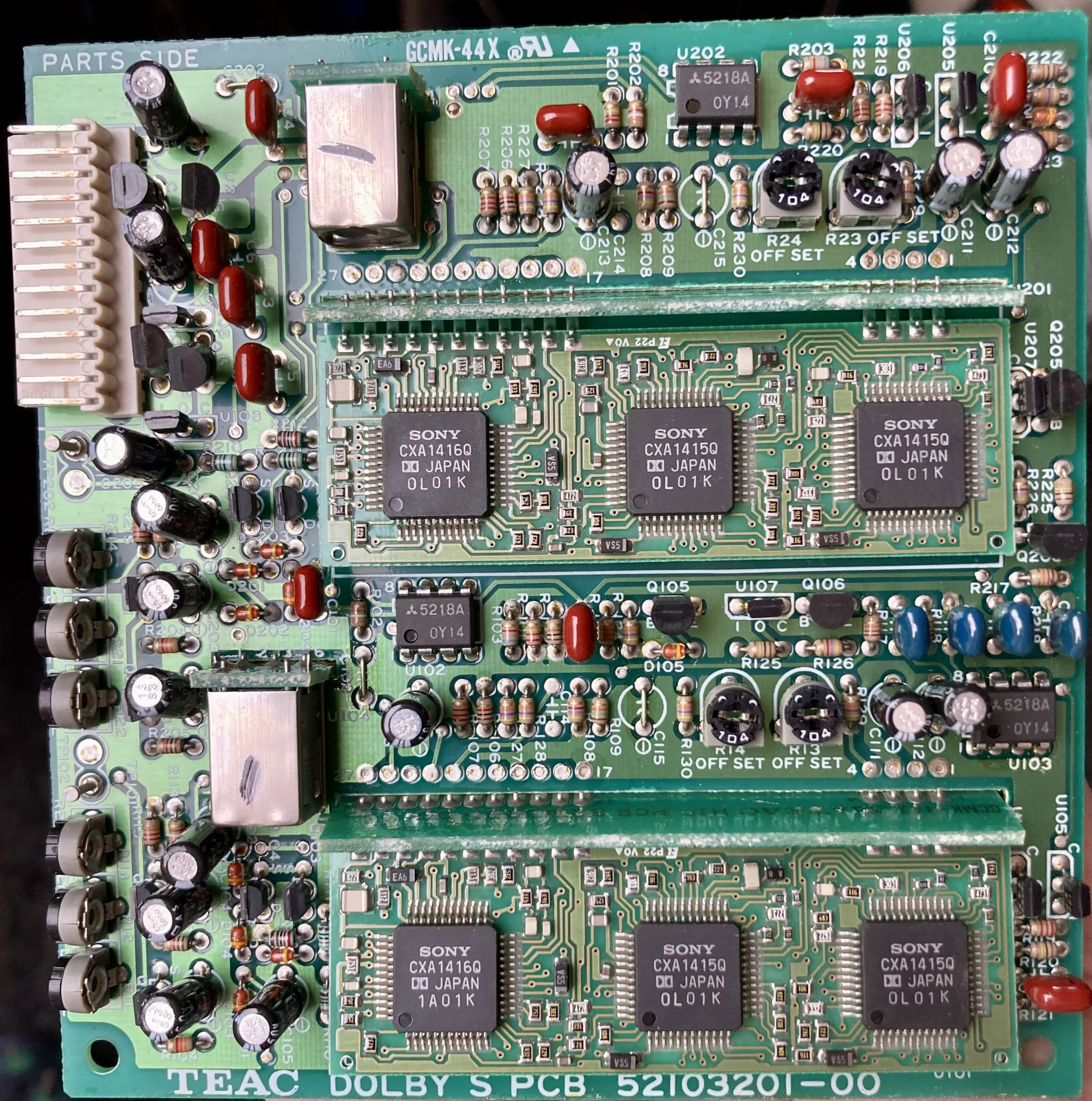

Can you post pics of your late version Dolby S daughterboards? That would be good to know and see.

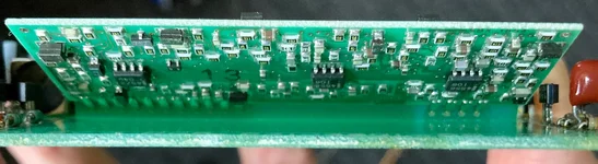

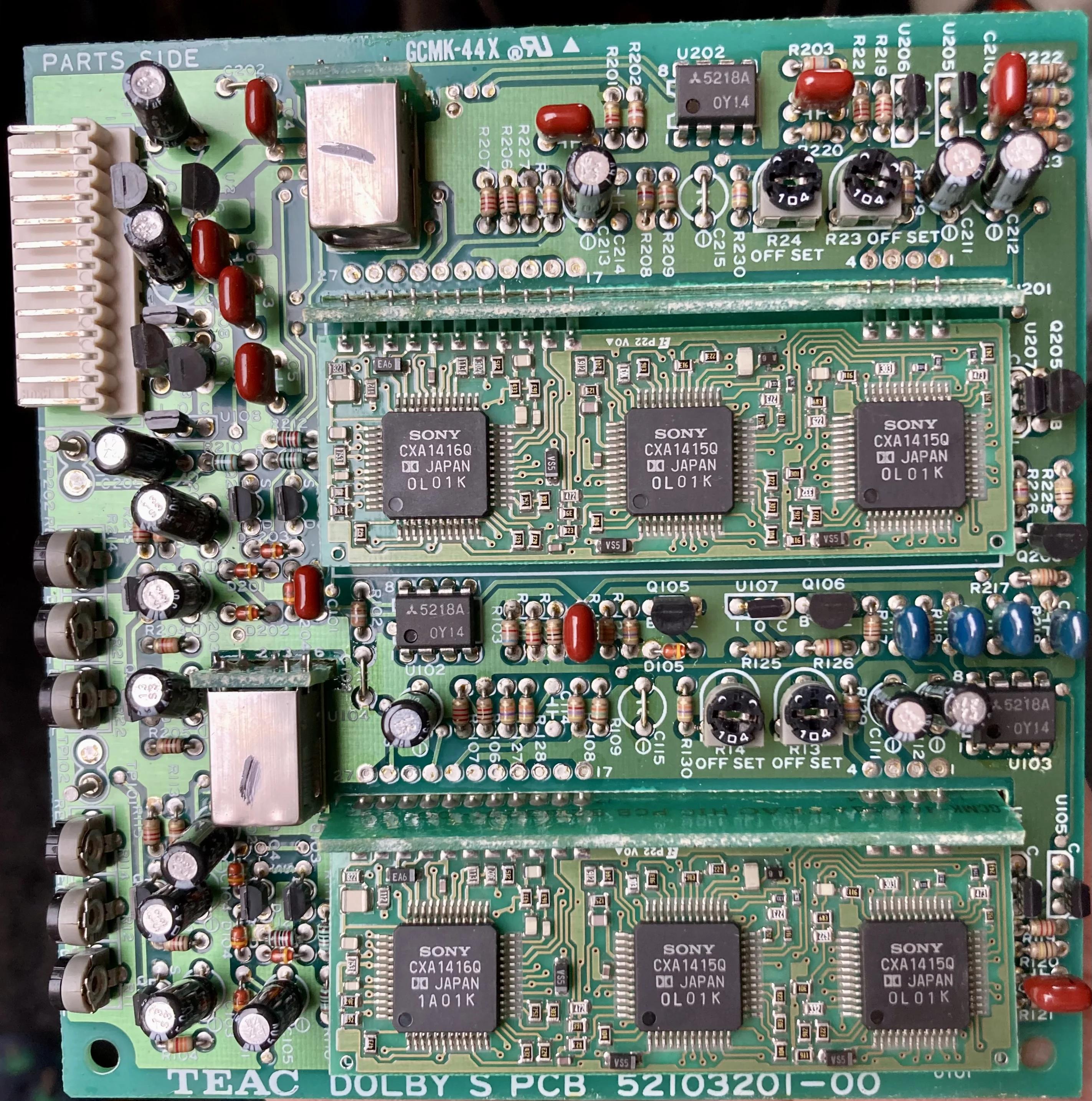

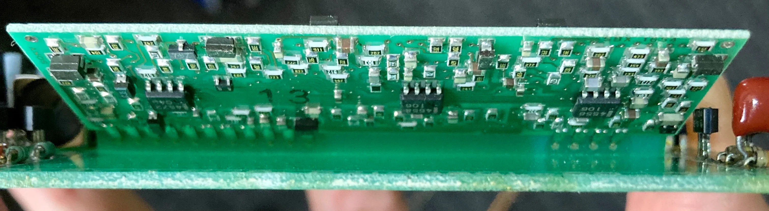

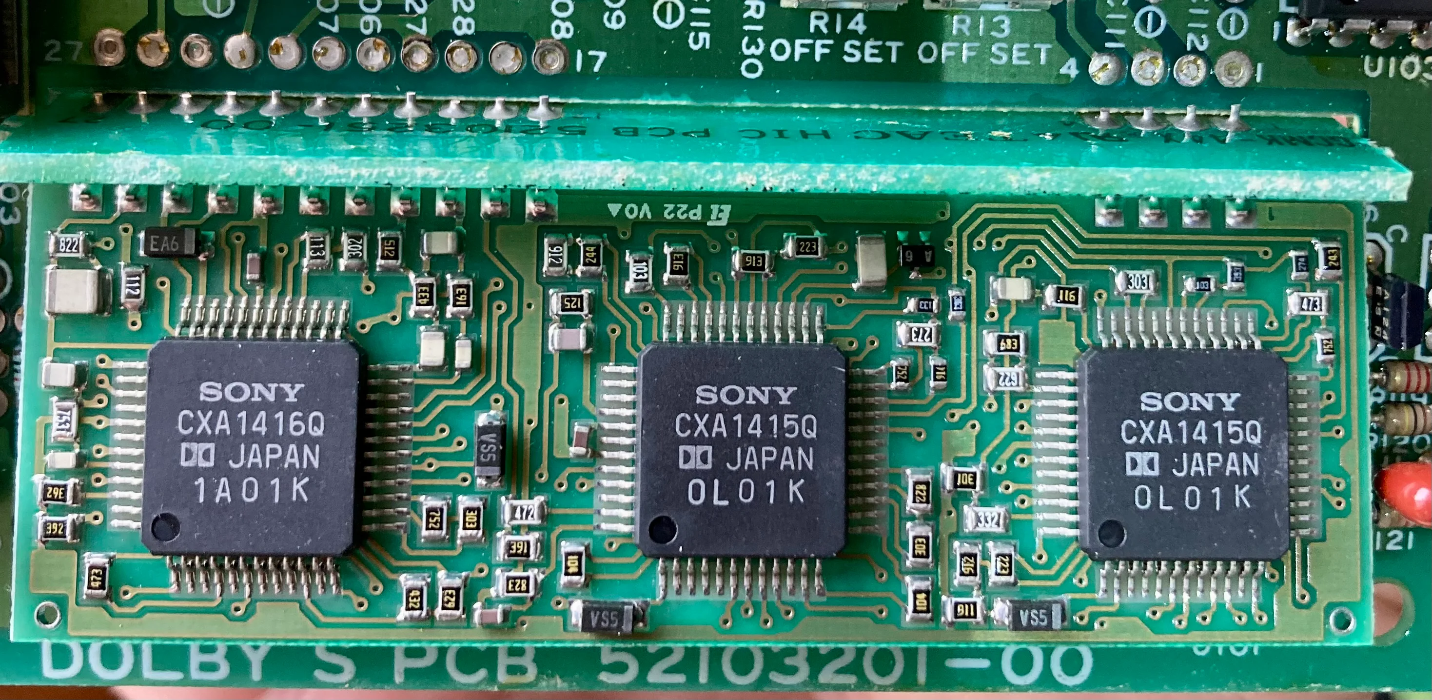

Those look very similar to the SBX1654 modules that were used in the Fostex G24S. There's a block diagram for those chips and a pin description in the G24S manual.
