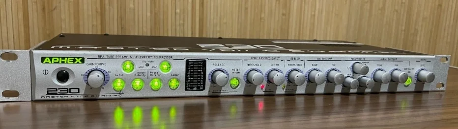

A good cheap preamp I found is Aphex 230 master channel can be had for like $150-200 has everything to get tone. 95% of them are broken on the floor of the Ocean. Look at this junk-
The FMR RNP is my other one to recommend .
