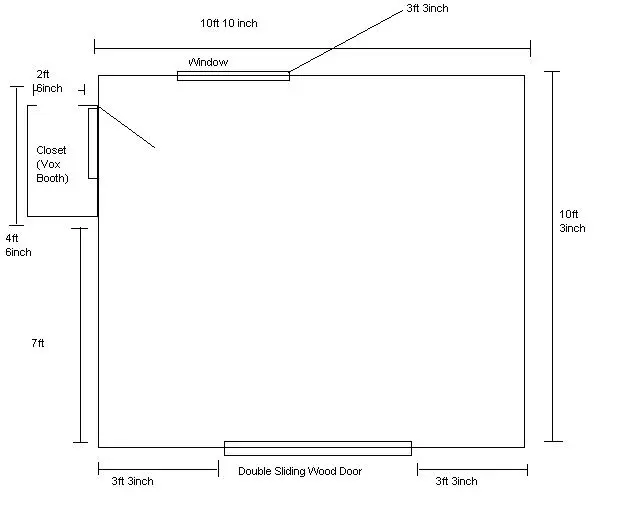

I have or will soon have the gear to get a decent multi tracked recording of a full band. I would love to have a nice isolation booth for vox/amps, a sweet sounding room for drums, and an acoustically perfect control room for recording, mixing, and mastering. But until that day comes, I have a 11x12 room with a 2 1/2 x 4 1/2 foot closet. The room has double sliding wood doors going in, and a window, both are approx. 3ft 3inch wide (I've attached drawing, please take a look!) Basically, I just need some ideas on how to make the most of what I have. The first drawing is the room with nothing in it, the second is with a couch, drum set, and cpu/daw desk that will be in the room, not sure if thats how it needs to be set up buts its just what I've been thinkin' about. Also as far as acoustics and recording, where do I need foam, bass traps, ect...? Do I need a GOBO or some kind of sound blockage from drums to the daw desk or should I use Extreme Iso headphones or another recommended brand? How can I get the best sound of my drums?Keep in mind my budget is somwhere around $500 or so for the room treatments needed. Thanks for reading this epic and thanks in advance for your help!!!

Ok, well heres my idea...Checker the room with 1ft x 1ft 3inch thick open cell foam, Put wall to wall 2 inch thick foam in the closet to use as a makeshift vocal booth ( Is 2 1/2 x 4 1/2 too small? Thats all I got to work with :( .) Then use a POD and a DI box to record scratch guitar and bass into my Firepod while tracking the drums, use Extreme Isolation headphones to get decent mic placement from the drums. Then record drums ( possibly make/build a GOBO to put in between me and the drums while tracking them), then bass, then guitars, then vocals. Sound like that should work? :confused:
