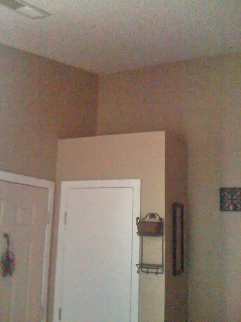

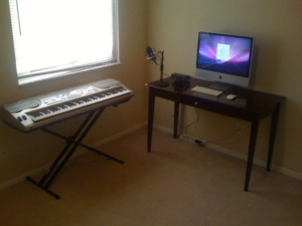

Some pics of the room... I'll add some more too. It's really EMPTY right now but I'm gonna get a few more pics of the other walls.
I'm thinking there is no need to separate any portion of the room for vocals after what you've told me. I'll move the vocalist to another portion of the room merely for sound. The mic will be on a boom obviously but right now I just have it sitting on the small stand.

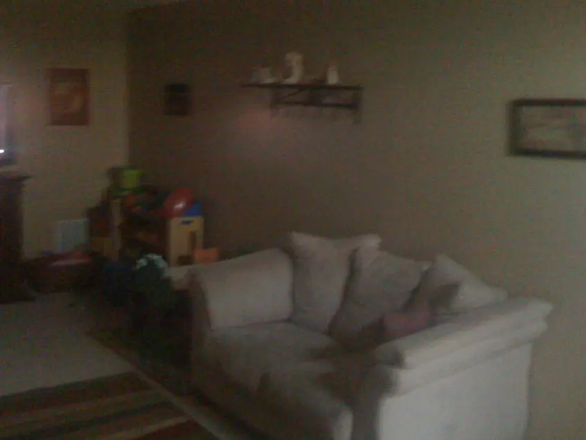

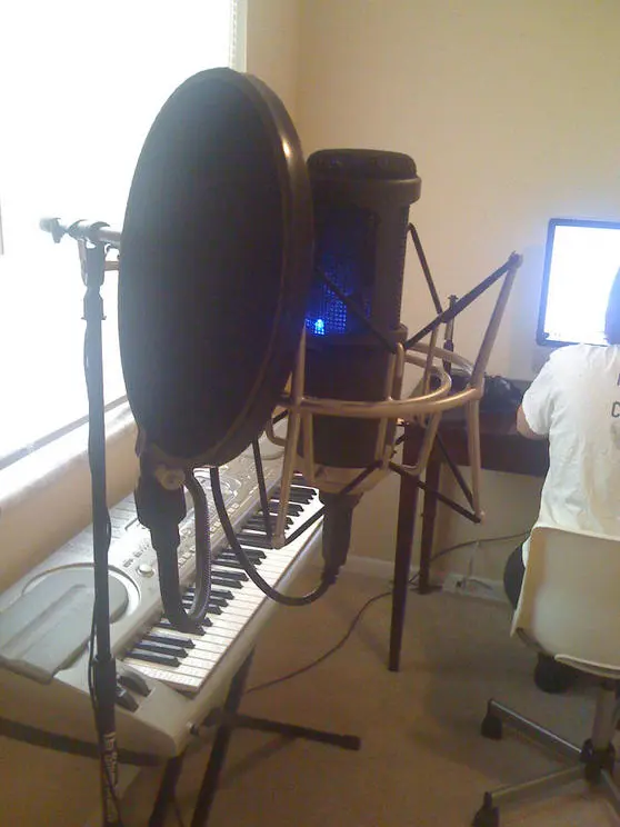

Hey again...
Wife did vocals in the small room without any treatment (as expected, sounds awful). So our trial / error begins. I figure I'll do small treatments and test it slowly to understand the changes it goes through to better understand treating the room.
Also, next test is in front corner of large room.

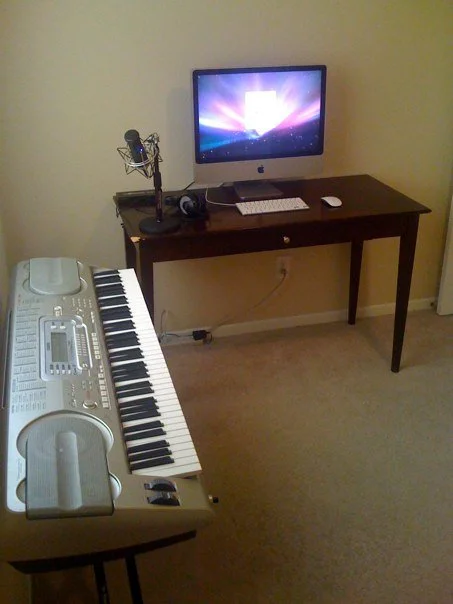

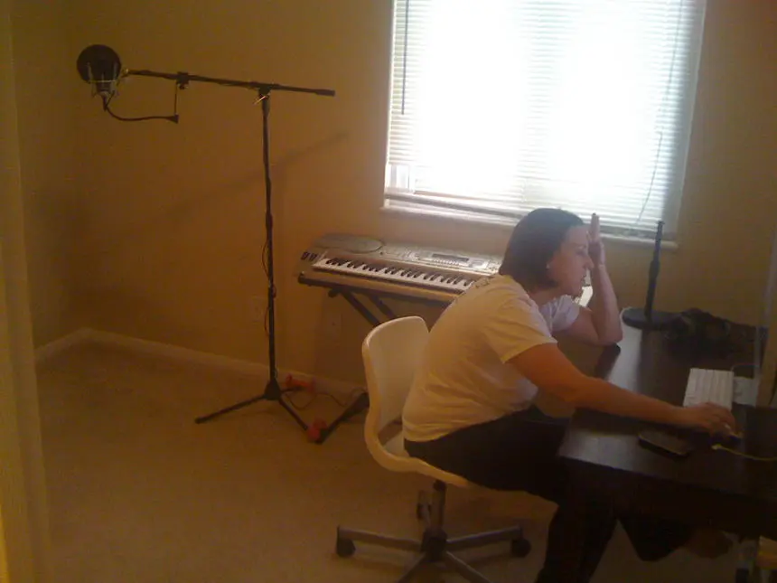

Attached are pictures of both my setup in the small room positioned in a corner pointing away from the corner to a doorway on the opposite side.

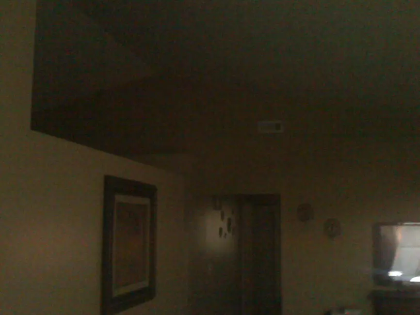

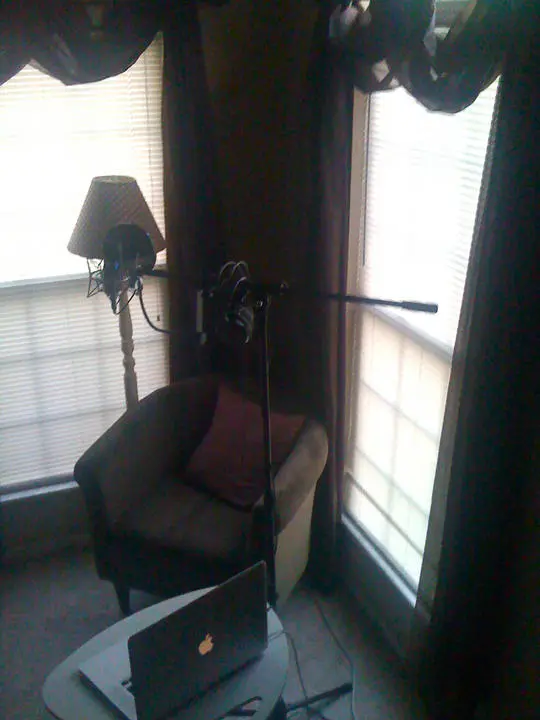

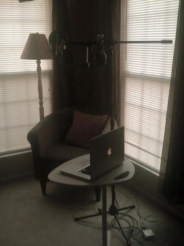

Also attached is pics in a corner of our family room which has vaulted ceilings and a lot more open space. Not even slightly sure of what type of treatment it would need nor do I think I would be willing to actually do treatment in my family room :D but here goes...
Sorry about the crappy pics, hopefully you can make sense of them.

Small room pics and mic position.
