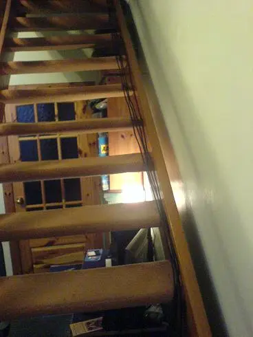

Why not run a long multicore all through the house, from the tracking room up to your bedroom? Only thing is, you'll need to have the doors open so the sound will just go up. But wires everywhere will annoy the fuck outa your rents until they agree to let you cut the hole, lol.
Run a snake cable through the wall, outside the house, to the room you want to record in, enclosed in conduit.
Then paint to match the color of the house. Do it while they're away on summer vacation, and they'll never notice it.

No probs. Just leave them there constantly with the excuse that you dont wanan have to keep running every time u wanna record, lol you should see all the cables running down the stairs to and from my bedroom, lol. Rents don't seem to mind though. Tis my space upstairs, they don't go up! lol Tis only 4-5 cables though.
