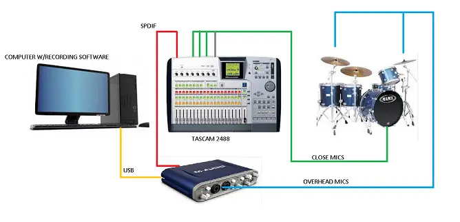

Here's how I do it. Close mics into a 2488 out to an MAudio via SPDIF. Overhead mics into the MAudio XLR. All that goes into the PC via USB.
This works but once the kit is recorded there is little to no flexibility with the mix. I have recorded the drums on the 2488 and transferred the waves but since I suck at drumming I never do that.

If you go the other road that you mentioned in your original post then Manslick has you covered with that image.
This is only really worth doing if you intend to use (and sum) more than two microphones as he's doing.
Unlike with discreet inputs, this setup relies on you getting your sound and balance right at the time. There's only so much you can fix in the DAW after, see?
