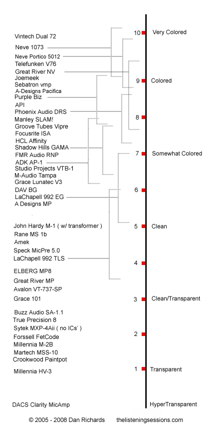

A mic preamp 'may' impart a particular sound to the mic you are using, sometimes referred to as 'coloration'. It may warm up the sound of a mic. You might like the coloration or not. If adding another stage of amplification/gain to a preamp in your interface, do a bit of searching on the subject of 'gain staging' to learn how best to set the gains of each preamp.

this was the video that confused me quite a bit......
That's because the diagram is totally wrong and you probably know more about the subject than whoever made the video. There's lots of rubbish spoken about mic preamps but there's nothing magic about them.
