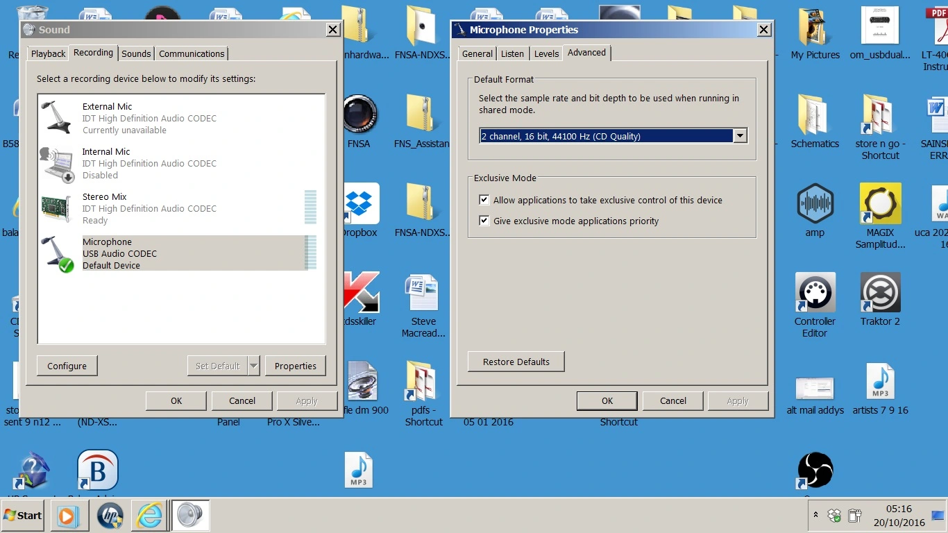

Hi Rich' you have almost certainly fallen foul of Windows Sounds setup system.
Get to the screen attached (btm right, by the clock) and work your way through the menus. You will come to a setting for "Level". Stick that at 50% and see how it goes.
You see that ttable is a "Class Compliant USB Device" and does not I bet have its own drivers so Windows take charge.
If you get sorted and you only have a few disc to dupe, download the 30day trial of MAGIX (was sony) Soundforge. Excellent vinyl clean up progg.

The settings where you very nicely provided screenshots are identical to what I had with the exception that it calls it "line" rather than "microphone" and that is the only option anyway.
